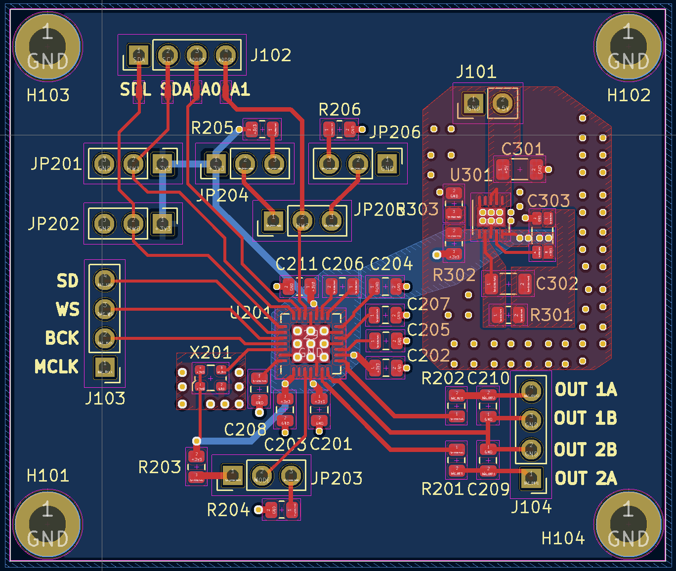

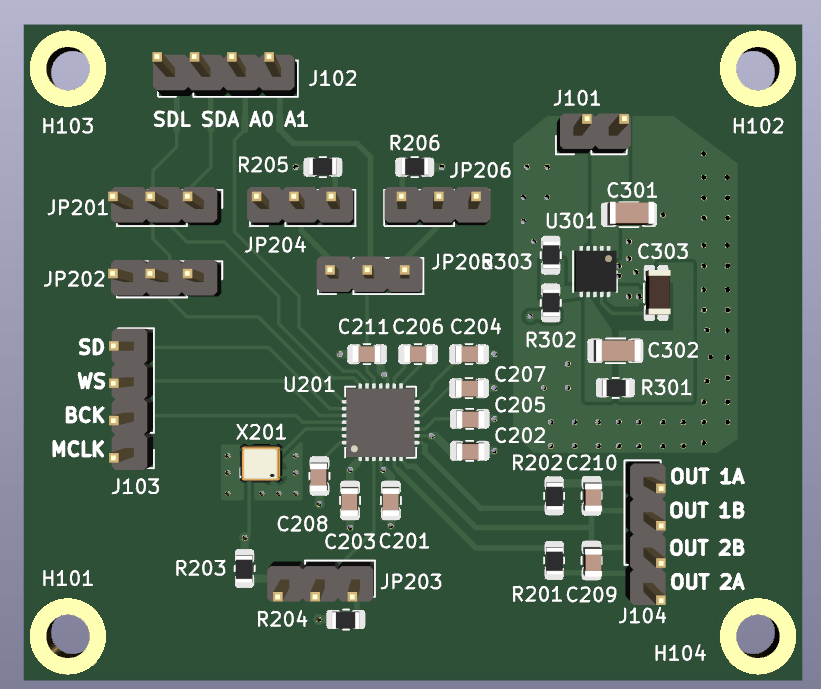

Small update on the PCB for the DAC IC.
I think I have layout and routing done now, the one thing I`m still struggling with is the clock. I use a fairly simple 4Pin tri-state ECS-2520 clock, due to availability, I will change it when moving to a more refined design, but the lack of options hinders prototyping.
What I don't understand is if I have to include caps for the load capacity near the crystal, I have seen oscillator networks using 2 caps according to the load-capacitance of the crystal on the in- and output. Is this needed in my case too where I only have a clock input and if so, how do I calculate it?
Should I include a series resistor at the clock-in?
Should I rout MCLK to a pin or is this a bad idea? I left the header pin unconnected for now.
More filtering at Vin before the LDO could be implemented too, should I do so?
I was able to rout all signals on the top layer of the board, therefore the stackup is now S - GND - GND - PWR, with the Bottom layer as a solid fill
All of the IOs are on headers

I would add a local decoupling cap (100nF) close to clock. Also a series termination resistor on output. The value of this can be tuned when testing. I would also route MCK to clock output and add a jumper for clock enable so that it can be disabled if external MCK is used.I think I have layout and routing done now, the one thing I`m still struggling with is the clock. I use a fairly simple 4Pin tri-state ECS-2520 clock, due to availability, I will change it when moving to a more refined design, but the lack of options hinders prototyping.
10uF X7R should be sufficient.More filtering at Vin before the LDO could be implemented too, should I do so?
If you are going to export your MCLK to a DSP board or somewhere you might want to add a clock buffer such as NB3L553-D, or at least use a single-logic inverter as a buffer.
Also, every I2S and MCLK signal connector should have one dedicated ground pin for each signal pin (since this is RF we are dealing with). Most commonly there are two rows of pins with one row being all grounds.
I2C also requires a ground pin. Same for analog outputs.
Mounting holes are most commonly not grounded.
Using 1uf caps for dac chip bypass is not usually a good idea. Bypass caps are usually in the range of .1uf to .01uf (since they need to have low impedance at RF).
Last thing, using LT3042 for what you have there is overkill. If you are going to use it, better study the advice in the datasheet very carefully or it will not come close to working the way its supposed to. IME it will probably be less noisy if you use a linear cap for Cset. In that case 47uf is too big. A linear 4.7uf or maybe 10uf cap would probably be what I would use. SMD film caps are available in those values.

I thought about that and will implement it. TYAlso, every I2S and MCLK signal connector should have one dedicated ground pin for each signal pin (since this is RF we are dealing with). Most commonly there are two rows of pins with one row being all grounds.
It was probably a typo, changed the value to 4u7In that case 47uf is too big.
I implemented the LT3042 as close as possible to the datasheet and ref design as I could, including the odd pad spitting of CoutLast thing, using LT3042 for what you have there is overkill. If you are going to use it, better study the advice in the datasheet very carefully or it will not come close to working the way its supposed to.

Good Idea!I would add a local decoupling cap (100nF) close to clock. Also a series termination resistor on output. The value of this can be tuned when testing. I would also route MCK to clock output and add a jumper for clock enable so that it can be disabled if external MCK is used.

Instead of using that LT3042 as you are, you could save some money and likely get better SQ by using a cheap 3-terminal SMD regulator for each load. The LT3042 could still be used in a helpful way if you want to drop the incoming voltage down to 5v. The 3-terminal regulators could drop that 5v down to 3.3v for each load. Its simple, cheap, and it would work better.

Your LT3042 implementation seems to be ok. I use tantalums as Cset. Higher Cset brings lower lf noise but no need to go higher than 22uF. No need for film caps.I implemented the LT3042 as close as possible to the datasheet and ref design as I could, including the odd pad spitting of Cout

Instead of single LT3042 you could use multiple e.g. NCP163 or LP5907 as Markw4 suggested but as pre-regulator no need to use anything better than LM317 or 7805. If you already have LT3042s I see no reason to change your latest design for first iteration.
Each load will create noise that interacts with the other loads. The noise will also propagate back towards the LT3042. Some of the noise transients will be attenuated by the LT3042 output cap. IIRC from the datasheet using a larger output cap can improve transient response, but at the expense of lowering LT3042 regulation bandwidth. For noise that is not attenuated by the output cap, LT3042 error amplifier will attempt to cause LT3042 output transistor to turn either more on, or else more off. When it turns on harder it can raise the output voltage by drawing current from the input cap. The first thing that will happen in that case is that the output cap will start to charge back up. If needed, to lower the output voltage LT3042 will just have to wait for the loads to absorb the voltage since LT3042 is a single quadrant regulator. It has no direct way of turning down the output voltage. As result of all the above, you will probably be better off with separate regulators for each load. If you want to keep the LT3042 for some reason you could still do that too, even if some people might laugh. They might laugh at what you are doing already for that matter.
