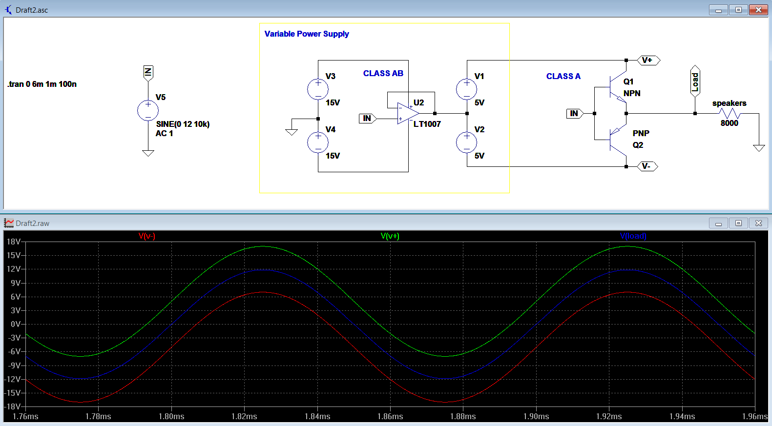

Well, i am confused, U2 is connected to V1, V2.
u2, v1, v2 forms a variable power supply for u1( class a)
v1 and v2 are floating power supplys, you can imagine that they are batteries.
it is possible to use ess9012. there is no problem.

No Joachim is not current dumper .
Is a amplifier in class A that has a floating power supply , and a amplifier in class AB that the only function is keep the midle of the power supply of class A amplifier equal to input signal, Both amplifiers have unitary voltage gain.
maybe this picture is more clear.
Hi, Sergio,
This is an interesting concept. However, I'm not seeing any return path in that simplified diagram for signal current which must pass through the load. While the high current 1.8V supplies (V1 and V2) are floating, the load is grounded at one end. It seems that there is no return path for load current back to the high current 1.8V floating supplies. Snce this is apparently adapted from a text book, I'll assume I have missed something.
The current for the load comes from the fixed power supply V3, V4 that are grounded , then it passes by the class ab amplifier then V1, V2 and next the output transistors and then it returns to ground by the load.
Another image , can you see it now?
Okay, so, the load current conducts through both V1 and V3 for the signal positive half cycle, and V2 and V4 for the signal negative half cycle. While V3 and V4 have the maximum supply voltage across them, they only supply significant current as the signal requires it, but not for the class-A bias current. Meanwhile, V1 and V2 supply the heavy class-A bias current to the output stage, but have only the minimum supply voltage across them. Do I have this correct?
Yes Ken , is correct.

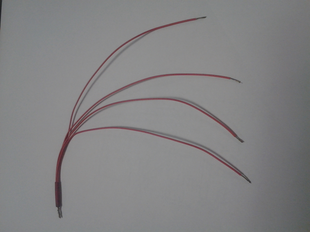

no problem, look forward to it. I suppose all efforts would need to be made to keep traces/wires the same length to avoid smearing?
The important is that all wires go to a common point, at this current level the length of the cables is not that important , but it is not dificult to make them the same size.
Only need some wires connected like this , is not a big deal.

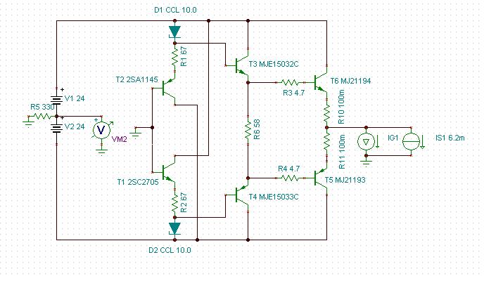

Here's something silly I came up with today. THD at full tilt of 7mA is something like 1 x 10^-5 give or take. The thing is, if the quiescent current in the output stage is 10 times or more than the silly -6.2mA of bias, then the fact that the output stage is knocked off balance doesn't matter that much for THD. Obviously, it performs even better with no DC offset current.
You could bootstrap the collectors of the input transistors to the emitters of T3, T4.
I realize that is a normal technique, but my simulations show that it does not reduce distortion or anything good at all. I don't see the point of doing it. That's why I tie them to the rails instead. I do what makes sense to me.
