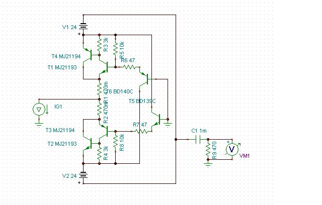

but, to further the progress of technology and the conquest of nature in all her glory, here is a little something I cooked up in simland. I don't claim nuttin' good about it. Sim'd THD is 6x10^-5% for 6mA input. Just something for the bong.

can we simple mortals, have a glance at your art, please enlighten us with your divine knowledge. :worship:
Divine knowledge - too funny 😀 😀
Just use common sense.
Only use large geometry / high current bjts where they are absolutely
necessary - this will be in very few places if you think it through.
Sometimes you will be better off paralleling 2 x slightly smaller devices of
moderate current (337).
Where there is large voltage swing look for super low Cob / linear beta
devices. Sanyo have a very good range. Also 2SA1360/SC3423 are very
good for the 'helpers' that swing in voltage.
If you are going to do an IV for Sabre in mono mode where Z out = 98 ohms
at 16mA swing this will really require some fine tuning of current versus BJT
type etc. It will push an open loop design to the max - especially if you
do it without the CFP pairs.
I suppose I've played that tape before :spin:__:spin:
cheers

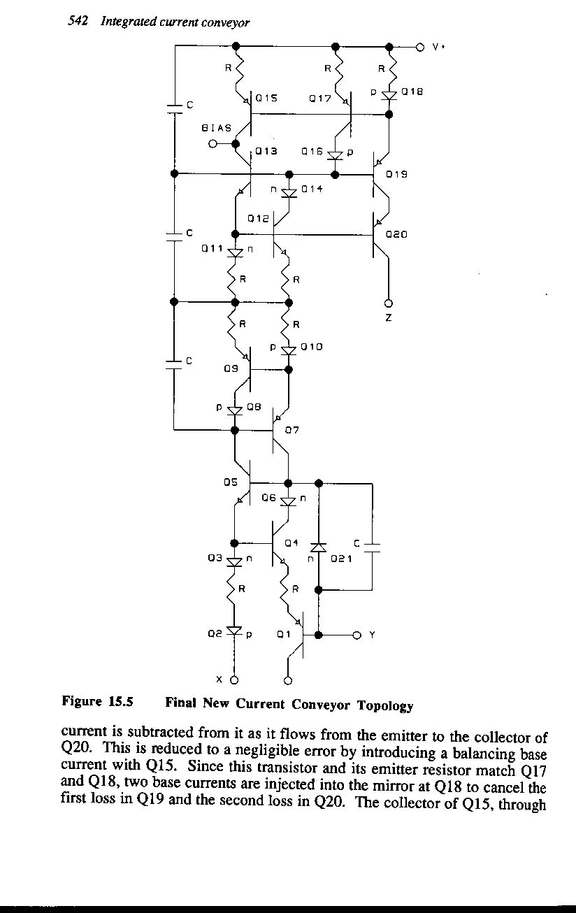

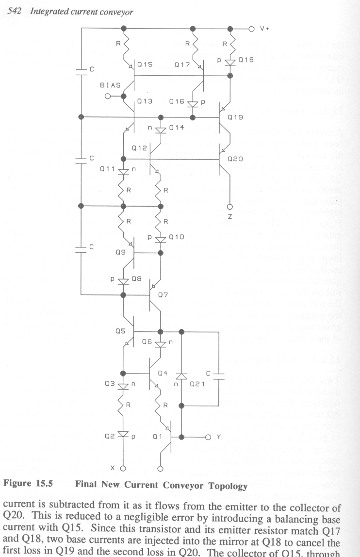

I found this post,george
http://www.diyaudio.com/forums/digital-source/35176-wadia-swift-current.html#post407456
Correct. The PA630 (and the '630A, which has connections for dditional FET drain followers at the output) was taken off the market a couple of years ago after the designer sold the rights and his remaining chips to Wadia. There have been at least two publications in EW/WW, plus several in the trade press. There is also a full chapter describing these chips in the book "Analog IC design, the current mode approach".
If you need info like internal schematics etc, drop me an email.
Jan Didden

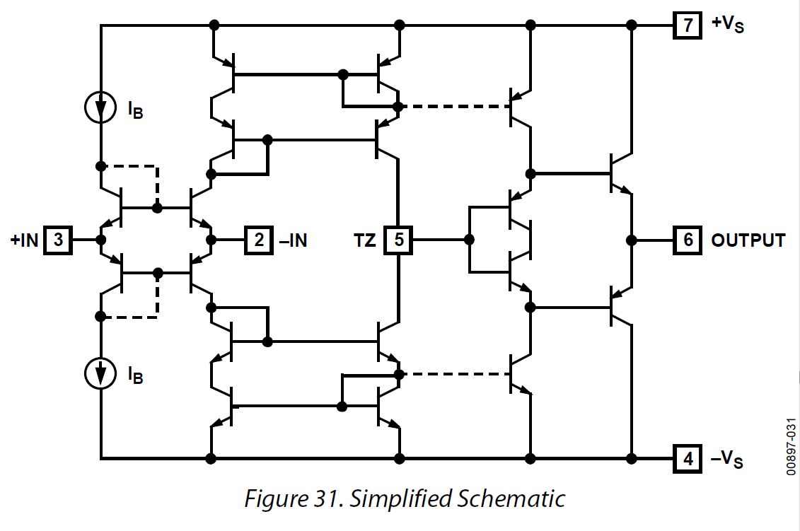

BTW I have had very good results with the AD844, another CCII with buffer. In contrast to the PA630 it is a balanced circuit instead of single ended, although that only manifests itself in somewhat better DC characteristics.
I've used the AD844 in CCII role (open loop) in power amp feedback/error correction circuits with excellent results.
jan

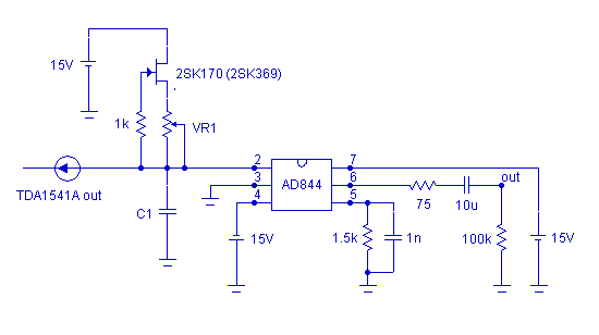

Funny you should bring up the AD844 Jan.
I found this circuit of Pedja Rodic's (attached) and used it as is (NO FEEDBACK) and it worked a treat, best opamp based I/V so far by a long way, it blew the OPA627 completely away I though it would never be beaten except for a discrete I/V of some sort. (And I’ve tried just about every opamp out there)
I used it without feedback as per the diagram and was very very happy. Used with TZ as he has it 1.5K with 1000pf to ground, I think this gives a 1st order rolloff –3db @100khz.
Does the 1.5k resistor have a bearing on what input resistance the dac (PCM1704 in my case) sees?
Because I changed the resistor for 2.2k to get some more gain but this time with a 260pf cap –3db @ 270khz (still all nice and stable with a bit more gain) still very very good.
But I had the feeling it was puchier and more dynamic with the 1.5k resistor even though I had less gain. I feel that the input loading for the PCM1704 is better with the 1.5k than the 2.2k resistor or am I imagining things?.
Cheers and thanks for your input George

again, how is that No Feedback? conveniently thinking of local and internal mechanisms as something other than feedback does not make it so. transistors inherently have feedback, it cannot be switched off no matter how you arrange them.
QSP, FYI - and you -should- know this by now:
zero FB = no global or inter-stage FB. Usually means no local FB but in the
case of the Wadia CCT and this threads I-V there are small amounts of + FB.
Get used to it, that's the terminology that has evolved and we don't need
another 100 posts discussing the fact that an EF has 100% FB etc etc.
We -all- know what you are talking about, it's just an accepted terminology,
right or wrong.
OK, no global feedback.
Whatever it's got it's got magic like there's no rev limiter, and I have no idea what the distortion is but it sounds distortionless, it presents my cd's in a totaly different way than I've ever heard them.
I would love to know what the input impedance is configured this way, but I suppose only Mr Gilbert the designer for ADI would know has he only knows the whole circuit.
All other opamps for I/V sound a little different tonally to each other, but this AD844 "with no global feeback" has made my whole cd collection a new listening experience.
Cheers George
