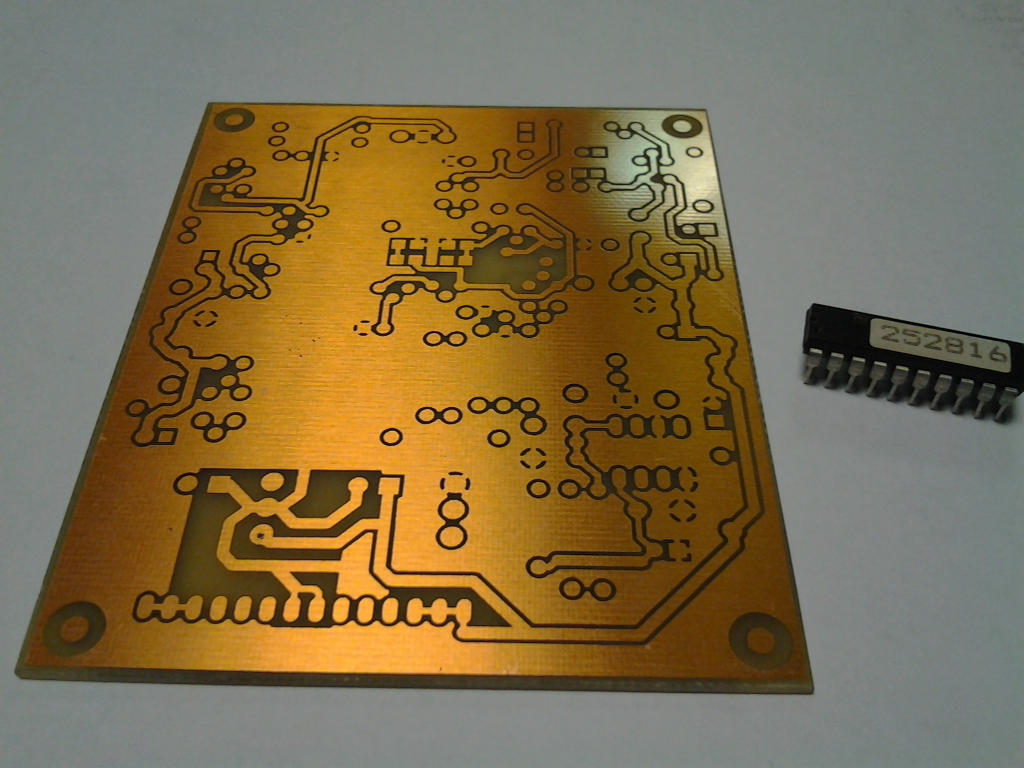

Monday i made some home made board for testing, to be sure that every thing is ok before i send gerber files for production. I have already drill them but i stil need to buy components. Last week was a bit complicated and things advanced more slowly than i wish , but thats live.

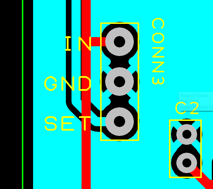

To increase flexibility and compatibility with more dac chips, I have included a reference voltage input , for use with dacs that need a offset voltage at the input, like ess9018 , ess9012. The new input is the one named "SET".

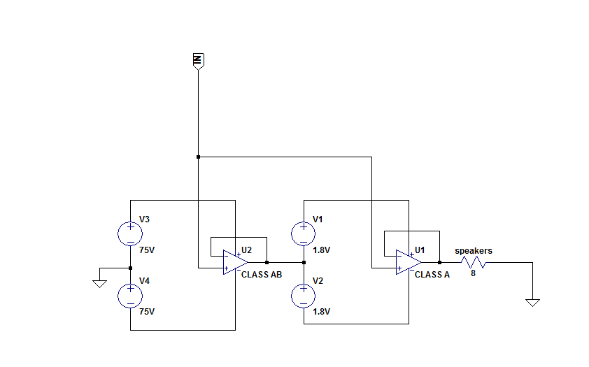

I have been away from audio from some years, and it seems that HD audio at 24bits is getting mature now. I have listening to some records at 24b/96K and i think it is a big step from cd 16bit quality. So i have to build an amplifier to get the best out of the increase resolution. I have some ecological concerns about pure class a amplifiers, i am thinking about using this very good idea from Matsushita
http://www.gtkc.net/files/class-a+.PDF
This was invented in the 70´s , nowadays we have much better components and i think it can be made a good amplifier based on this, i have already found some mosfet for the output. The output mosfets will have a current bias of 10 ampers and 1,8 volts each.
I also think that having feedback in the voltage stage is not a problem, but i will make the output current amplifier separate from the voltage amplifier , it will be like a giant buffer 🙂. So i can experiment with different designs in the voltage amplifier.
Interesting concept, a kind of current dumper. I have a recent QUAD amp that works quite well. The only thing i do not like is that it has quite drastic bandwidth limiting over 20kHz.
I tried to open the case to do some modification but so far i could not get inside.
No Joachim is not current dumper .
Is a amplifier in class A that has a floating power supply , and a amplifier in class AB that the only function is keep the midle of the power supply of class A amplifier equal to input signal, Both amplifiers have unitary voltage gain.
maybe this picture is more clear.
this type of circuit permits that the output stage works on class a but with low dissipation as the voltage across the output mosfet or transistors are very low. Ofcourse one has to be carefull with the class ab stage also, i have made some simulations and it seems to work very good.
