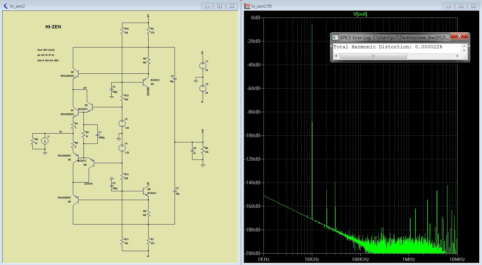

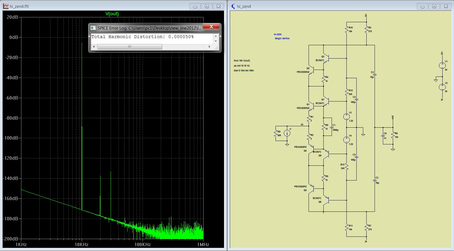

dac I/V convertion with very low distortion

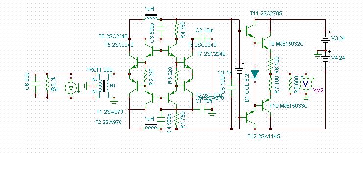

the CEN baxandall super pair.

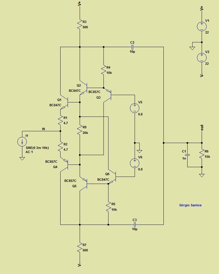

this is only a test circuit, just to give you an idea, not a final circuit.

This BISS transistors are really special. Not much voltage they can stand but a lot of current !
I would still try one of your circuits an an input stage for a phono. I could not stabilize the first circuit i made. What do you recommend i could try ?
I think you should try snubbers, there are some examples in some of the circuits i post. try the nodes that i call UP and DOWN, or at the input, but it help if you post a circuit.
