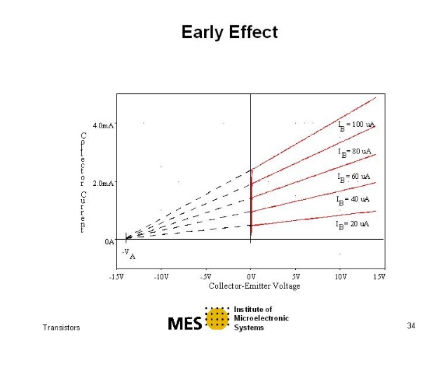

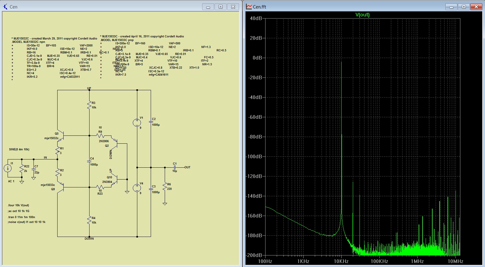

The weakness of the CEN topology is the distortion cause by the early effect ( the zout of the input transistor is not constante), one way to improve this aspect, is to use a more powerfull transistor like the MJE15032/33. There are others good ones like the biss transistors from nxp.
In this circuit below we have 0.000086% at 8ma pp, the circuit consumes 25ma from the batteries.
This uses Bob Cordell models so i expect to be acurate.

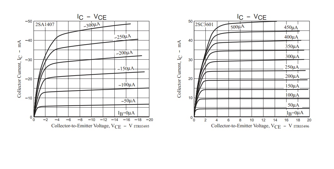

2sc3324/a1312 are good for low current applications. But for 10ma to 20ma a better choice is the 2sa1162/2sc2712 as the early effect is weaker at this currents.
The BC327/227 is also much worse than 2sa1162/2712.
One good transistor is also the 2sc3601 but the complementary 2sa1407 is not so good.
In my topology the early effect is not very important but in CEN is very important.

For everybody understand what is all this talk about the early effect, i post a picture of the Ic-Vce of the par 2sa1407/c3601. As you can see wen the Vce varies there is less variation of Ic in the c3601 than in 2sa1407.
As they say, a picture is worth a thousand words 🙂.

smms: the simple circuit of #301 shows a quite high input impedance of ~12Ohms because of low hfe and increasing values at too low frequencies (due to the 1m-Cap C4). C4 needs to be as small as 1nF or less to keep Zin constant and low into the MHzs.

Hi Calvin nice to see you.
I have measure 3.8 ohms at 10khz and 12 at 1Mzh , the problem is the parasitic capacitances and low Ft of the MJE15033/32 , one way or another this bjt´s is not a good choice for this circuit i just use it because i already have the models from cordell,
I think the Biss transistors from NXP are much better (high hfe, low capacitances and high Ft)
I don´t see the influence of c4, but i will investigate.

Are you talking about Early Voltage?[...]
If yes, comparing the datasheets is difficult, but at 300mA the BC337-40 looks better than 2SC2712 at say 100mA
