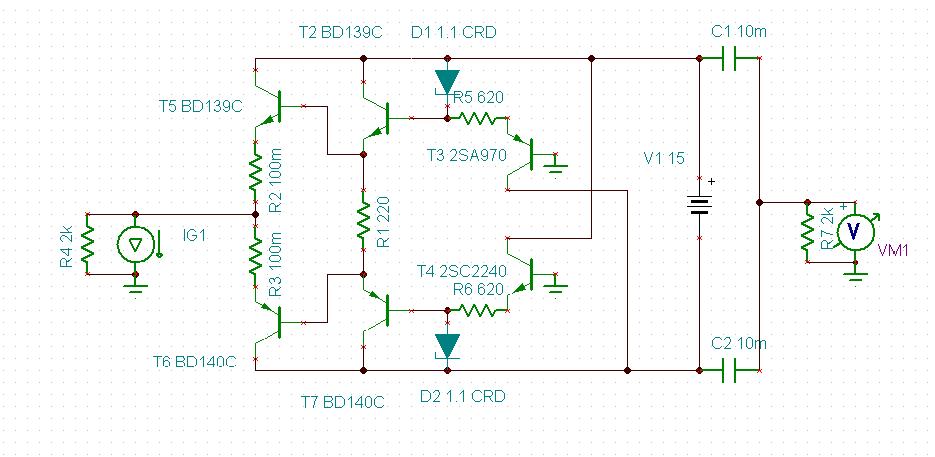

Yes Joachim its a diamond buffer, the circuit can achieve very low distortion, because don´t have voltage variations, in that way we get rid of distortion cause by Cob variations and BJT Zout, and of course the base currents.
This circuit just work as a all. If you want the low distortion that this is capable you have to use it like that.
Did someone call for a bigger hammer? 🙂
When you have no loop feedback and want to work in Class A, you have to juice it up a lot! Heatsinks on the first BD139/140 pair are required!
With 1.41 Vrms output, THD is 0.00038%. S/N is 130dB.

> The dac output 7.8ma pp but the quiescent current of the opa1641 is only 1.8ma.
If you use PCM1704, then Iout is 1.2mA, and I am still in Class A with the OPA1641.
For a DAC with 8mA Iout, you can use 5x OPA1641 in parallel, the brutal way. 🙂
> But as the dac has a -6.2ma offset current, maybe the opa1641 will be in class A.
That will solve it, using the offset current to bias the OPA.
> one way or another you will have a close feedback loop, so maybe is better to use a classical i/v (no need for battery).
Or use a passive IV (someone suggested 0.8R at the other thread) and amplify the signal 100x ??
