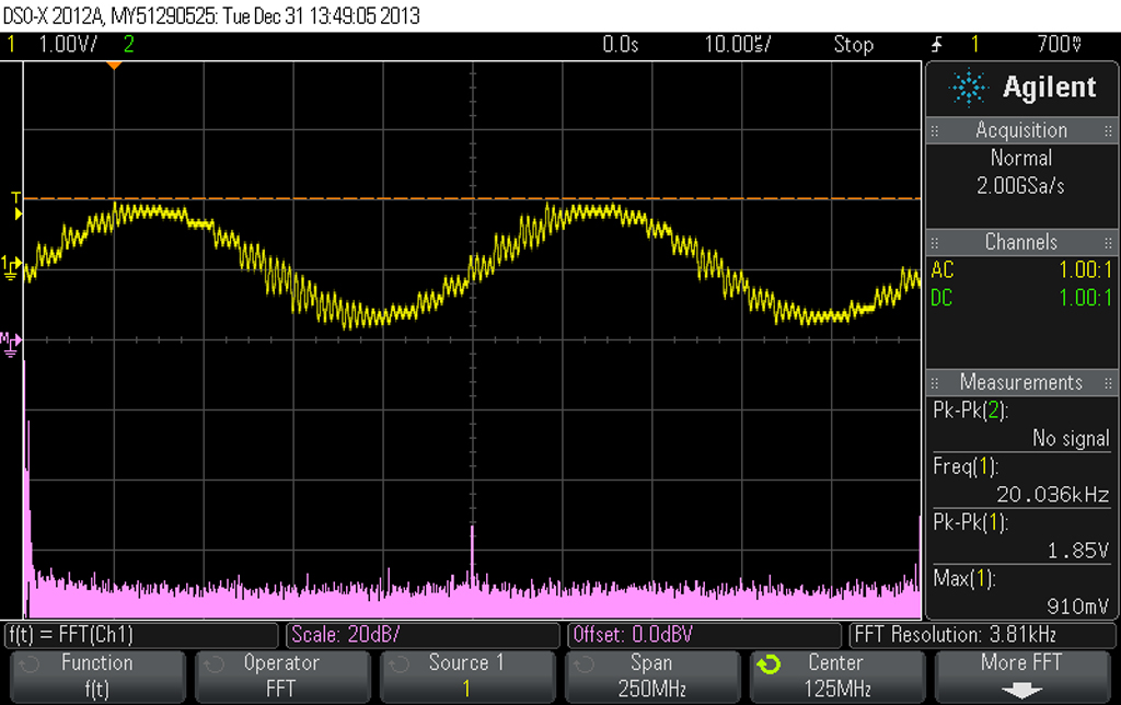

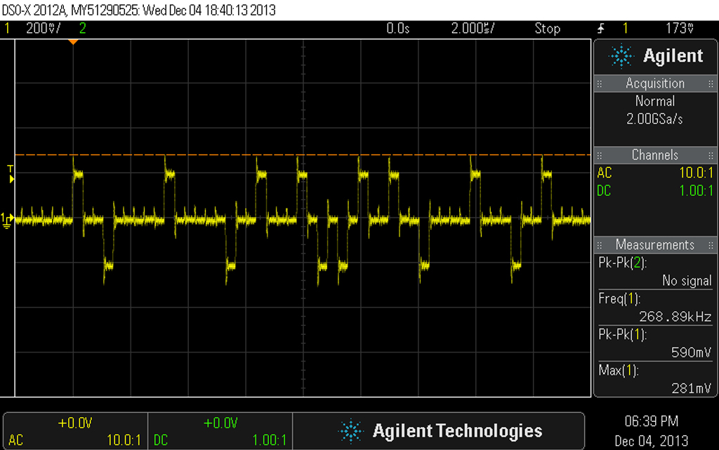

some comments on the scope traces posted earlier :
1) http://www.diyaudio.com/forums/atta...ods-using-working-configuration-cap-value.jpg
Is the right trace measured at the DAC output or at the opamp IV output ?
2) http://www.diyaudio.com/forums/atta...dac-processing-circuits-optimized-largest.jpg
Same question.
Could you zoom in ? I'd be very interested in the edge rate (V/µs) of these transitions. Something like 10ns/div should produce interesting results.
Also, lots of overshoot, noise, and clock feedthrough here, is it the circuit, the layout, or the probing ?
3) http://www.diyaudio.com/forums/atta...al-level-worse-case-scenario-degraded-aud.jpg
In this trace the opamp is probably oscillating (quite badly...) from capacitance overdose at the input.
