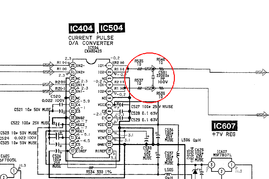

See below. This is the "current" DAC output of a Sony CDP-XA5ES (I used to own one) and note the post DAC filter.
R535 10R - does not, maybe there for parasitic reasons
R537 10R Ditto
C531 2200pF (22n) filter cap
R540 10R - defines the R of the RC filter - because it works into a theoretical zero Z (Virtual Earth).
R539 - Same as R540
Note, if this was a "voltage" DAC, the roles of the resistors are reversed. The Low Z point of the circuit would now shift to the output of the DAC itself and R540 and R539 would no longer be needed.
You must define the Low Z point of the circuit.
All this was covered earlier. Only here we have an actual example from a commercial model - nobody is making any outrageous claims about something that has been done before. That misses the point.
The filter above is flat to 20KHz.
Increase the cap value to approx 0.33uF (we are talking about a value fifteen times larger. It will be significantly down at 20KHz.

Sorry, but i have to leaf a little bit, thinking at what it may say now the bitter critics of this filtering technique. Specially they who meant such filtering it will never work, leads to ringing in audio signal, etc...
How we can easy see (thanks Joe for the picture in post 202), this filtering technique it were used before in a consumer device. It looks to me like is no any invention of today at all (but it were invented at its time of course...), and it was well known by few clever designers out there.
Joe still have his merit for find it out and making known to us about.
Now we have the prove that such filtering it works very well (as some of us have already experienced), many of us it were unknown with, and is to be used from now on of those who will want to implement it.

That's not a very accurate boast. In the example you reference, that Joe provided, there's a both isolation resistance and a much smaller capacitor value. There's no huge honkin' capacitor thrown directly across the output of a DAC or input of an op-amp. What's shown there will not ring. It probably won't ring even with the huge capacitor Joe suggests.
Again, you're comparing apples to oranges when you don't actually know enough to make such boasts. You're actually doing Joe a disservice every time you post. Regardless of what I (and others) may think of the validity of his "discovery," at least he knows how it works. You don't.
