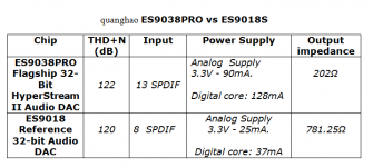

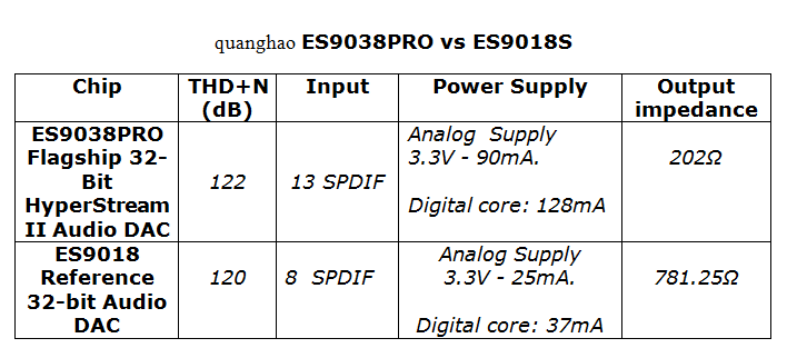

Hi quanghao.
Is´t possible to use your dac in doble mono configuration?
I don´t have problem to modify arduino code to support two chips if you provide me the code.
Regards
ES9038pro no need to use two chips because:
1. 9038 is very expensive.
2. ES9038 current = 3 times 9018 current
please see image 9038 vs 9018.
thanks

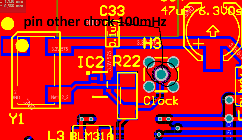

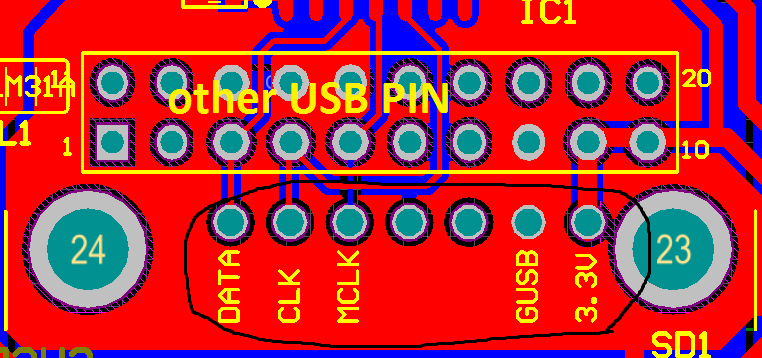

Hello, a pair of questions:
1) Can i use another USB transport with I2S output instead of Amanero, like Jlsounds' I2SoverUSB?
you can use other USB with pin connect: see image
2) Can i use a Raspberry PI with I2S output as player source (possible issues due to oscillator frequency communication)? ES9018 Buffalo III boards allow that.
yes, you can other clock with pin connect, see image
thanks
