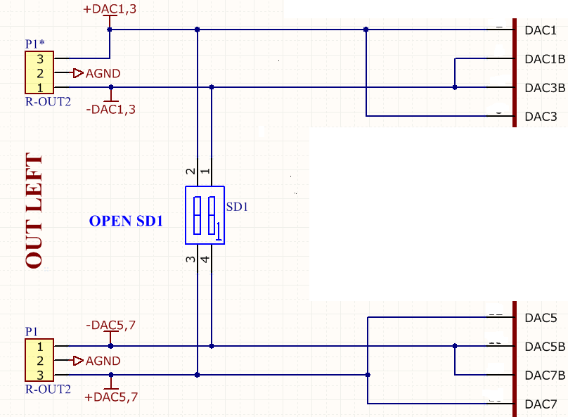

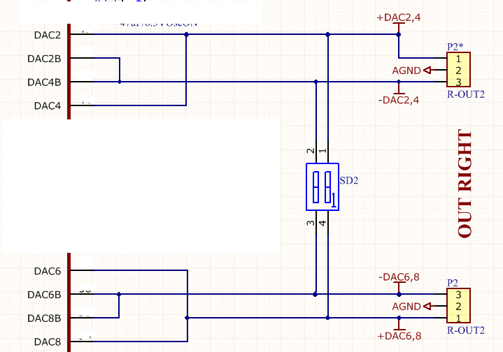

DAC output to 8 to 2, or 8 to 1. parallel
not 2 channels or 4 channels.
to the 4 or 8 channels, the usb also have to re-code and DAC also have to change much.
