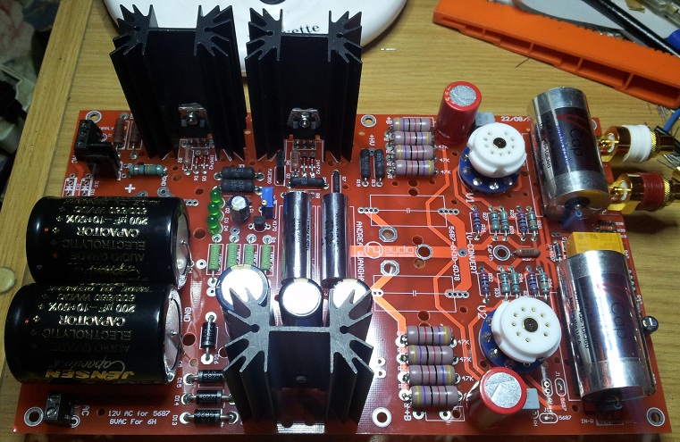

Hi Quanghao, I have a problem with the power stage circuit in the 260V SSHV specifically, since there is only the 61V output.
I have attached some pictures where you can see the component values that have been used and the voltages obtained.
Thanks.

Hi Quanghao,
I changed the IRF9610 and the 3 LEDs with a new one.
I measured the voltage on R1 33ohm = 18V.
I have two PCB mounted and the problem is the same in both.
Only 82 V at the output.
What is the correct value to R12 and R4? in Scheme R12 = 270K (1W) R4 = 120K (2W). R12 on the PCB is R8 = 220K (1W) R4 = 180K (2W).
R3 56K in Scheme (5W) PCB (R3 = 180K, R3B = 180K, R3C = 180) Total = 60K.
For 56K (R3 = 180K, R3B = 180K, R3C = 150K) Total = 56K250.

hello Quanghao,
I think I found the problem resistor R1 = 33 Ohm, in the two PCBs were cut could not imagine that 2 of 33 ohm resistors Dale new were defective.
On Monday I will see if it works well now I have 33 Ohm resistors. Sorry I bothered by this problem.

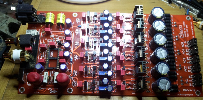

Quanghao, guys,
my transport provides a balanced output, so I would like to use DAC END XLR input.
Did you test XLR input? Does balanced connection works?

yes, but you not use toslink.

hello Guanghao,
the sound is very nice and fairly compensated, thanks to Andrea, and to you for the work you have done.
Just one more question I have installed the 5687 and point B I have 144V. and point P 51V. is that correct?.
without putting the Tubes I have in the point B 260V.

no!
if not use LL1660 out put,
So the V at +B 250 to 260V, The vol at Anode at 90 to 100V. thanks
Hi,yes, but you not use toslink.
thanks
do you mean don't use both at the same time?
or don't install TORX?
Andrea
Andrea _mori
don't install TORX
the Torx and the XLR Balanced are connected in parallel to the relay
don't install TORX
