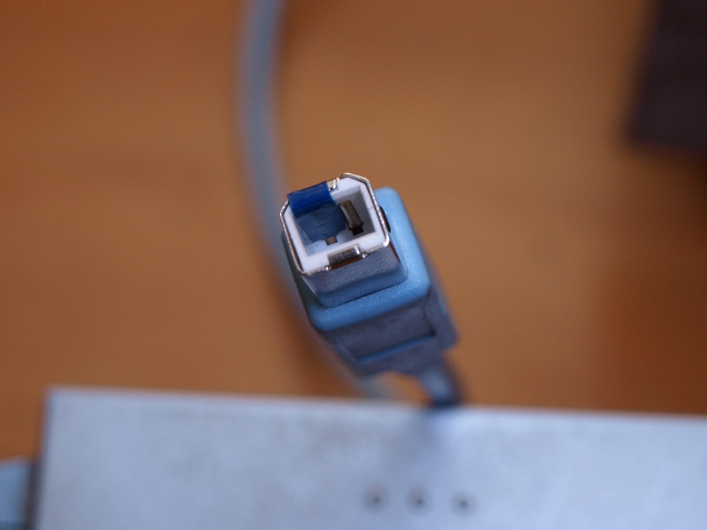

I have covered the USB connector's pin 1 (Vcc pin) with a tape and powered the Amanero with DAC power, it works, no removal of LDO is needed.
