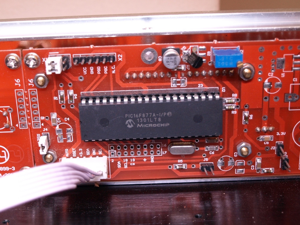

I am still waiting the DAC so I am testing the firmware on develop environment.
If you press the menu button on keyboard during startup phase you will see the firmware version (work from ver. 48a).

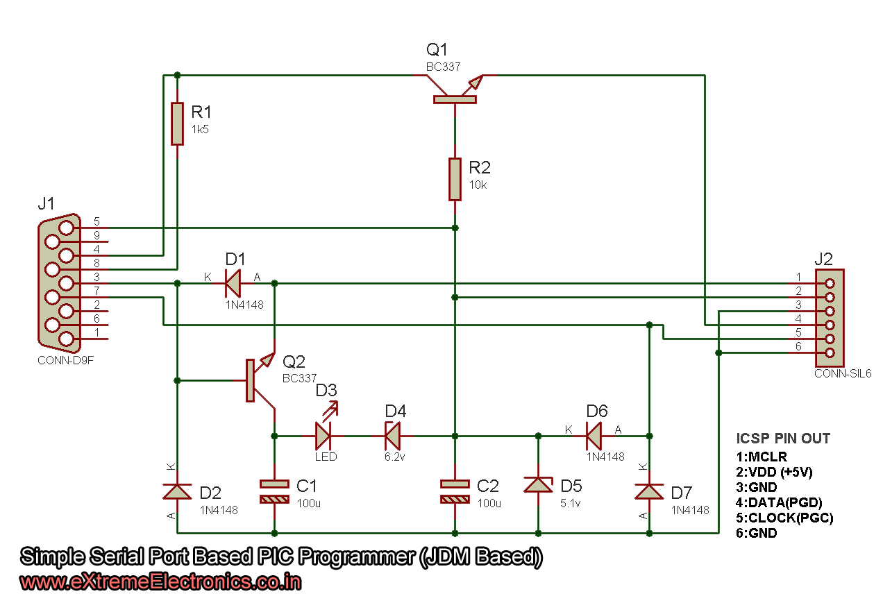

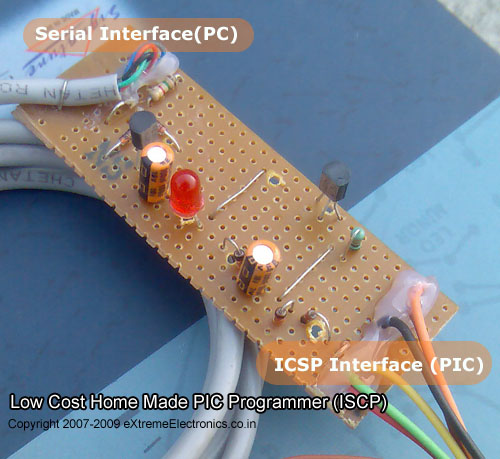

Found this Simple DIY PIC Programmer. Programme with the free PICpgm tool.
If this thing works, probably more people will be able to programme the PIC and test the code.
Making a Simple PIC Programmer.eXtreme Electronics

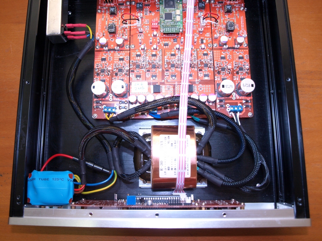

AFTER 1 HOUR of experimenting every component on power supply part of PCB is HOT !!
