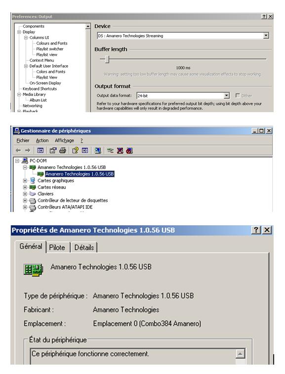

Hi Dominique,
I just tried the DS amanero driver and I have the same problem: whatever resolution I play the DAC always displays 44.1
I don't have this problem with the ASIO or the Wasapi driver, those drivers work with 192k and DSD, see my previous post for installing the ASIO driver.
Danny
Hi Danny,
Hi Dominique,
I don't have this problem with the ASIO or the Wasapi driver, those drivers work with 192k and DSD, see my previous post for installing the ASIO driver. Danny
Well, I am not lucky 🙁
Replacing "DS: Amanero Technologies Streaming" with "ASIO : Combo384 ASIO" in Foobar2000 does not change anything.
- When I turn on the DAC, the display shows "44Khz", "USB link_", "LOCK".
- Then, when I start reading with Foobar, the display always stays at "95KHz" even if sample rate is 44.1 kHz or ... or 192 kHz in Foobar or even if I select another input (AES/EBU, Coaxial or Optical).
I am not sure that the problem comes (only) from the Amanero card because there are others issues on my DAC:
- Can't read sample rates more than 44.1 KHz on the other inputs.
- Can't shut up at minimum volume.
- Sometime he is confusing (not me 😉 ) with the remote : For exemple when I want to change the input, he is lowering the volume
I am beginning to consider to ask to Quanghao or to Andrea the exchange of the main board.
