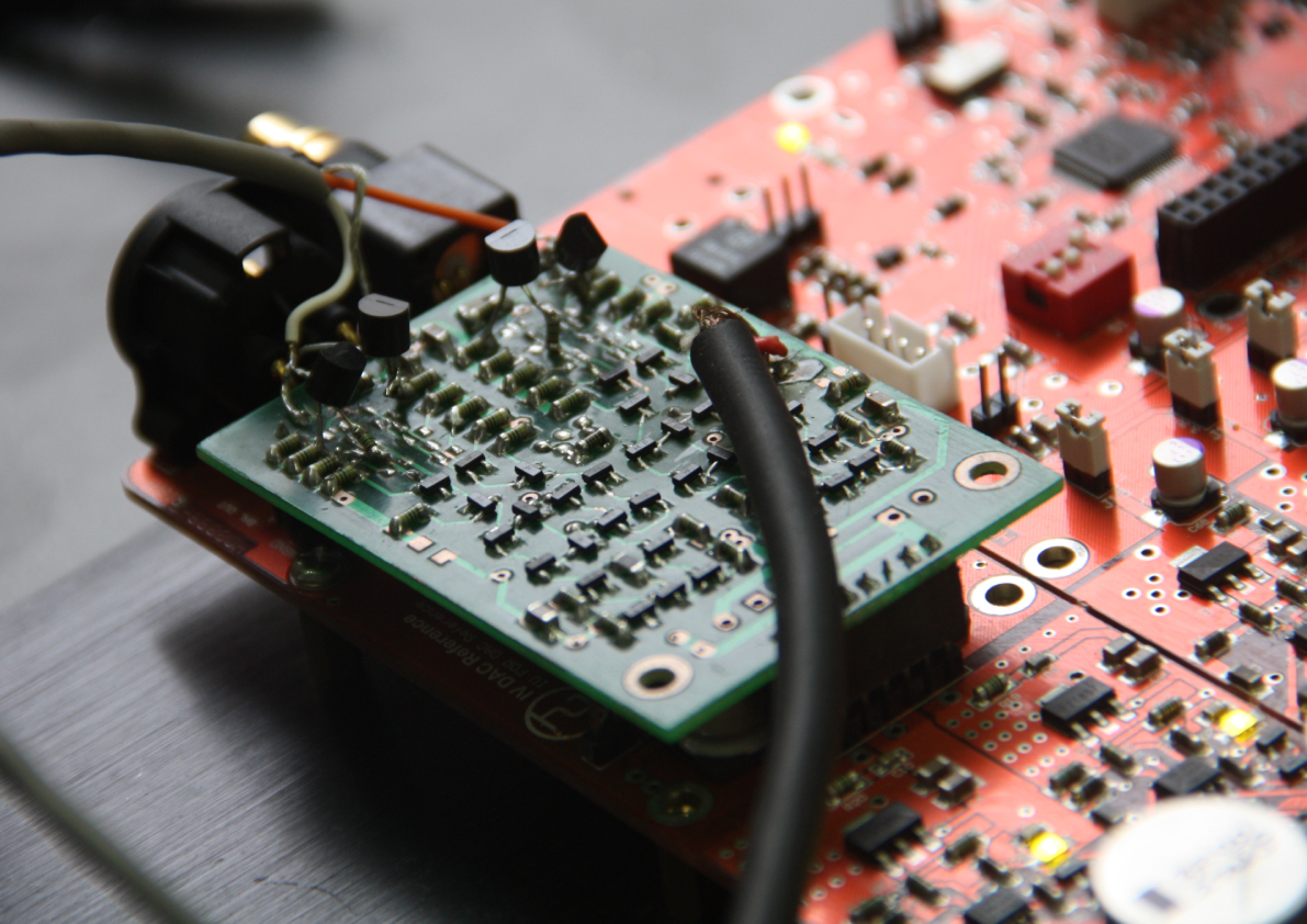

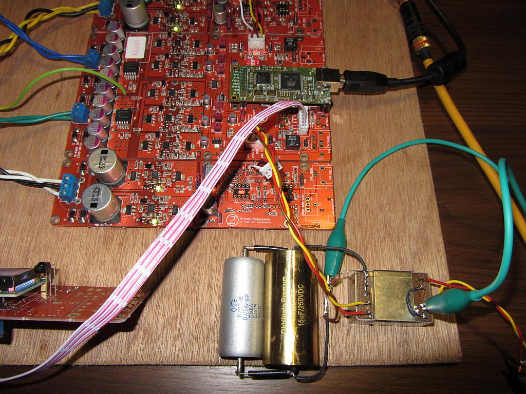

Transformer grounding issues
Hello,
A few days ago I changed my setup a little: before I used my laptop for playback, now my PC.
With the laptop I didn't hear any buzz/noise from my speakers, but my laptop had to be connected to the amanero. Disconnected I had some buzz/noise.
Now with my PC I had also buzz/noise, if I disconnected one channel to my amp the buzz was gone, probably a ground loop issue.
Then I connected the PCB ground to the RCA ground output and my speakers are really dead dead silent, see the green wire in the picture.
For those with an output transformer this is something very simple to try out: put your ear next to the speaker and try with and without ground connected.
I am definitely going to install a switch that connects the PCB ground to the RCA ground.
Danny
Hello,
Danny

So that would be me, pretty sure we are the only two who have output trannys so far, of course the total user population is not too big.
I did notice something similar last night. Running my macbook, when I plugged it into the charger I could hear some faint buzzing noise in the background, but only with the charger plugged in. Without the charger, no noise.
I figured it was just some noise the charger was making, but when I had tried playing with the macbook charging with my zapfilter I did not hear this noise.
I'll try adding that ground, and see what happens.
Randy
