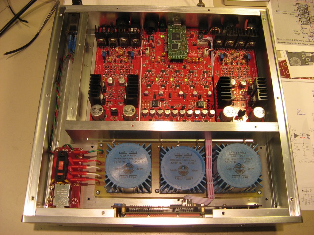

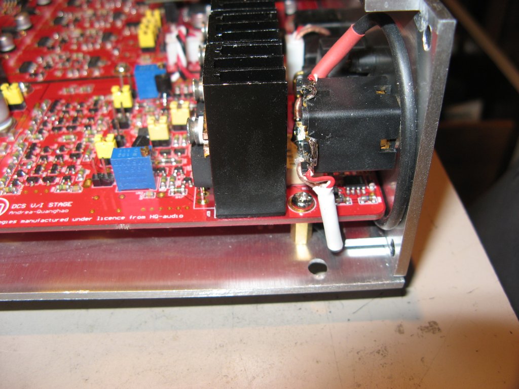

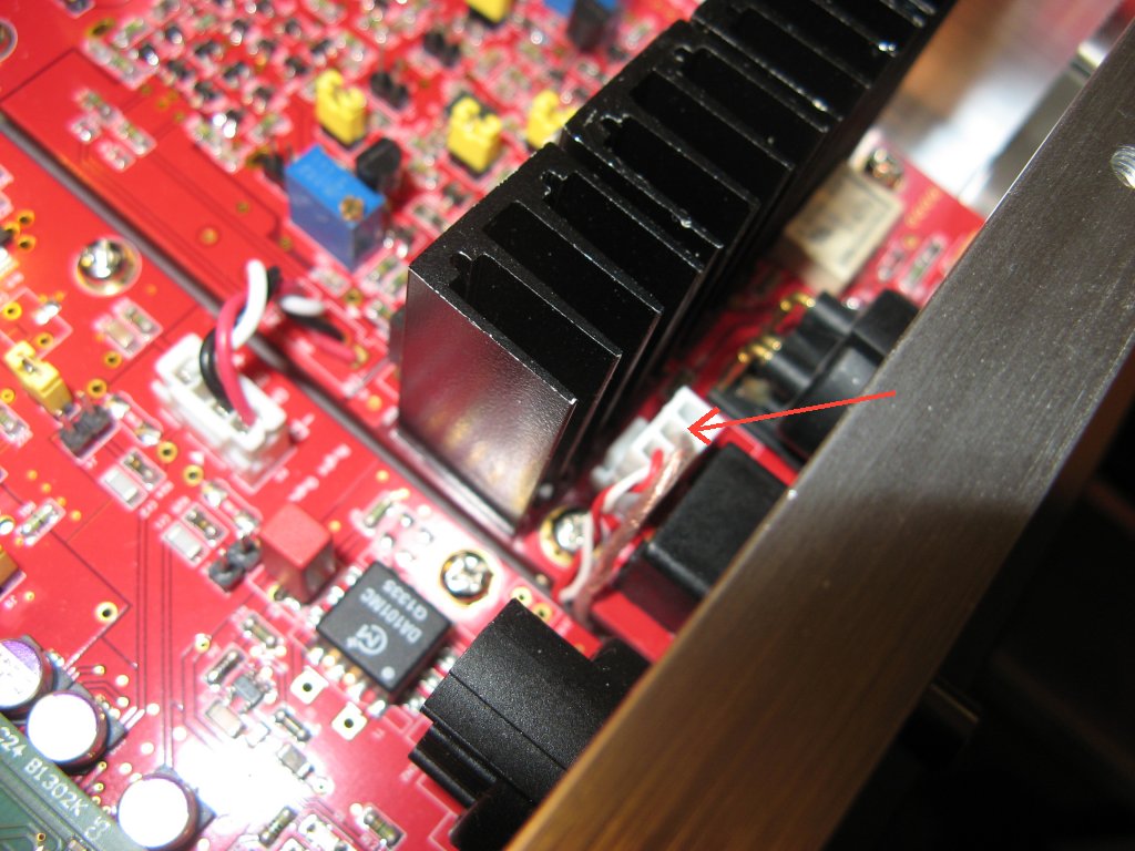

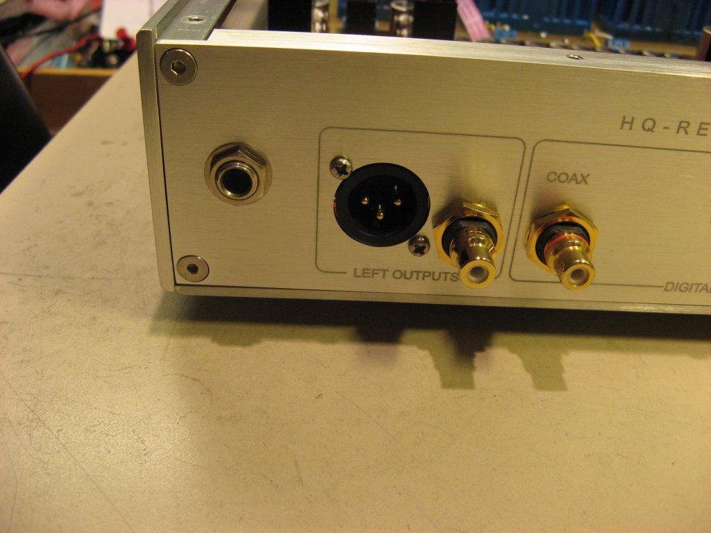

I installed a headphone output on the DAC, solid-state I/V type. The DAC drive my AKG without problem.
Is it possible to have a headphone output with the Lundahl LL1684 output stage or just with the solid-state I/V stage as above and photo's below?
Also, just to give me a rough idea of timing; approximately how long did it take for assembly/delivery from the last group buy after payment had been made?

I don't think the LL1684 passive I/V can drive headphone. The active I/V is really a Class-A amplifier, so it can drive headphone without problem. The LL1684 won't have the current drive needed to drive headphone I guest...
yes iv Ll1684 can not driver heaphone.
