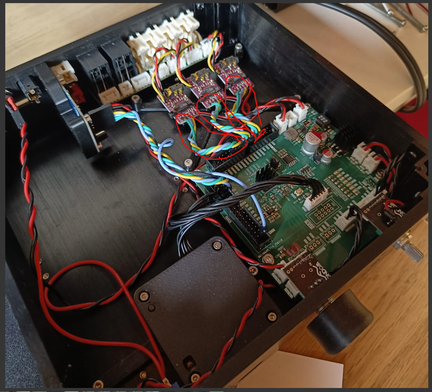

I am working on a board to replace the cheap china modules I currently use in my DIY DSP: https://www.diyaudio.com/community/...-based-on-adau1466.426241/page-2#post-7985793

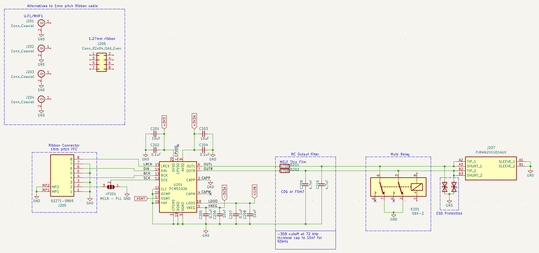

I may be able to post my schemattic and layout later if you wouldn't mind shooting it down 😀

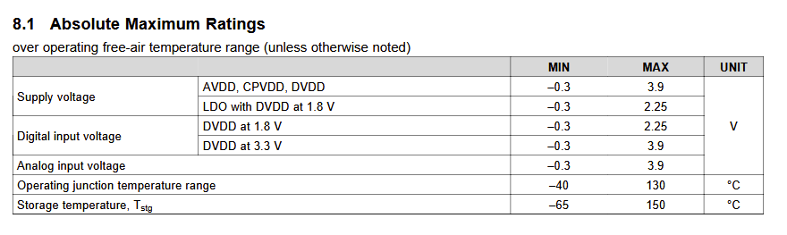

Checked i2s, there is 3.3V levels at oscilloscope and it works with 1.8V DVDD. Looks very decent, what is main power source? Relay is unnecessary, PCM5102A mutes output to GND by itself. What will be i2s source? For filter capacitors you can make many different holes/layout for tht or smd. If you make your own board, think about layout DGND/AGND. I'm not sure internal PLL will work with disabled charge pump and think it anyway better to have MCLK from good quality oscillators (powered by separate regulator).
Really? well its not within specifications at least.. but thanks for testing it!

The relay is unnecesarry yes, but I will need it for the AKM design, so just want to try it out and see how I can control it and so on 🙂

Yeah my idea was also to just make holes for the film caps to fit so I could try it. Do you think it will make sense? or are the film caps overkill?
Oh, good point on the PLL, didn't considder that.. I have at least 2 mclk outputs on my current DSP board so I should be able to power two DACs at least then..

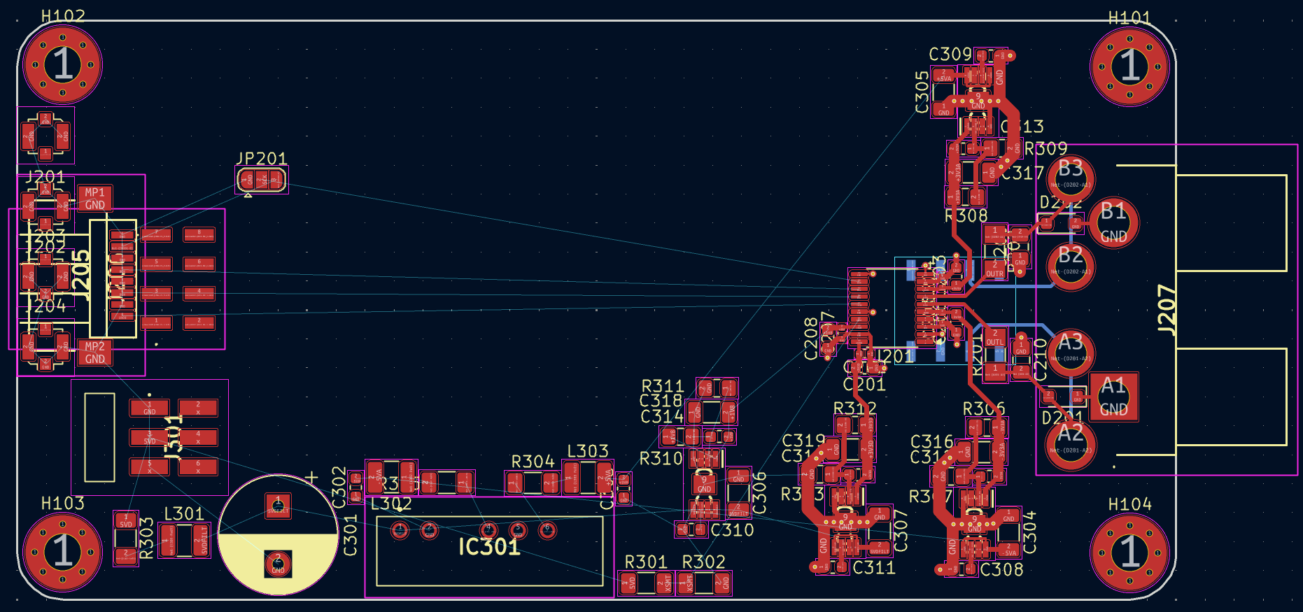

This is what the layout currently looks like. Obviously not done yet, but you can get an impression of what I'm trying to do. its 4 layers. top layer is 99% of it. two internal layers are GND. Bottom layer is mostly GND, some power routing and the relay. I am not trying to split GND, but just physically keep analog stuf on the analog side of the DAC and everything else on the digital side. Does it make sense?

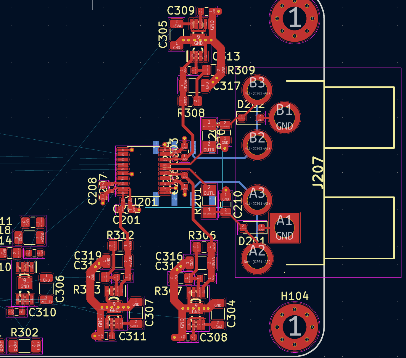

Closeup of the interesting part
Looks solid for me, I haven't learned how to model boards yet, now trying to learn it with KiCad to make own board version of dual PCM1794 NOS DAC.
Leave more space between PCM and output connectors for bigger caps variants. Also I think that i2s lines should be as short as possible (and what about damping resistors). With 4.7nF caps in RC we move phase at 10kHz approx for 8 degrees, but I can't say it is audible.

Yeah, will make room for the film caps, will be fun to be able to try it.
I do not belive the i2S lines need damping resistors at the recieving end? There are some right at the DSP exit on the DSP board.
I also don't worry to much about the i2S line length.. Honestly, i2s seems pretty robust. if the spaghetti monster I have now works, without any GND refference at all (just LRCK, BCLK and DATA, not a single GND wire next to them - only the power wire has a GND next to it) then the new design with a 1mm pitch ribbon cable with gnd between each signal as well as this 4 layer board with GND below the signals must be like livin the dream for i2S xD
