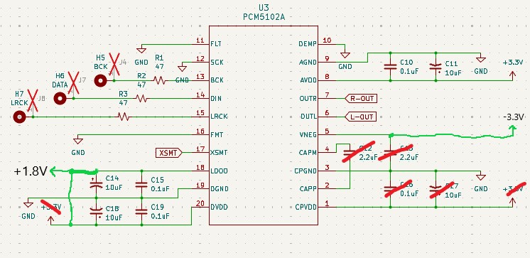

Can't edit but I must say that I'll need to wait for warm up all new components, yesterday it was very good, but today I'm not sure. Anyway this very cheap PCM5102 is a good DAC as minimal for newbies and even not only for themNow my favorites will be K11 on CS and this PCM5102A

Finally made a new power supply for the PCM5102 analog part and it sounds amazing. It is two absolutely different DACs 👍No charge pump = no possible MHz spurious. Almost neglectable but when one has the choice...
After some experiments I found that it is better to disable internal LDO and use external 1.8 for digital part and also disable internal charge pump and make external +-3.3V supply. For digital 1.8 I use LP5907, for +-3.3V TPS7A4701/TPS7A3301 and also one TPS7A4701 as main positive supply after rectifier. Aslo seems to me it is better to use external master clock.I finished the design.
Thanks Anatolii for the feedback and sorry for the late reply. I aborted the project and had a pretty complicated year, but your advice made me want to work on it again as soon as I'm able to !
Triggered by your post I looked again at the data sheet of PCM5102A and see that TI now recommends using TAD5142 ("a newer version of this product is available") despite the PCM5102A being labelled as "active". Not pin compatible and QFN.
