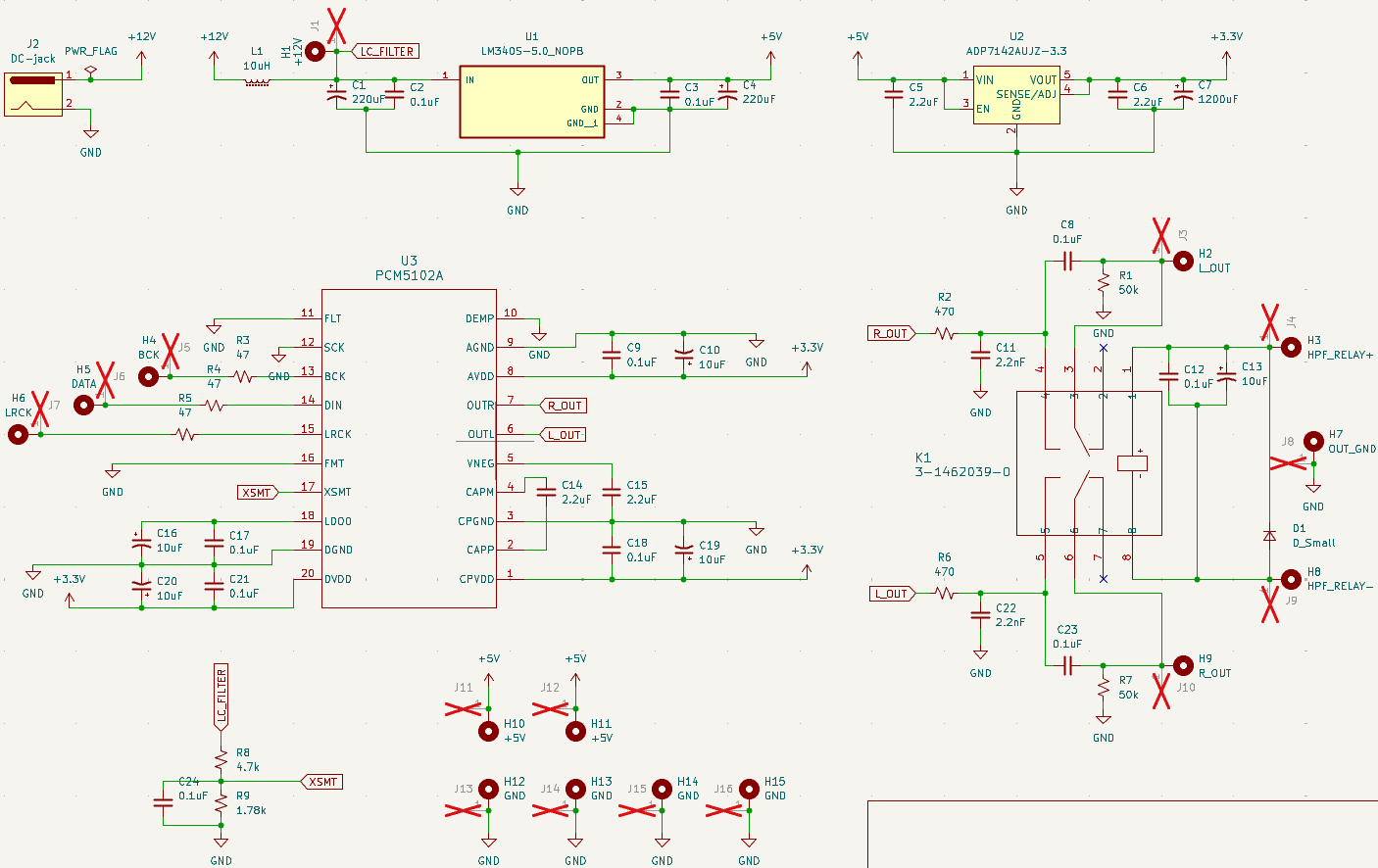

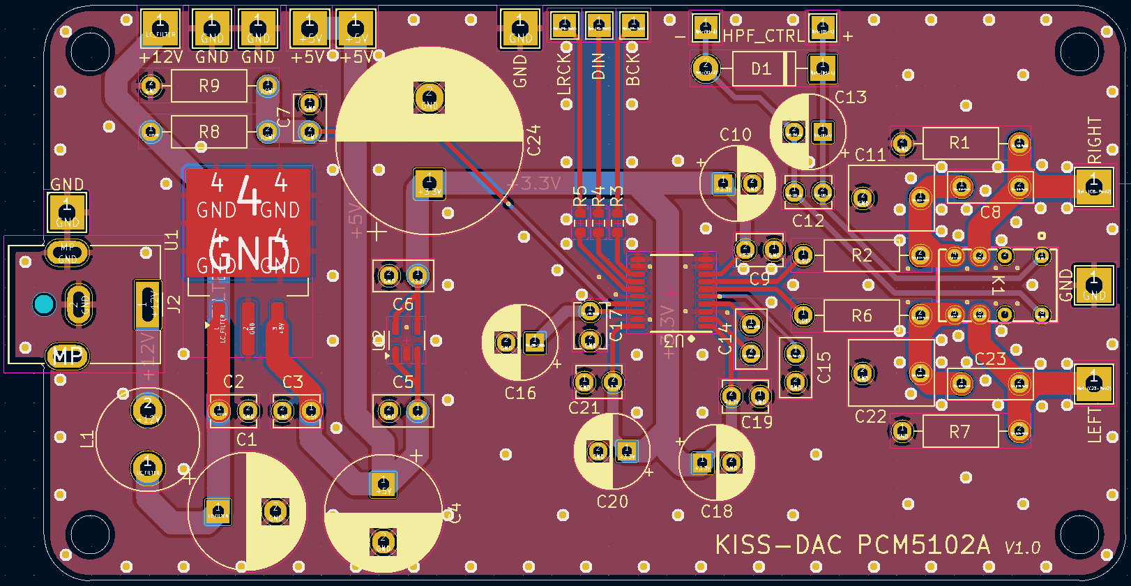

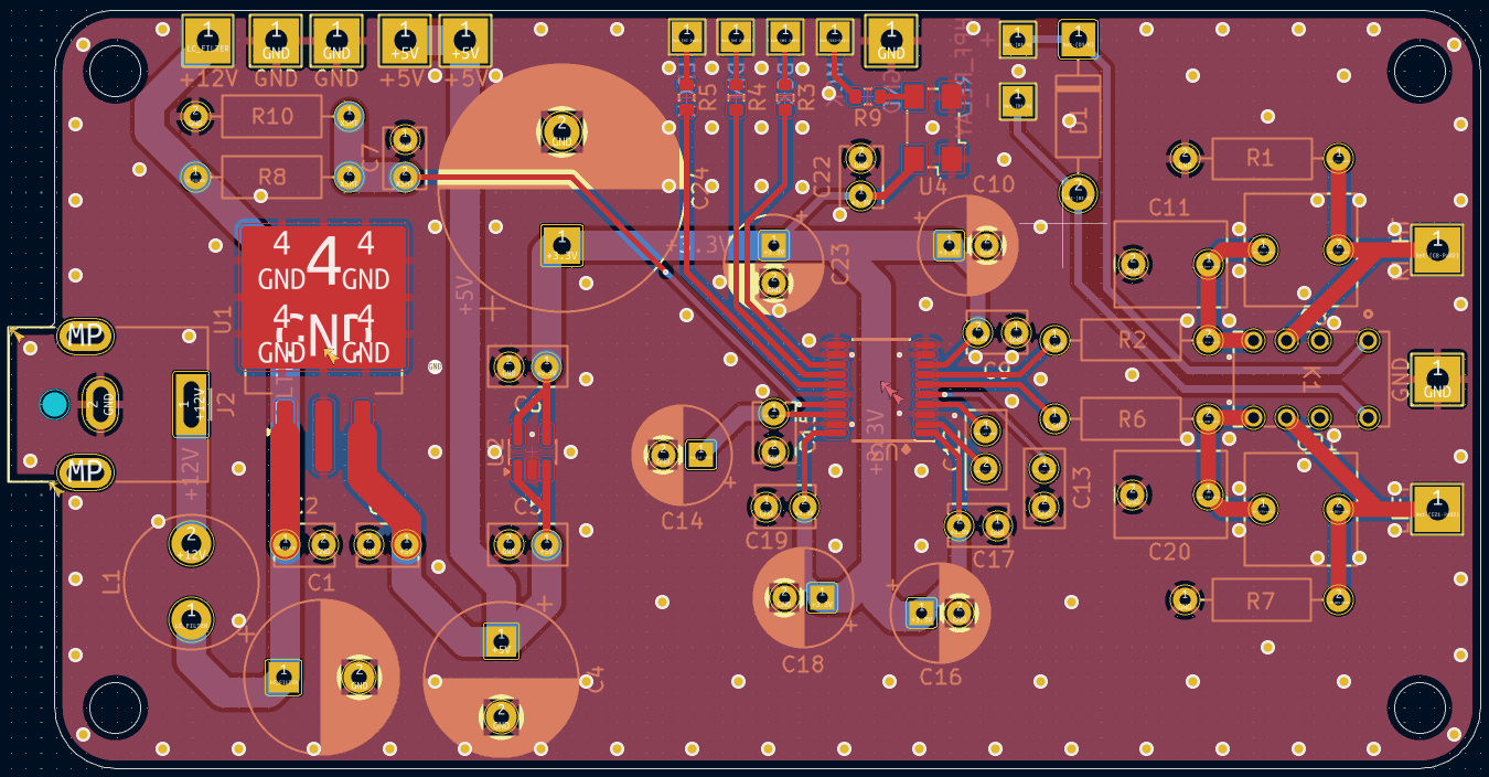

DAC design based on PCM5102A
Hi there !
After an attempt to design a bluetooth DAC, with questionable technical choices, I decided to be reasonable and make an S/PDIF version.

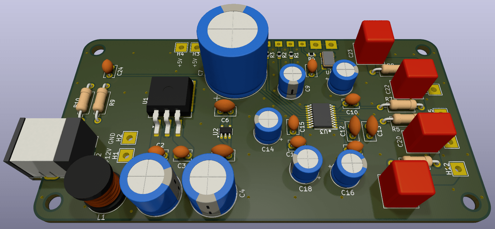

The DAC is still based on the PCM5102A chip, without additional preamplification stage, and the 100x50mm 4-layer PCB receives one ground plane per layer, connected together by vias.
I will use this module for S/PDIF to I2S conversion: https://www.audiophonics.fr/en/inte...spdif-to-i2s-dir9001-24bit-96khz-p-17274.html
For volume control, I'll use this: https://www.audiophonics.fr/en/preamplifier-modules/motorized-volume-control-board-50k-p-15006.html
From what I understand, the DIR9001 module will synchronize to the S/PDIF clock, and the PCM5102A will also synchronize via the I2S bus. I still connected the MCK pin of the DIR9001 module to an oscillator, so the DAC should keep running correctly without an S/PDIF signal, because my Tripath amp does not like to operate without a source.

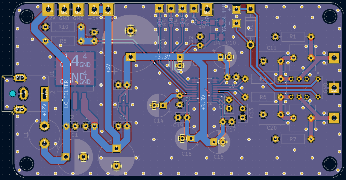

I placed an LC filter at the 12V input because the DAC will be powered by an external SMPS power supply. Please tell me if the values of this filter are correct.
As advised for my previous design, the low noise 3.3V LDO is cascaded to a much larger 5V LDO to lighten its workload.
As this design was quite conventional, I couldn't resist adding a quirk, a high pass RC filter, for optional use.
Indeed, I chose the PCM5102A because it is the only decent DAC chip that I felt capable of implementing, being a beginner. But I know that it tends to be a little too generous in low frequencies.
So I added this high pass RC filter which cuts at 48Hz in the hope of being able to obtain more controlled and clean bass, if the need arises. I can use capacitors with significantly different values to fine-tune the filter. Let me know if this is a bad idea 🙂
EDIT : I just saw a big error on my high pass filter which in reality is a low pass 🤣. I am going to correct this and I am thinking of using a relay in order to be able to bypass this filter easily.

It is the voltage divisor for monitoring 3.3v from 12v for the soft mute system, as represented in the datasheet. I simply adapted the resistor values for component availability. I done it wrong ?
I didn't integrate the DIR9001 because the project is already quite complicated for me, I don't feel capable of doing it...

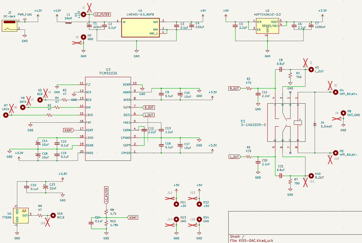

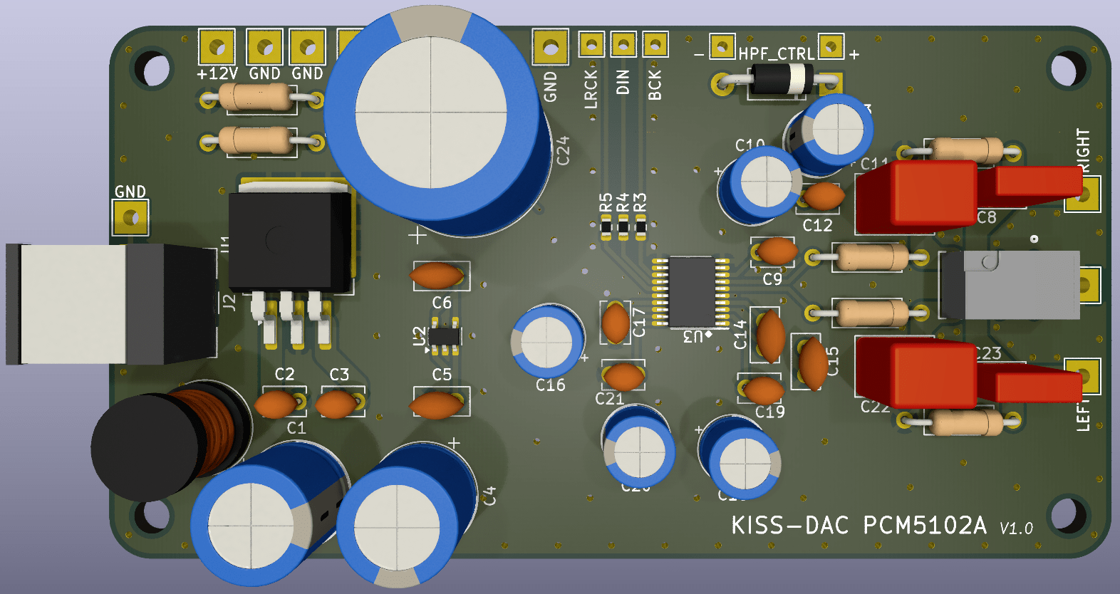

I finished the design.
eclipsevl, I checked the datasheet of the oscillator, looks like the pinnig is correct.

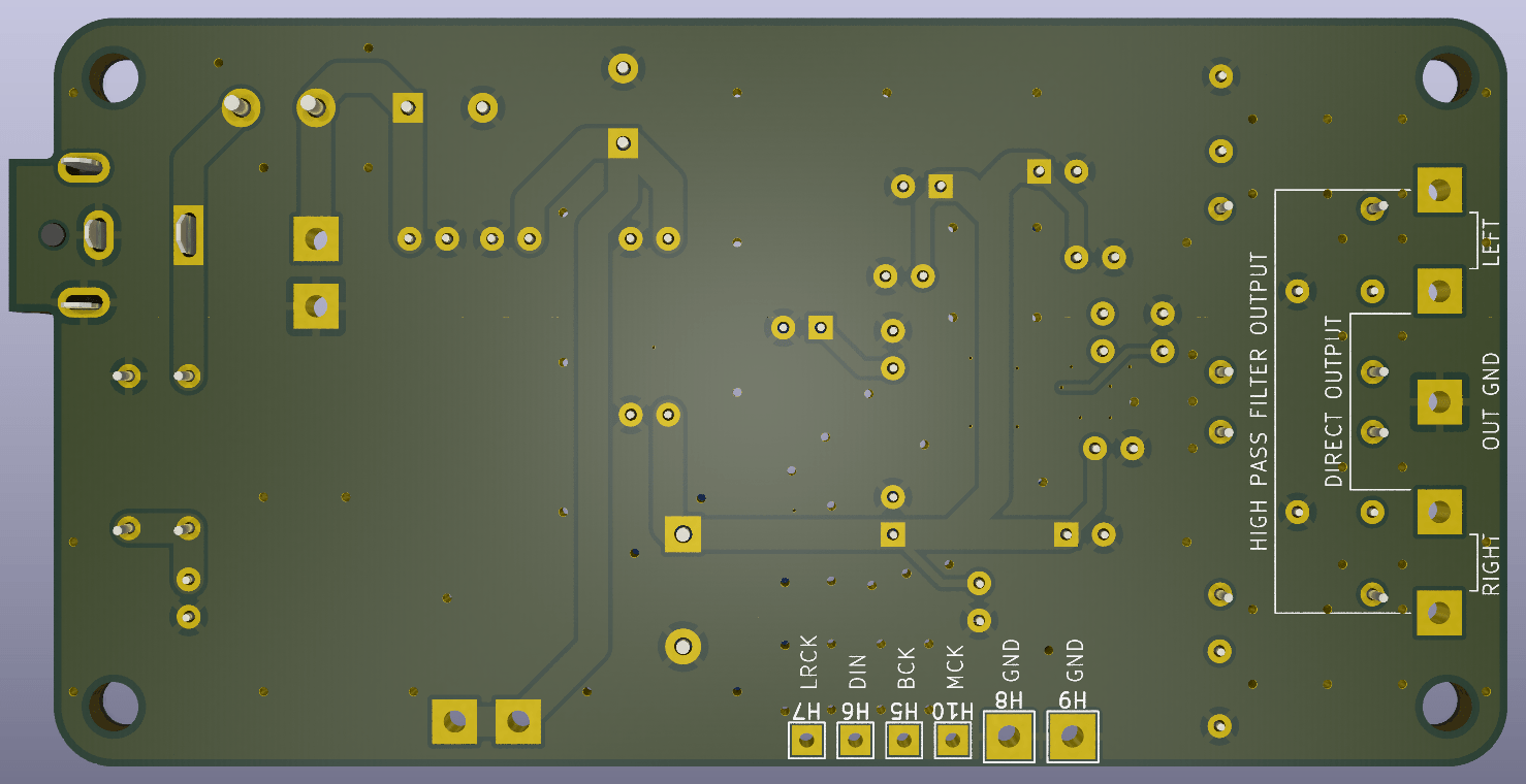

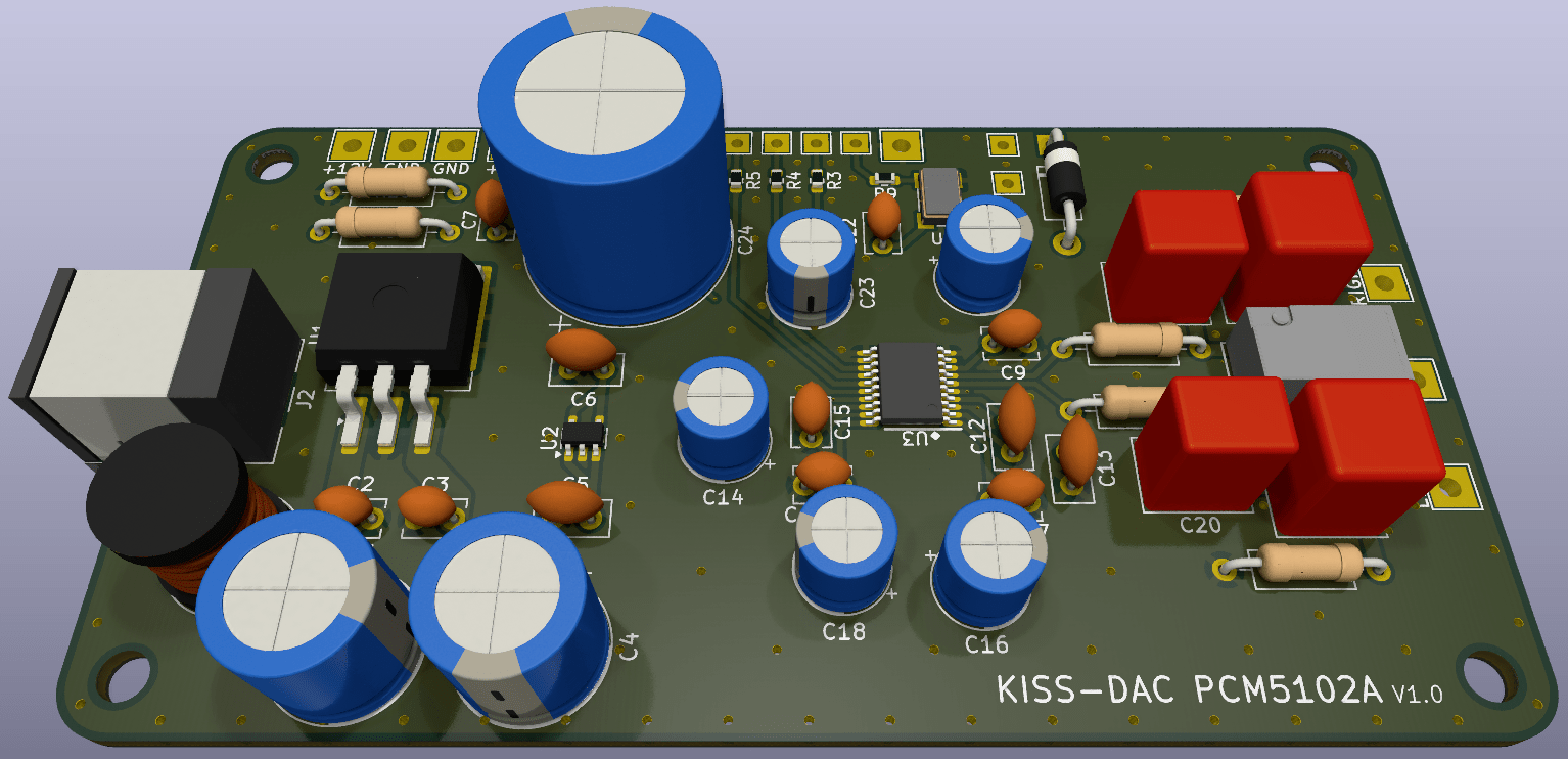

I integrated a relay in order to be able to bypass the high pass filter. I chose a quality model with a very low current coil.
The decision to integrate this high pass filter comes from my experience with the PCM5102A in my current audio system, consisting of a Hifimediy T1 TK2050 STA510 amp and Boston CR8 speakers. Since I had the woofer suspension replaced, which was stiff and cracked, the bass is too intrusive even though I moved the speakers away from the wall. I did a test with an old ES9023 USB DAC and my laptop and the sound is much clearer. I do however need a DAC with TOSLINK input.
So why choose to build a DAC based on PCM5102A? Simply because I am a newbee in electronic design and I don't feel capable of implementing a more complex chip. I just hope that the use of high quality components and possibly the use of this high pass filter will solve the problem encountered with my current DAC.
Am I wrong? Should I give up and just buy a DAC like the Topping E30 II?
Of course not 🙂 pcm5102 is a good choice. My first dac was on pcm2702, also quite simple chip.
The relay to bypass filter is a good idea.
I need to look at the datasheet, I'll have some time on the weekend.

By the way, I just realized that I had misunderstood the role of the MCLK pin, which is not used to clock the DIR9001 module. I had connected an oscillator to it in order to ensure the continuity of the operation of the DAC in the absence of an s/pdif signal, fearing that my Tripath amp would start to oscillate in the absence of a signal. But that's not how it works, and it seems that I was worried for nothing, the PCM5102A going into mute mode should be well supported by my amp.
So I'm not updating the pictures, but I'm going to delete the oscillator.

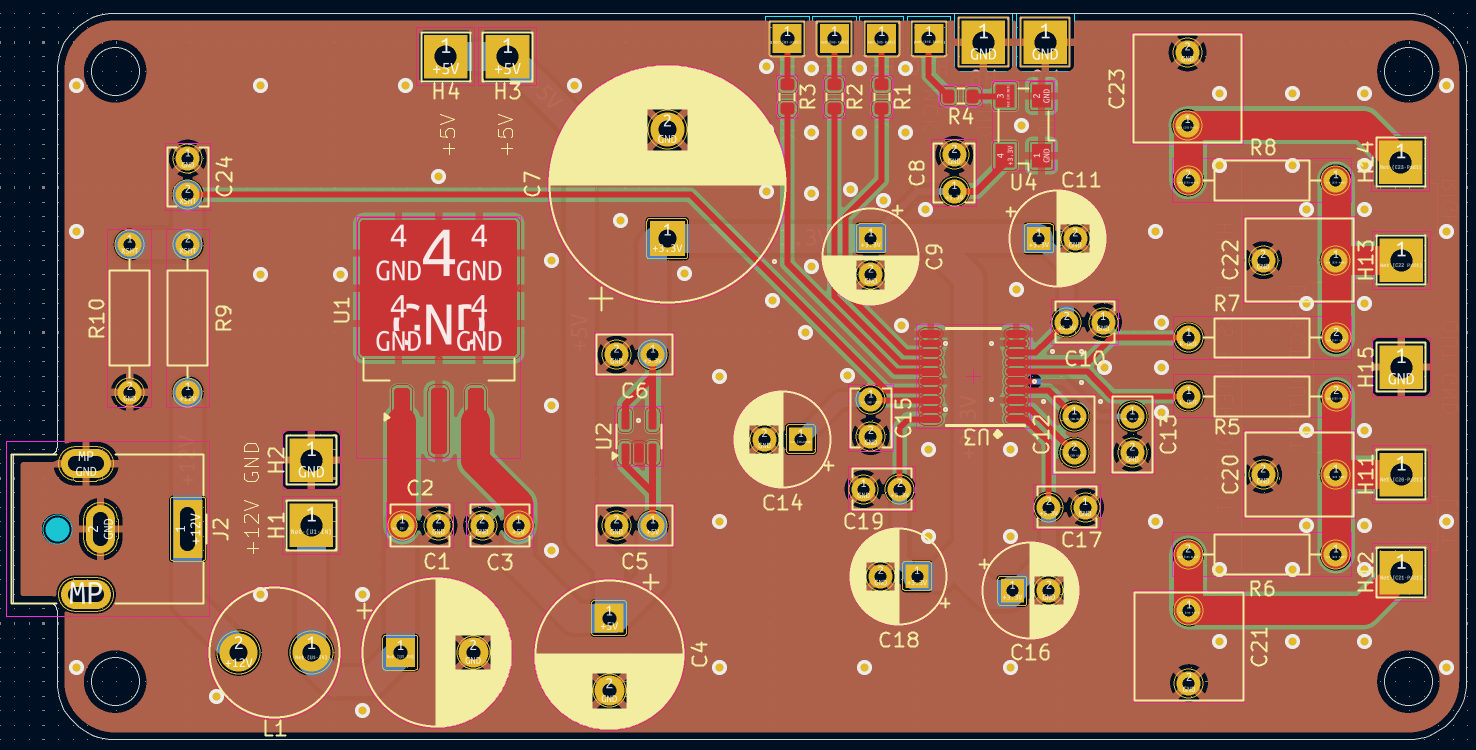

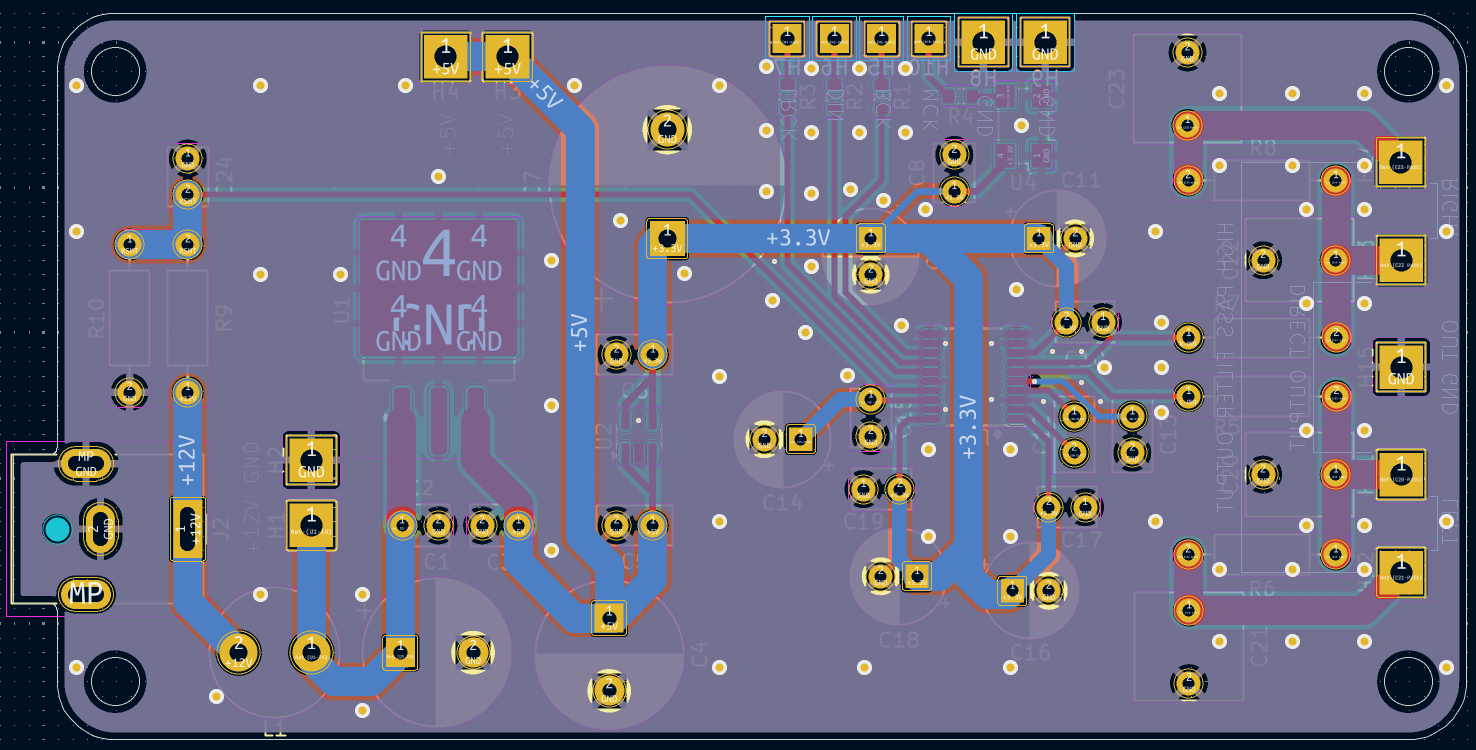

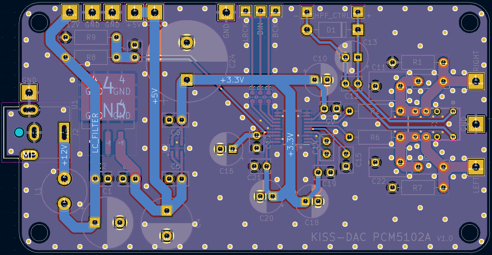

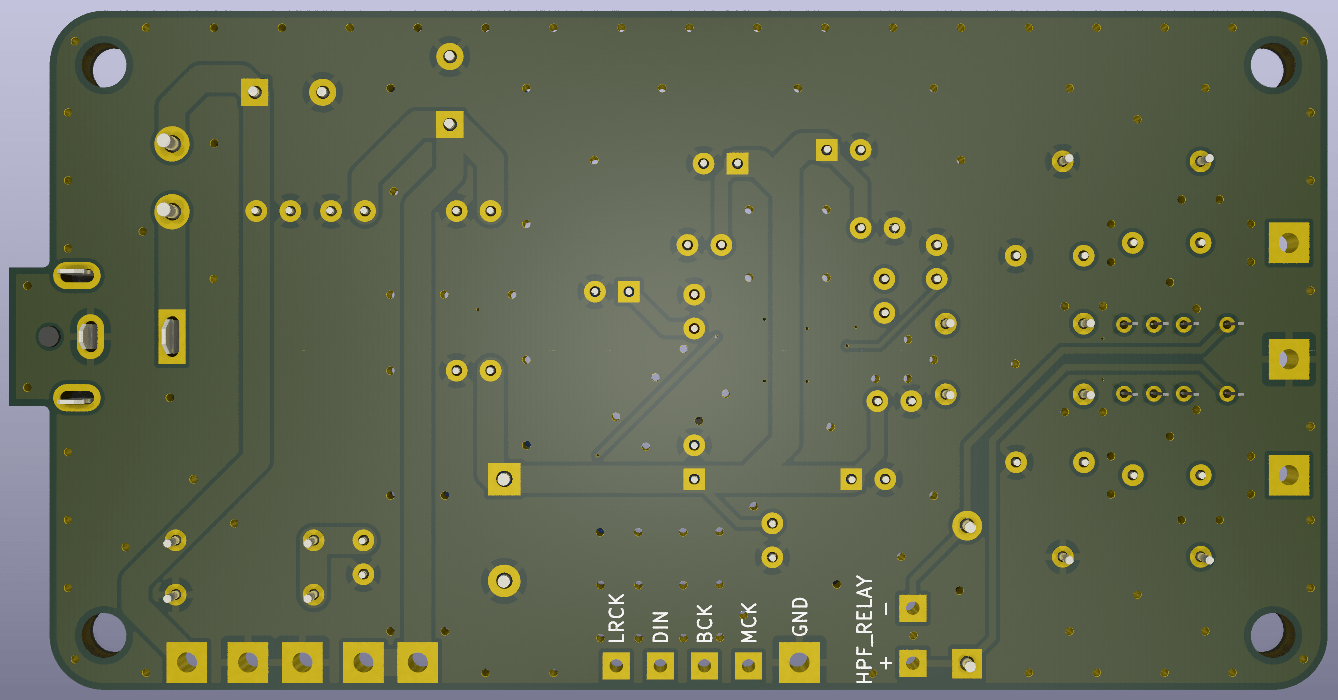

Last update, feedback would be appreciated 🙂
So I removed the oscillator. I also changed the values of the high pass filter components, which are now 0.1uF and 50k.
I added capacitors to the relay control to minimize the influence of the coil on the analog traces, and reworked the routing of the analog section.

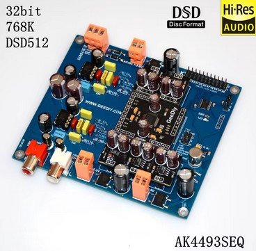

Hi ! You made right decision. I have such DAC on board from aliexpress with some upgrades and used it for few years, but when I heard AK4493S in SMSL Su-1, I threw 5102 on the shelf and forget it for a long time...
After this I've playing with different DIY boards on AK4493 from aliexpress, latest variant I've bought like on attached image. Those boards sounds very well, small chifi usb boxes on AK4493 are at a noticeably lower level of sound. Then I tried how sounds CS chip and bought FiiO K11 and later K11 R2R. I really like sound of K11 with CS43198, especially after some upgrades and with linear power supply. K11 R2R without any upgrades I like less, even after a long warming and even with linear ps... in general this is a bit offtopic, so now writing on topic.
After some experience with power supplies, hearing capacitors, swapping different regulators I decided to find what can I get out of the my old PCM5102A and now I'm realy shocked how this can sound. Now my favorites will be K11 on CS and this PCM5102A. In future it will be intersting to hear something from upper TI level like PCM1796 or something else.
