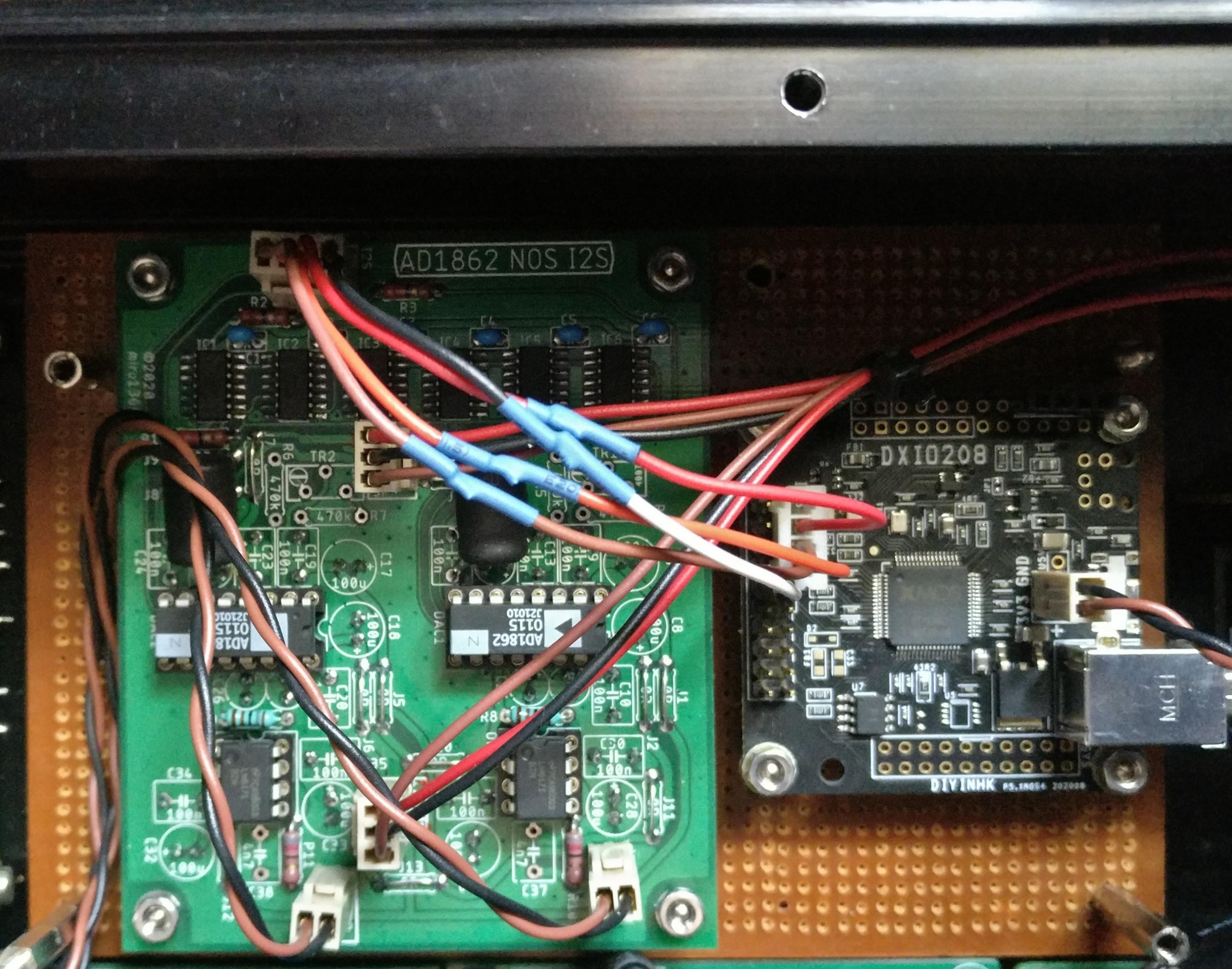

Here is my Build,
Thanks to Miro, Vunce and all the contributors.
USB to i2s is a Xmos based unit, Power supplies are based on LM317/337 for Analog and Digital.

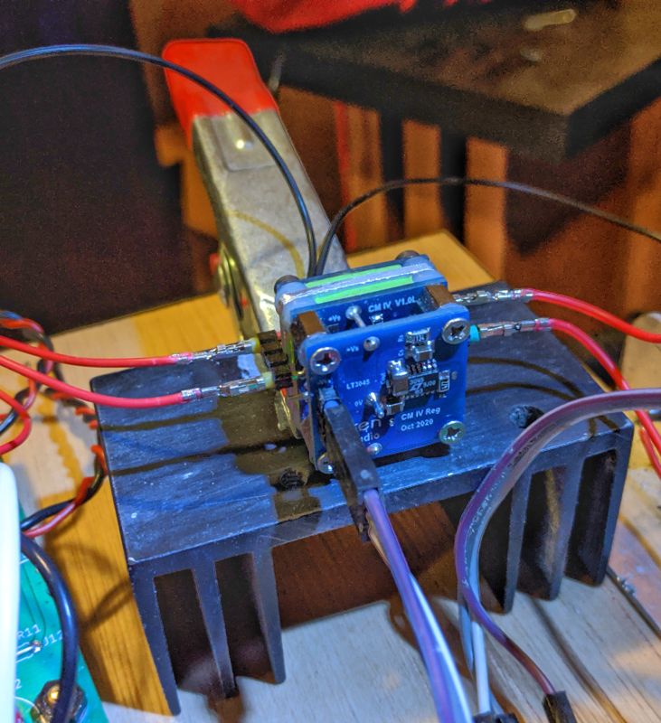

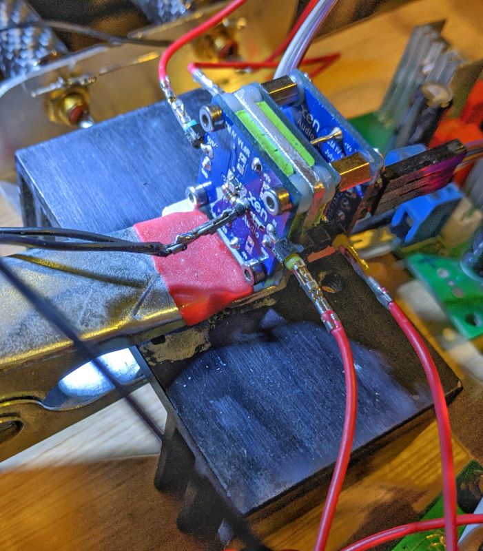

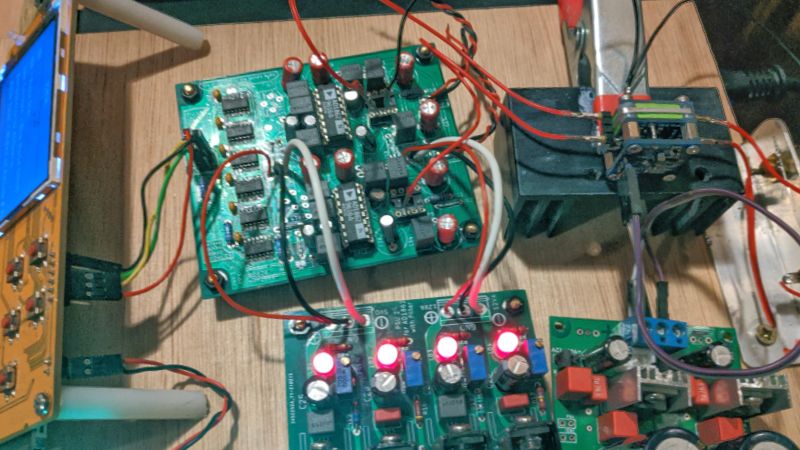

EUVL kindly sent me one of his current mirrors to try out with Miro's 1862 DAC. After proving that the DAC was working fine during the week, and having done some tidying up on the breadboard build, I thought I would give it a try this weekend. I had previously been experimenting with the different opamps I had here, and had been pretty pleased with the op27 and op37 I had tried. They seemed to have a sweeter sound than others. Subjectively slightly tighter bass too, although this was slight I think.
Anyway, EUVL's current mirror uses a 15v bipolar supply, and I had a bipolar low noise supply from diyinhk here that I pressed into action. The unit that EUVL sent has its own regs on board but this was what I had handy. Connection was straight forward, the assembly is certainly bijou in every sense of the word, beautifully made.
I gotta tell you all, the sound from it is just wonderful. It's really impressive, I think just about every area of the sonics have improved - and bear in mind I thought it already sounded good with op27. In short, this output stage brings this DAC from an already high level even higher. Having heard it, it's difficult to go back to the opamps. This unit will go back to EUVL this week, and I'm off now to study the current mirror thread :nod:
