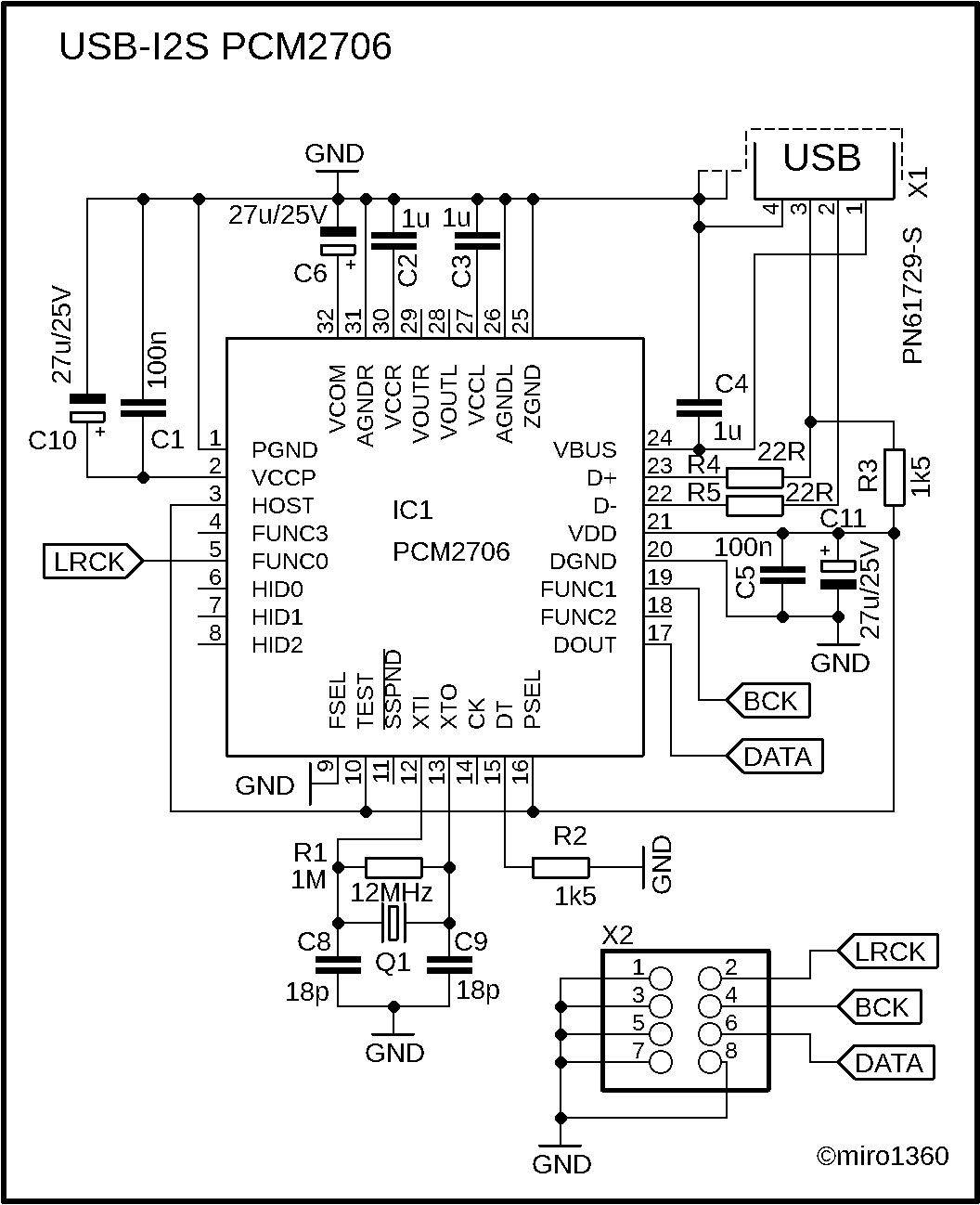

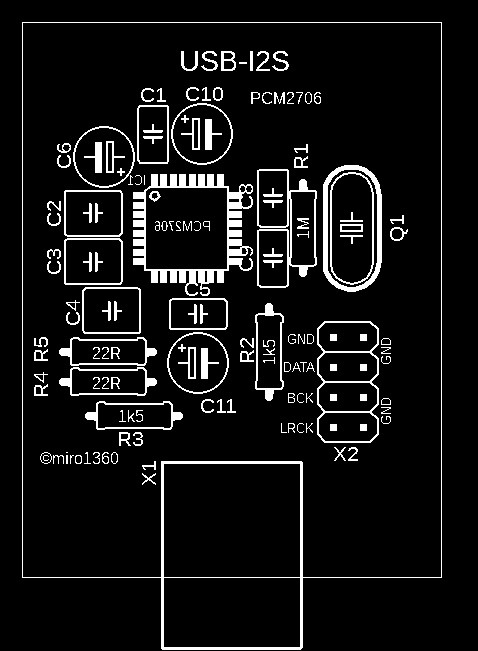

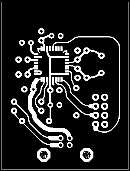

USB-I2S PCM2706 THT
Simple USB to I2S converter based on PCM2706.
- only 16-Bit and 44.1 - 48kHz
- native drivers (it can work under windows, mac, linux, android, raspberry, ...)
- transfer is synchronous (asynchronous is better)
- volume can't be set via windows volume control (only directly in a media player)
- don't use it with modern delta-sigma DACs (where the jitter matters as f**k)
It is almost THT, except for the PCM2706 chip.
How to solder this IC: youtube IC soldering
THT holes are quite narrow, so theoretically SMD 1206 components can fit there.
But I like and recommend THT components for a higher reliability.
Why THT everywhere? Just experience: Another dead DAC from SMD components on my table, where after 3 years an SMD capacitor retired and I can't find motivation for the repair 😀
USB connector can be any (connected with wires - USB cable).
Tested by me and works.

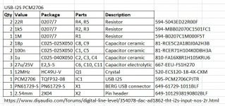

Components example, mouser:
R4, R5: 594-5043ED22R00F
R2, R3: 594-MBB02070C1501FC1
R1: 594-B0207C1M000F5T
C1, C5: 81-RCER71H104K0DBH3A
C2, C3, C4: 810-FA16X8R1H105KRU6
C6, C10, C11: 667-EEU-FS1H270
C8, C9: 81-RCE5C2A180J0A2H3B
Q1: 520-ECS120-18-4X-CKM
IC1: 595-PCM2706CPJTR
X1: 649-61729-1011BLF
X2: 649-1012938190802BLF
  • diyAudio_USB-I2S_2021-02-24.zip
@jean-paul ... experimentation is often a waste of time, people can compare sound with ready-made devices and write their opinions 🙂
I would like to create some USB-I2S for people, but unfortunately everything "better" is not very DIY. It's always easier to buy something ready-made, especially USB-I2S.
Miro,
You should have a look at ECDESIGN 's thread and also look at what made Maxlorentz from Chile as an adaptation of a low noise spidf... diy.
Unfornatuly, my feeling is a synchronous pcm2602, no galva isolation, smps high speed autobahn towards the ad1862 waste its quality despite it is said to be less sensible to jitter.
For not too much while true less diy, sd card a la Fran, reclocked stuffs, or usb xmoss chips, are mandatory for the good sound, ime.
While it's surely a good training and learning thing.
FYI today I tried 2 identical SD card players, with the exception that one has better NDK clocks on board. The difference was clear between both, with the better quality clocks clearly giving more resolution. Not a massive gain, but they all add up.
More experiments are underway. I think I have to try reclocking.
Cheaper as well. The current devices have way better specs than the PCM27xx chips.
