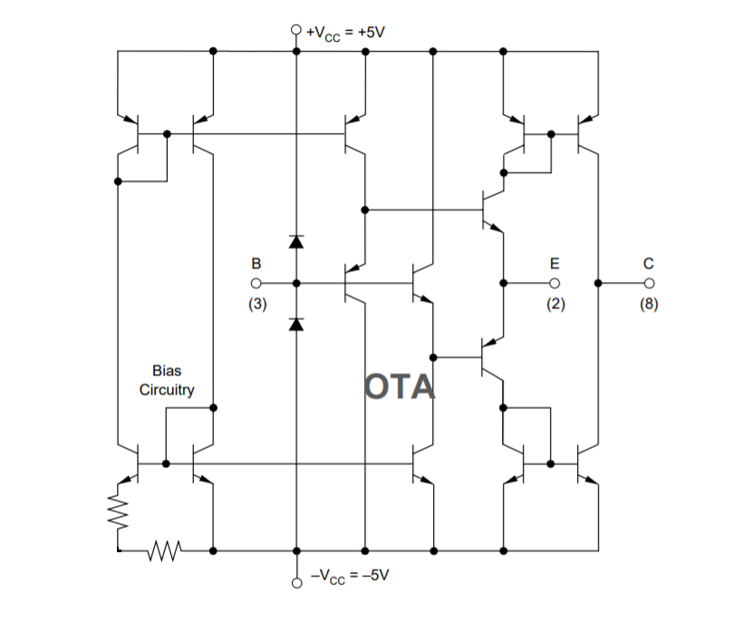

But again you can avoid the selecting parts matching by just using a good transimpedance oap like the op861, but here it would be better to do it on the same pcb as it's high speed enough soic part... it doesn't really need a buffer as well if your pre has high sensivity enough.
As Jean-Paul stated out elswhere in Patrick's thread linked above : it's almost a discrete part and can be seen as a single transistor.

Since we are discussing the OPA861, here is a simplified schematics of its predecessor, the OPA660.
You can decide for yourself whether it is a discrete part or integrated circuit, like the BUF634.
Patrick
