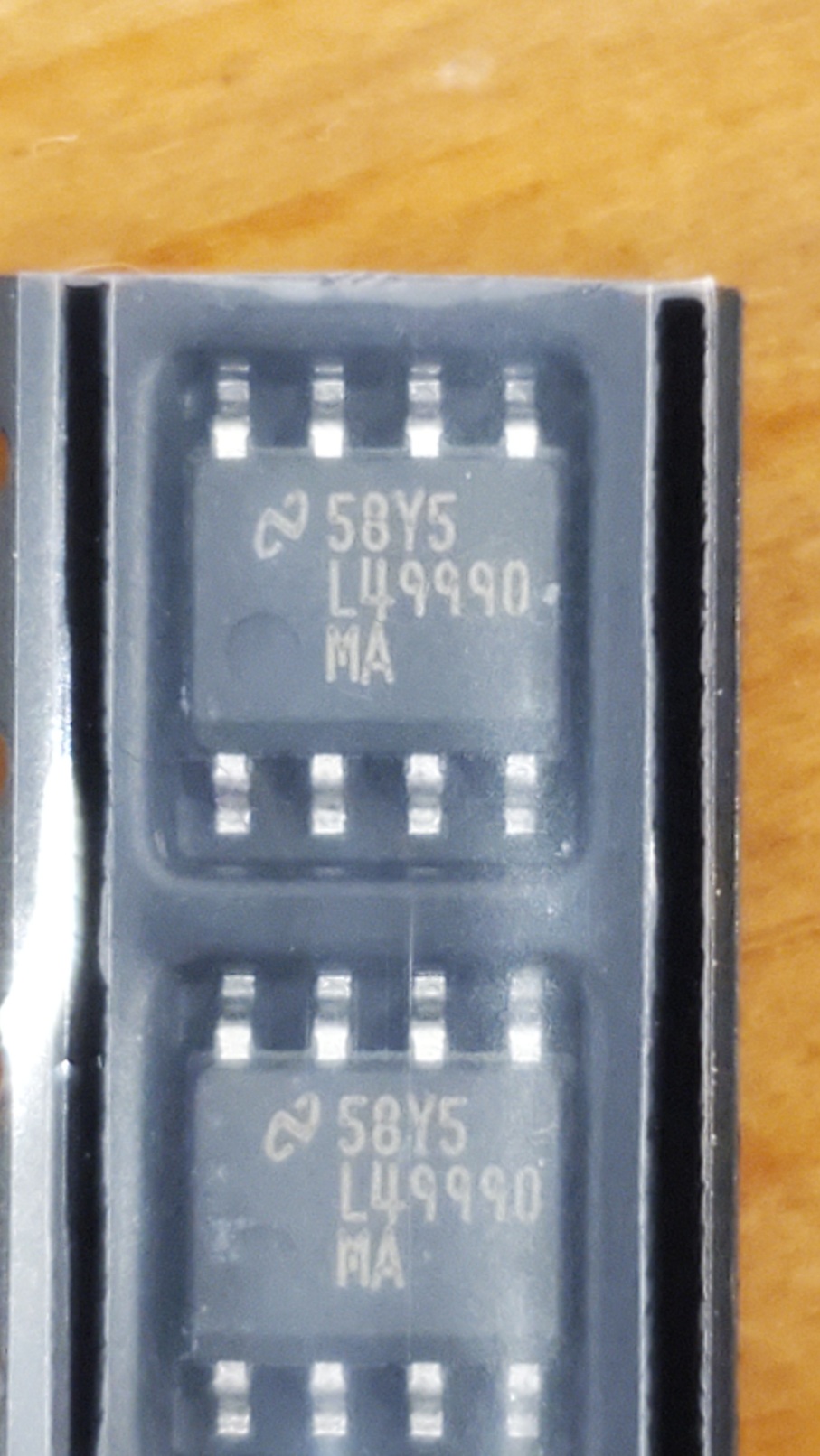

I just have been looking at the picture, for me looks like fake : the marking is too far from the recess at pin1 !

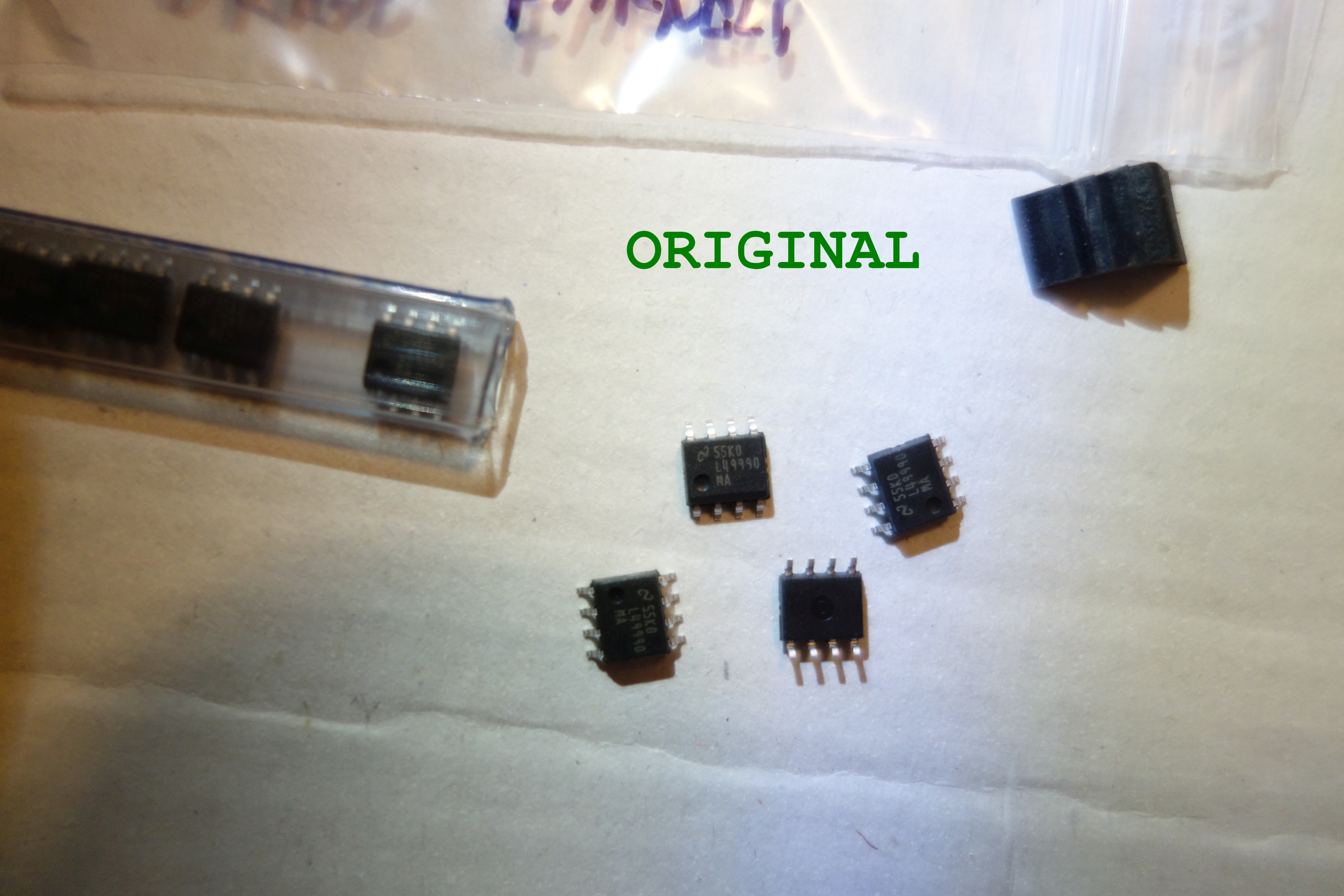

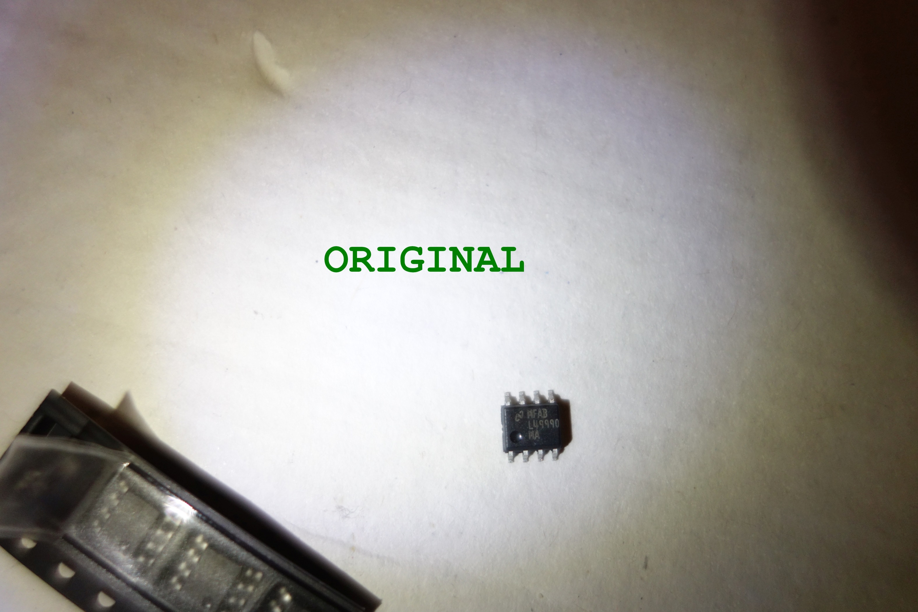

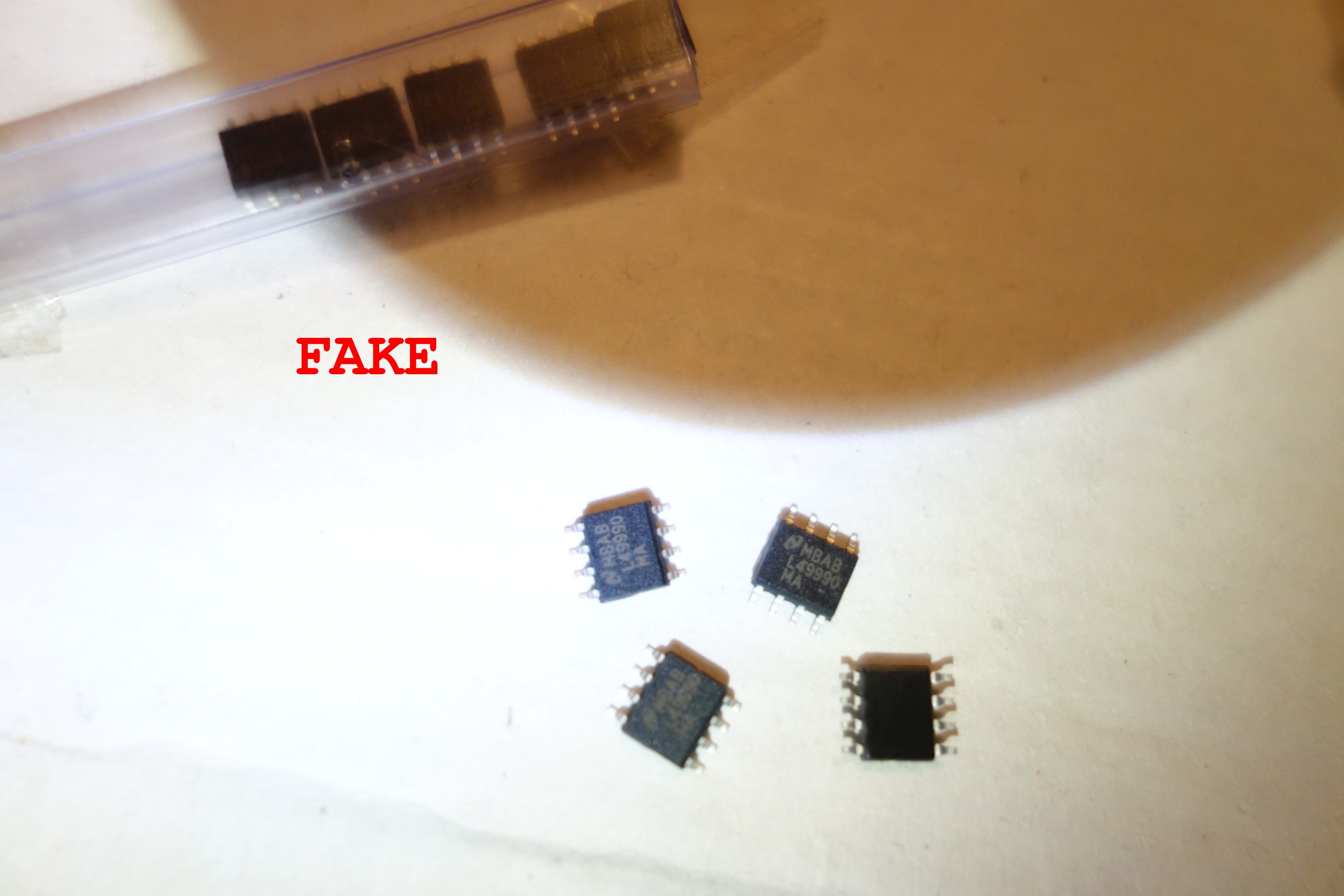

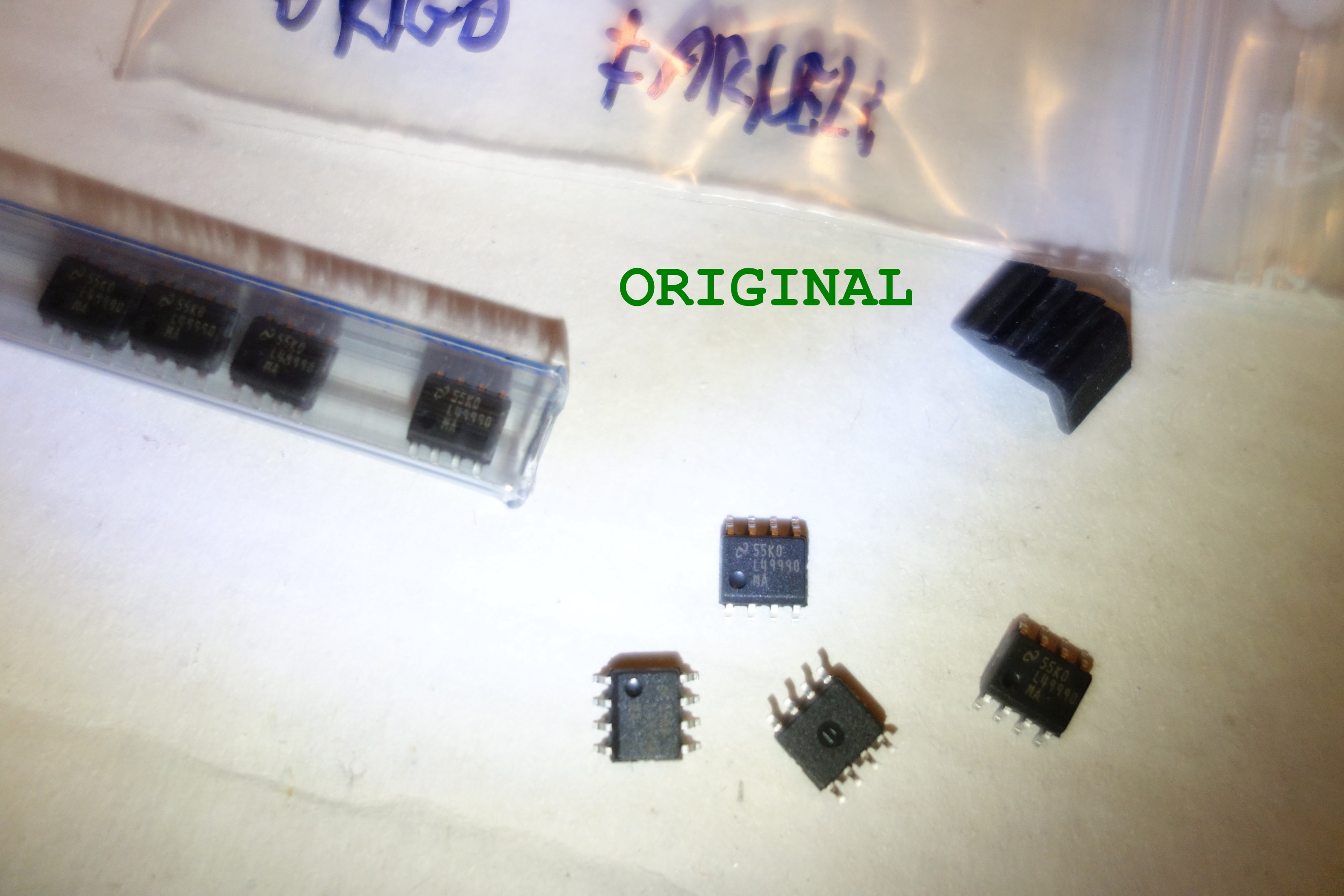

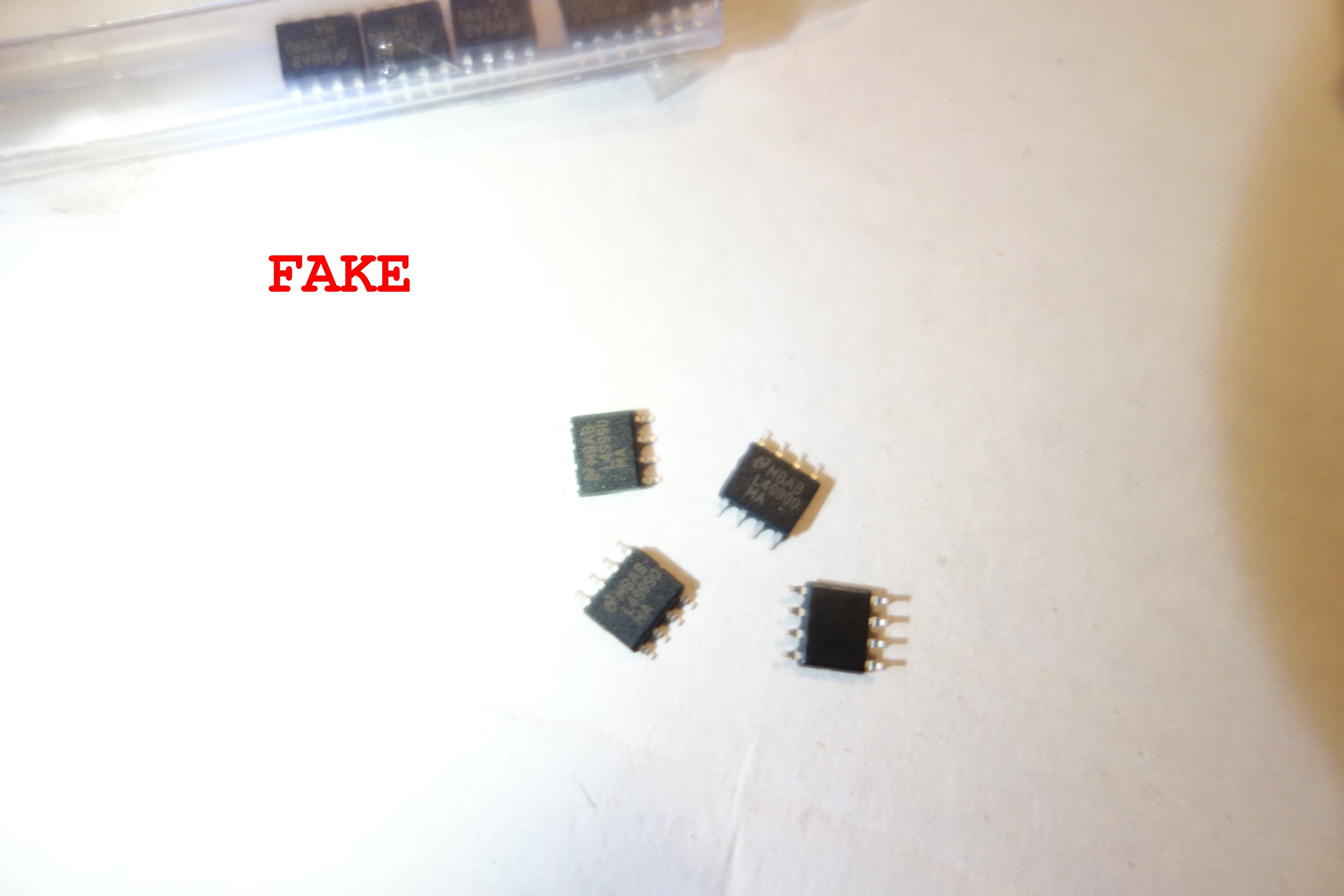

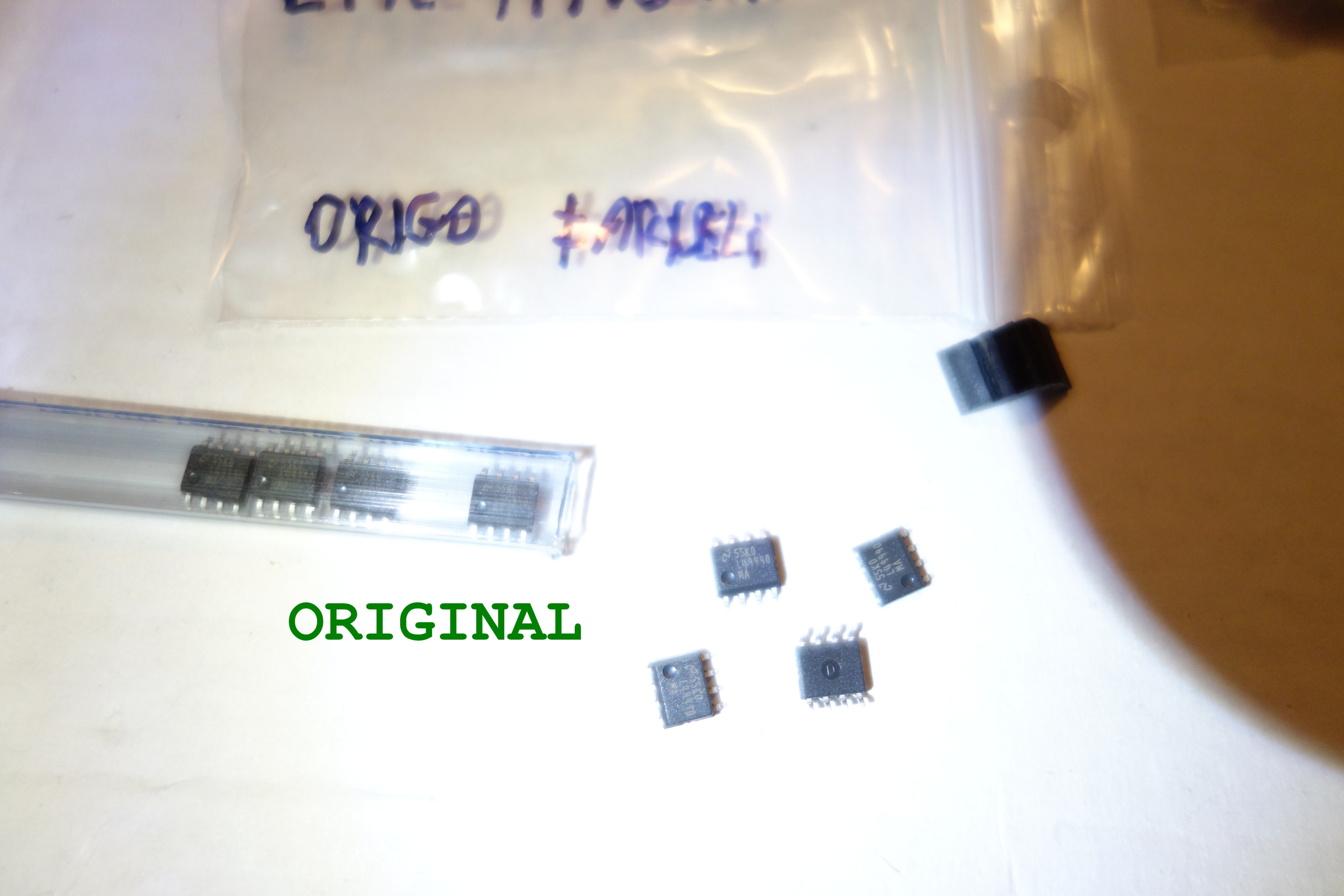

LME49990 genuine vs. fake
here is mine genuine and mine fake from ebay ... the genuine has a round hemispherical hole (all genuine LME49990 are only with this type of hole) ...
fake is with a flat hole or without a hole ...
there are many versions of china chips
the picture from @wealas, is the hole flat or is it hemispherical? not visible in the picture

Holes are spherical on mine.
perfect, they are original
