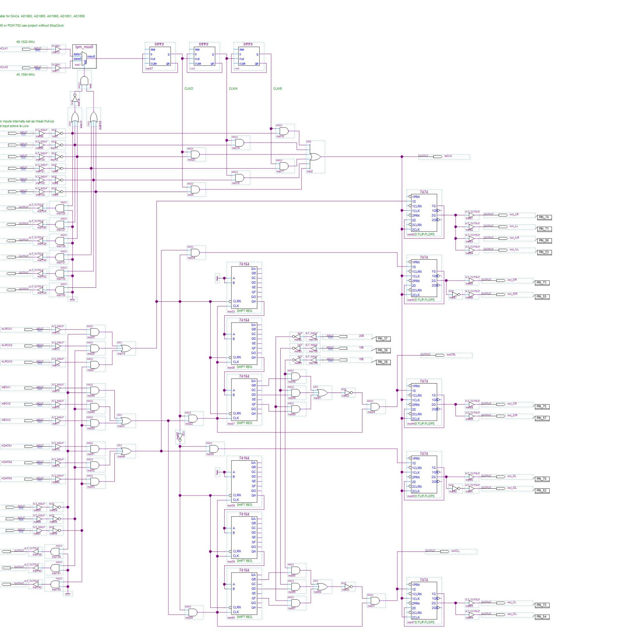

There is the "schematic based reclock" project, which I still have not fully tested 😕
This version is "finished" only for DACs, where standard stop-clock is working without additional BCKs (AD1862, AD1865, ...) - DACs which are latched on LRCK and not BCK. All DACs latched on BCK (PCM63, PCM1702, ...) needs different schematic. You can easily put here some basic schematic and use reclock with it. TDA1540/1 needs also different schematic.
This project needs Quartus 13.1:
https://www.intel.com/content/www/u...design-software-version-13-1-for-windows.html
I tried it in new version of quartus (21), but the schematic based approach is not working good (it is good for VHDL), for schematic based is the best 13.1.
This project is not necessary for the normal functioning of DACs. I don't even know if it will improve the DAC in any way, it's more of an experimental thing. I do not recommend trying this for users who do not know what they are doing, as it may end up with the project not being completed. It will probably be buried here for some student who might later use it in some school work as the basis for something better, he can then share advanced version here 🤣
How the schematic approach in CPLD works, is shortly described here:
https://electrodac.blogspot.com/p/programming-cpld-using-schematic.html
With this "tutorial" you can create own schematic based CPLD for all DACs, where I2S to PCM conversion is needed 😉

@diyiggy It is fully open design so you can feed its hunger with any schematic and it will work also as non stop clock option 🤣
not a code guy, is it easy to supress the non stop clock behavior from the code, please ? I found one for the sim mode for TDA1541A but not for the second most prefered chip to me that is still AD1862 ? (want to try one day post FGPA/CPLD reclocking due to jitter, starting from a clean MCLK to slave, etc, etc.

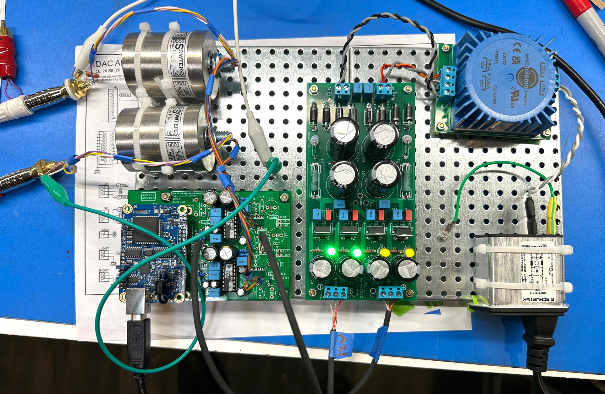

Here’s my newest breadboard -
1862 board with JLSounds USB, Miro’s 78xx/79xx PSU, Sowter 1465 I/V.
Sounds great so far!!!

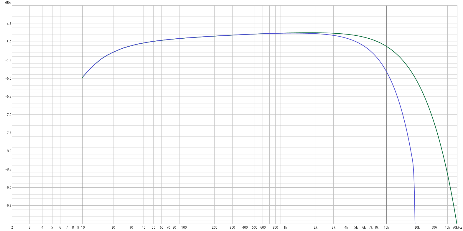

Hi, I’m using Sowter 1495 with 100R I/V resistor on primary side, but when I connect the transformer with parallel secondary 1:9 configuration, the output is low ( about 400-500mV RMS) when I connect it with serial configuration 1:18 then the frequency response is limited and start to drop at 2kHz.
In your case how big is the I/V resistor and how big is the output (RMS)
Have you measured how the frequency response looks like?
Any suggestions will be appreciated 😀

Hi Andy
- the Riv valie of 125 ohm is for output of 5.5Vp-p (about 2Vrms) wuch is for my opinion to high... The voltage gain of the circuit is about 5.5 Vp-p / 0.25Vp-p, as Io = 2mAp-p for all PCM/AD dacs, so V@Riv and imput to the sircuit is Riv x Io.
-A= 22, (minus is indication for phase shift of 180deg...)
so You can use lower value of Riv. with 47 ohm Riv, and 2mAp-p DAC Io, it will give 2Vp-p at the output with lower THD. which is probably better to use with preamplifier...

This model 1945 has main issue of too low primary inductance acording to datas it is 0.72 Hy per each primary coil...
And obviously higher capacitances causing loss in HF...
A lot better model is 1645 with 3 Hy eah coil but almost the same Rdc as Your 1945 model.
there are some simple measurements that confirming differences about L primary
https://www.bramjacobse.nl/wordpress/?p=6233
My plan is: Transformer 1:10, Riv on the secondary
When connected like this, DAc Iout is directly and heavily loaded with huge reactances. From primry and additionaly from transfered secondary side. And losses will be huge. Also it is useful to simulate this configuration against Riv first at primary and compare results...
When Riv is at the output of DAc Io, we also have reactive load componenet as parallel complex componenet but in parallel with lower value of Riv. (In that case it is almost irrelevant internal reactive component, non-inductive etc, of the Riv because a much larger are already present from the succeeding transformer...)
All in all the best way for using a non reactive Riv is
to aply non-rective very low inductance and very low capacitance R @ DAC Iout
then go to low output impedance buffer to isolate ractive component from DAC Ioutput (in that case we have only few pF and no dynamic capacirtance at the DAC output, so rective component is completly minimized.
after thet connect the transformer. Thansformer will have prppper low impedance drive, LF chrs will be much better, THD will better and HF will better too...
then measure with square wave, and RC terminate secondary for riging, use higher termination load.
The another buffer with separate PS after the secondary is na option, this time to mimize influence of the capacitive load to the secondary...
This way DAC as DA system is compleatly galvanicaly isolated from pure Analog domain. As main feature of transformer as isolation element...
