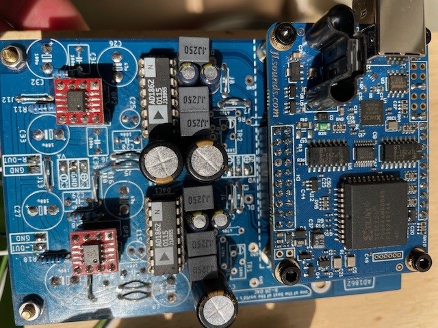

Folks,
Trying to get a new build to play music, which it does not yet. Miro AD1862 w/ JLSounds USB board.
PSU1 works, I can see 5V and 12V at the DAC PCB. Source is PC Windows 10. My first rodeo so not sure it's configured correctly but working on that. PC will play internet radio through MusicBee. I have downloaded the JLS driver from their site and can see that on the PC settings.
Photo of the board below. Caps, DACs and Opamps are oriented correctly. Looks like components are correct per post #1 Miro's blog detail.
With the USB cable inserted in the input, the adjacent LED does illuminate.
Any guidance on how to diagnose / getting it to play greatly appreciated in advance.

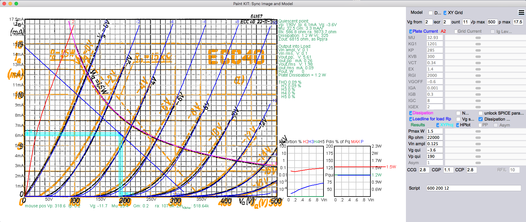

ECC40 is very good triode, and I think that can be sett slight advanced.
I made a spice model prety accurate.
Please take a look at the settings.
Your settings are too low with current and anode (Vak not Vb...) voltage
Also You can use negatv grid bias point of about -3.6V to have a chance to use battery (3 x 1.2V NiMh) or other close standard value different type battery.
OR stay with RC in cathode...
The better settings are dipely inside max values and adopted to 350V of Vb.
Other values can be read from graph.
Vin=0.25Vp-p
This is for Riv=125 ohm for Idac=2mAp-p.
for
Vout=2.1Vrms or 5.95Vp-p which i think is more than needed.
In general it is 120 ohm of standard value...
Output impedance is about 7260 ohm, which is good for tube next devices with big Rin values
But can be unsuficiant low for solid state succeding sections with lower input Rin...
A buffer can be welcome.
There is one thing left
To check with PSpice specific values of Ck.
I will send latter...
I am posting a spice model t+for ecc40

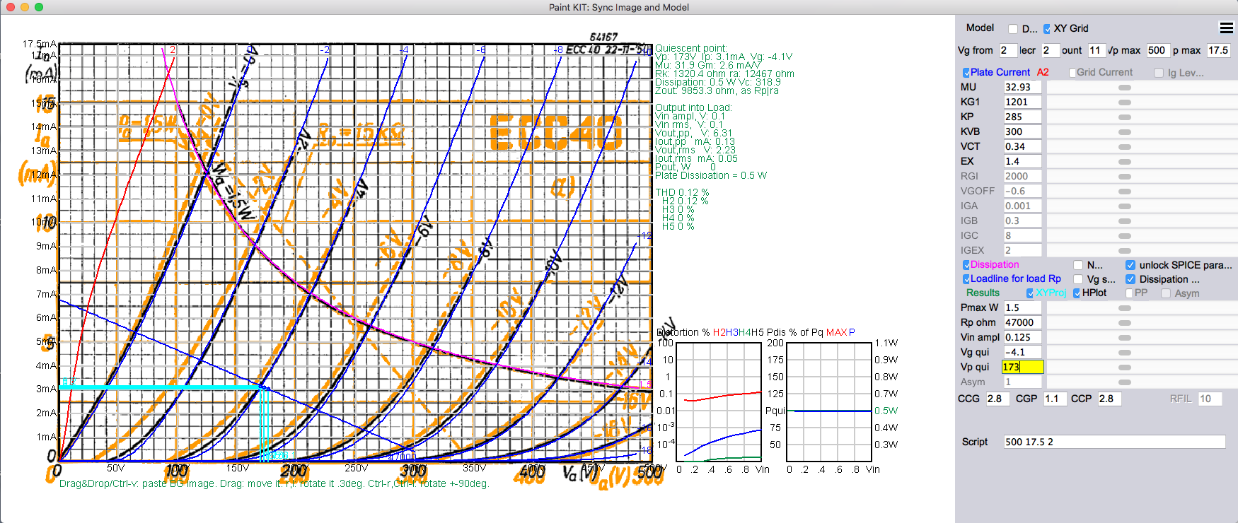

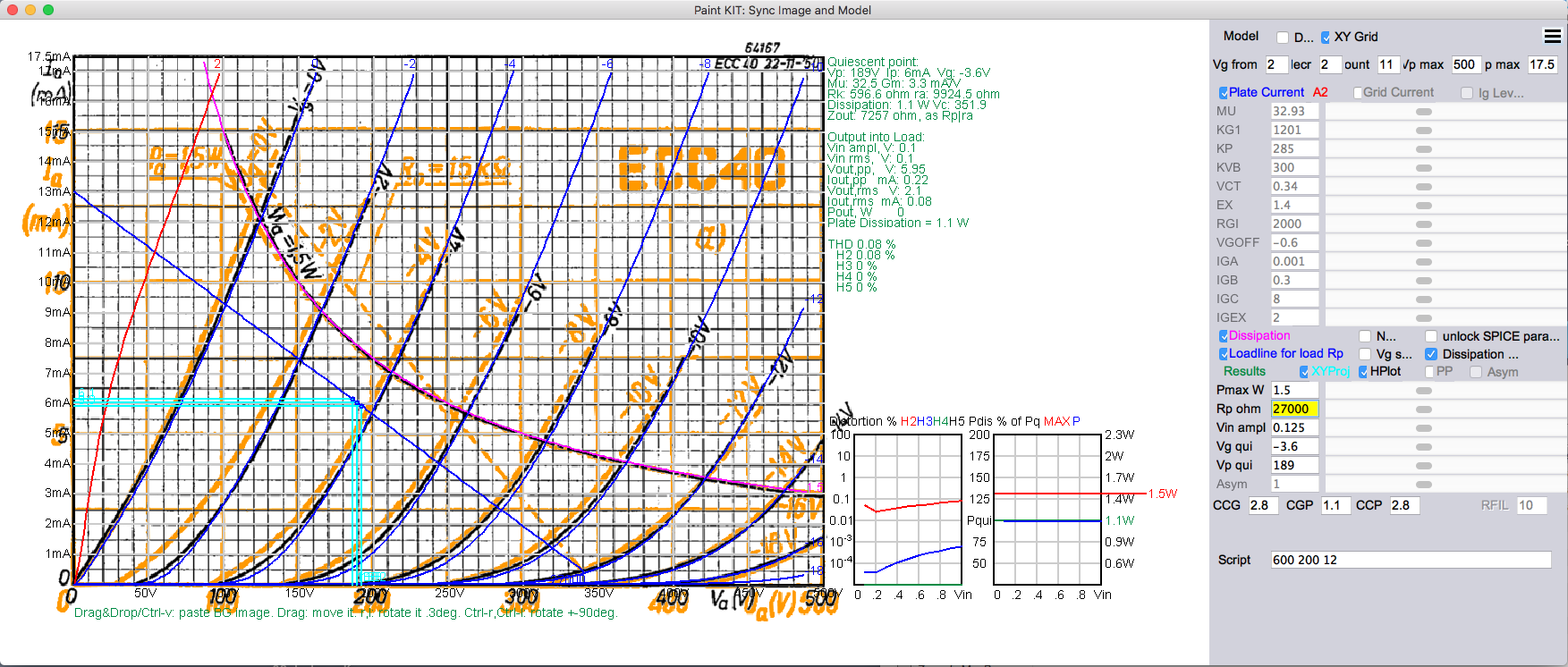

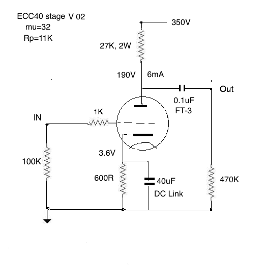

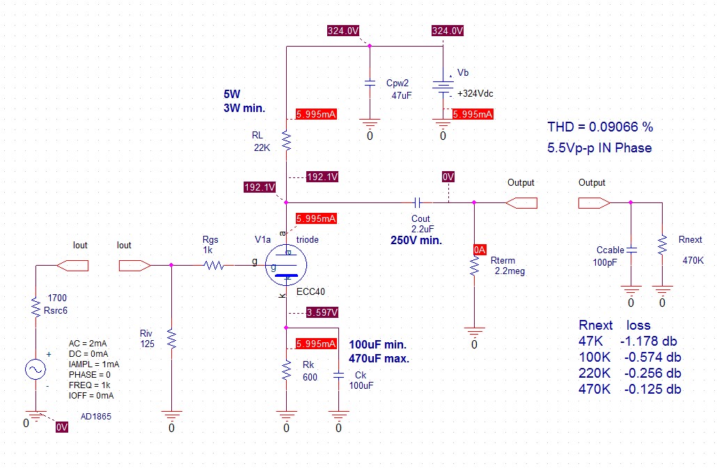

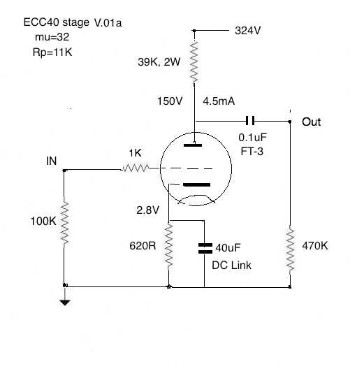

Hello Zoran. Thanks for your input and calculations. I think the ECC40 is worth some good input. So the schematic would look like the attached one. As you know, for a fixed B+ the anode resistor gets smaller as the current gets bigger. So for your operating point we have a 27K anode resistor instead of 47K. I have generally found that 5x the Rp of the tube gives the cleanest sound. As you can see, that reduces the current to around 3mA.
I can see benefits in more current and I can see benefits in a larger anode resistor. Choices! What do you think of meeting somewhere in the middle, like 4.5mA current? Note that my B+ is approximately 324V - this is my standard B+ PSU. A higher B+ is always nice but that would mean a new mains transformer. So that remains theoretical for those starting a build from scratch.
Reactions: Seavan
The goal is to have as high Anode voltage as we can, no the high current by force, because the tuve is voltage dvice not current device as BJT...
And in the most linear region as we can. Because of minium THD. Load line is also in function of THD.
All that inside the borders of maximum values given by the manufacturer.
Yes it would be better with higher value of PS that You alredy have 324V.
But I can suggest to replace R with L in the power suply if the R component in RC filters exists?
With lower Rdc of L total Vb will be higher?
Here are optimum settings for 324V
THD=0.09%
Vin=0.25Vp-p Vout=2Vrms, Riv=125ohm for Io=2mAp-p
RL=22K
I will model the Ck value in pspice and post...

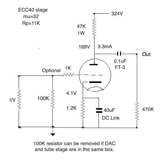

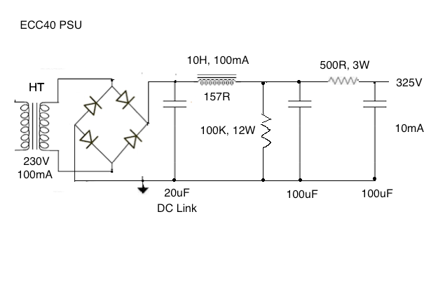

Hello Zoran. Here is my standard PSU. I use a 230:230V toroid and SIC 1200V diodes. There is not much voltage to be gained in the PSU. I think 22K anode load is too low for this tube. It may look good in theory. But I would have to listen to it - from experience of different values of anode load I would want it to be around 40K somewhere.
It would be possible to use a plate choke. I have a pair of amorphous ones, good quality, but I still prefer the sound with a resistor load so for me that stays. Others may want to use an active load or a plate choke, it would be their choice of course. I can only suggest what sounds best and most natural to my own ears, listening to acoustic instruments and voices. For sure, you can get good sounds out of an ECC40 so it's a tube worth looking at.
Andy
There is no point in this case to exchange R of 500 ohm with say another L of 157ohm Rdc choke.
Because the volyage will be with 6mA consumption only 2V higher... Leave as it is.
But
Because of the solid state rectifier used,
You can increase first C of 20uF value, to 100-220uF.
To have better ac filtrtion?
In some cases that R bleader can make the sound somehow "compressed", try it without that R.

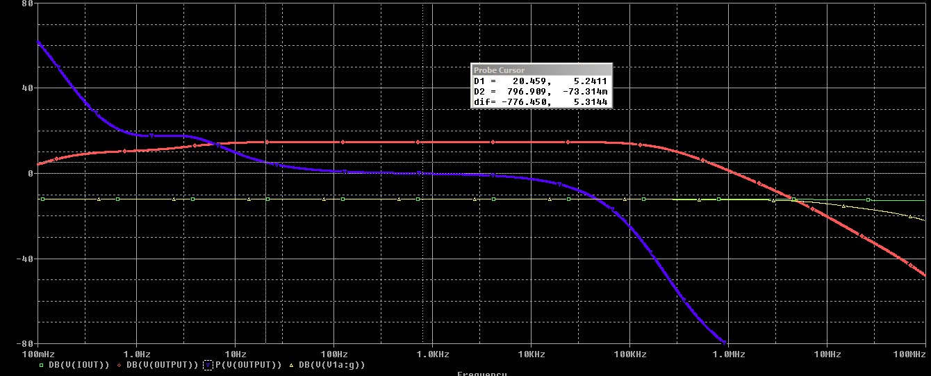

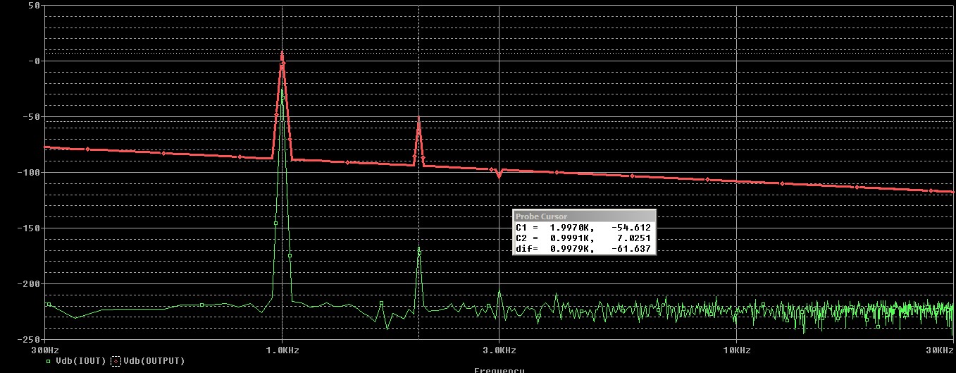

OR make some circuit with realy to close R in PS circuit to discharge Cs after power off?
There is some spice results for specific 324V Vb.
Very low THD 0.09% with 5.5Vp-p output and 125ohm Riv will be lower for lower values and lower output.
Output resistance is higher so the absoute minimum of R next input value is 220K for -025 db loss.
Any lower value will additionaly give limiter-compression effect in sound...
So for universal use, tube bufeer is the solution.
Value of Coutput is crucial to be higher for proper phase and response 2.2uF/250V is minimal value.
Type is from personal preferences...
2.2uF for 470K Rin next stage
4.7uF for 220K Rin minimun next stage
Values of Ck are critical too for the proper phase response, and they are from 100uF min to 470uF max.
Rgs can be even lower from 470 ohm to 1k max.

Hi Zoran. For the PSU I could increase the size of the first capacitor but it wouldn't make much difference to the output voltage. I like to have a DC Link as first cap because it sounds better than electrolytics. There's always a method in these choices!
The bleeder resistor is there for safety reasons as you know to discharge the B+ voltage. It's a simple way of doing it. I haven't tried more complex alternatives. I could try without it and see if I can hear any difference, that could be interesting, but I would put it back for safety reasons. Safety first.
Some other choices -
  • 470R grid stopper would be fine
  • I'm not too happy with 22K anode resistor, I would want it higher
  • 100uF cathode bypass is OK, but my preferred capacitor is DC Link and that would be a big size. Electrolytics will sound worse than DC Link caps. I did a big bypass cap shootout and the only other choice that was nearly as good as DC Links was AudioNote Kaisei in parallel with Elna Silmic II, like 47uF + 47uF or 100uF + 100uF. That's another way to get higher values. But cathode bypass caps are quite audible and have to be chosen with care. So I stay with DC Link caps and use what I have. I have some 70uF ones but they were too tall for the case I used. After that they get expensive as well as big.
  • This stage should go into a next stage of minimum 100K input resistor to ground. In that case 0.1uF is enough. Again, the quality of sound of the capacitor comes first. Coupling caps are very audible. I use FT-3 teflon caps. They are again large in size, so 0.22uF would be possible but not much more, and really 0.1uF is enough. Yet again, larger would not fit in the case and I would not use larger caps that were not teflon. I have tried 1uF KBG PIO Russian caps and though they are good they are not as good as FT-3. So I stay with teflon here.
  • Yes, a buffer stage would be needed if feeding a solid state preamp, like a cathode follower. It would degrade the sound but it would be a choice. I have a valve stage so 100K input works fine.
I have made all these choices by listening to the alternatives and doing a lot of A-B tests. But your simulations are very valuable and constructive - many thanks for taking time for this. Your 120R I/V value looks good.
