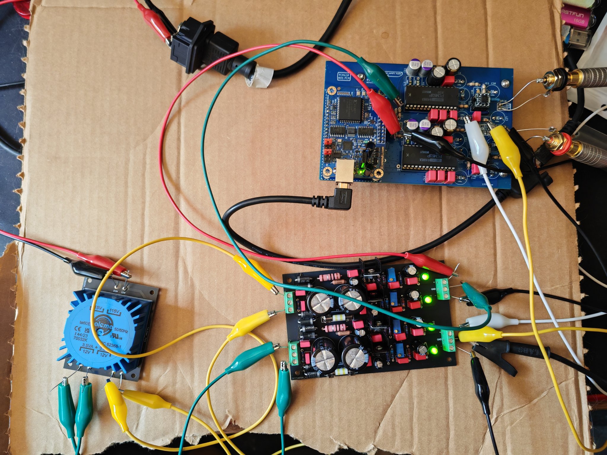

Hello everyone, I'm about to join the miro DAC club! I got this populated miro PCM63 board + the jlsounds board from @zoom777 . I made my own more-compact version of the PSU2 and stuffed that today. I got it all wired up, and it's working great! All that's left to do is order a chassis and to stuff my +/- 12V PSU2 to power the AD797 I/V stage separately. Here's a picture of the pre-chassis rat's nest.
@carlman14 Thats how a DAC should look like, no need to case up, leave as is 😉
Zoom builds a solid DAC, his work is very good. I really like the PCM63, musical DAC. Nelson Pass used them, can't be that bad...
The board is indeed very well put together. I chose a PCM63 build because a while back, I bought a pair of brand new K-graded PCM63s from ebay for a grand total of $8. I was always skeptical if they were legit despite looking real, and I'm glad I finally get to test them. They are in fact legit! Probably the best deal I've gotten on something audio-related.

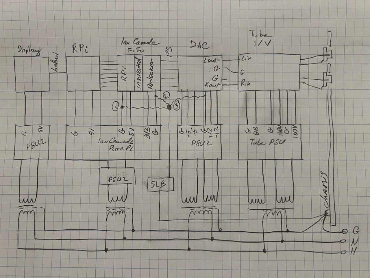

Its time to start putting the DAC in a nice enclosure and I am thinking through the grounding map. Based on this article https://www.diyaudio.com/community/threads/audio-component-grounding-and-interconnection.163575/ I put together attached draft. I think analog ground should only be connected to the ground of the analog power on the DAC PCB (3). The digital ground I think should be connected to the ground of the FIFO's 3V3 (2) and to the ground of the FIFO's 5V (1). IanCanada's FIFO provide galvanic isolation, however, I am not sure if the ground is isolated as well. If it is, the 5V ground (1) probably should not be connected to the digital ground. The PurePi uses LiPo to power 3V3 circuits of FIFO. I don't think RPi and display need to be connected to the digital ground. I think the output RCAs should not be connected to the chassis.
I am sure I made mistakes and I would greatly appreciate your input.
