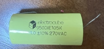

I replaced the 10uF (C1/C3) with 1uF Electrocube 950 - an inexpensive alternative that I liked years ago in my tube amp. One of my test records is The Rainbow from Spirit of Eden by Talk Talk. In the beginning of the composition there are quiet, gentle sounds. For the 1st time since I sold my Sony scd-777es, I can hear creatures (here you go - make fun LOL 🙂 ) and their location instead of noise. I also like the tonality of acoustic instruments and voices. However, I think I hear some loss in the low range. The impedance of my pre-amp is 40k. What do you think is the lowest reasonable value of the C1/C3? I assume that I can increase RLOAD?
@Seavan I think depending on the lowest frequency your speakers can produce, you calculate the LPF 'knee' cut off point - small speakers need low uF, massive towers need higher.
Google LPF knee calculation for speakers
First thing I found but you get the idea 😉
https://pieterkdevilliers.github.io/audio-filters/low-pass.html
Thank you @passive420 , so 1uf/10k -> 16Hz at -3dB. I think switching from 10uF to 1uF can make an audible difference at the lowest region - like contrabass where I think I can hear a difference. My speakers frequency response 45Hz-18kHz (probably +/-5db) but I think that our ears easily adapt to frequency response and we can hear much lower than the spec. I will try doubling 1uF and see if it makes a difference or it's the cap quality. I need to try other more expensive caps after I play with a better tube and IV resistor. Fun!
Hmmm... I havent read your previous posts so I don't know what all this is intented for, so what follows may be more confusing then helpfull but well...
It is not just "-3dB at 16Hz"...
If you look at what is happening you are cutting the lower frequencies but also rotating the phase etc., many things on the net explaining all that. So quite an impact and that not just at "below 16dB".
Your high pass filter isn't perfect and it will still have a "say reasonable" impact at several times Fc (in theory it is infinite). Depending on your exigence, it is common practice to chose Fc from 5 times to 10 times below what the system can deliver. Very broadly and roughly, 5 times you usualy don't have to worry really about its inclusion, 10 times you can ignore it. Your are at "3 times" (Fc filter 16Hz vs LS Fc 45Hz, albeit at -5dB) , for me that would be a tad low not to have an impact on 45Hz... not a great thing especialy if your response is already weak there.
If I would have 50Hz capable speakers, which isn't that low and where still quite a few instruments can play, I wouldn't want elsewhere in the system to have a Fc below 10 or 5 Hz. Me, I would chose 5Hz as common practice addressing many needs plus let's not forget that the high pass filters add up (in a more complex way depending on the filters, Fcs etc). In a simple case, if your speakers have a response such as -3dB@50Hz, and you put a filter with -3dB@50Hz in front you will end up with a response of -6dB@50Hz... quite a drop.
In your case, you are likely to have another dB drop at 45Hz but generaly speaking you are helping your speakers dropping further response a bit below 100hz... Depending on how you use your speakers that may be OK or NOK, you to decide.
As your speakers already don't have a high Fc, I would depending on size and availability at least aim at Fc around 10Hz, but then that's me (i chose below 5Hz for most audio applications)
I hope this helps
