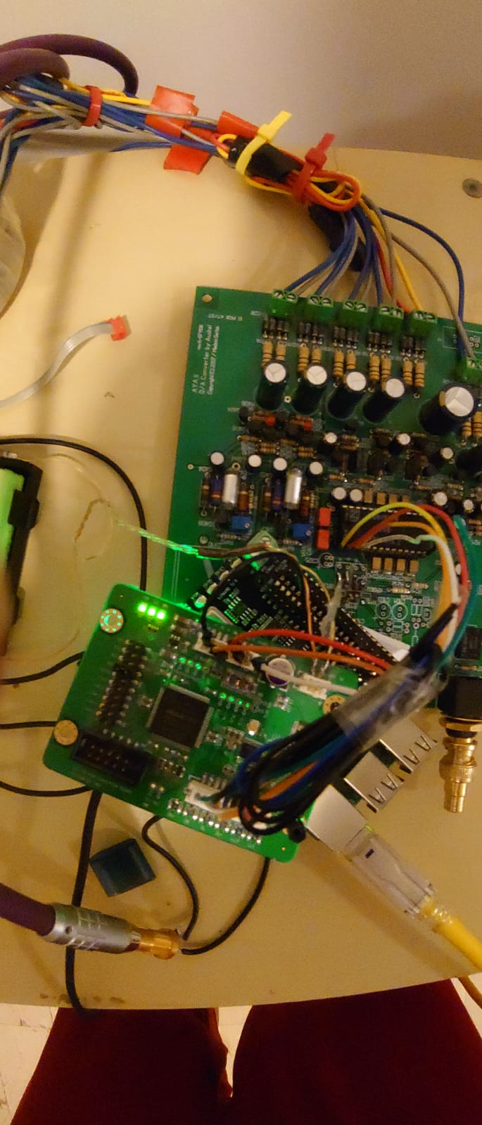

you would be surprised to see how much RF noise have picked up these wires for analog supply, routed over USB board.

Thanks for the advise and I will definitely try to shorten the wire later. As previously, the voltage drop-out of LDO, I can only provide 4.7~4.8V to AD1862. And I have several lifepo4 batteries on-hand, which urge me curiously to try if any sound different if battery power supply.
My friend told me the max voltage input for 74HCT164 is +7V, so I luckily got no burn anything.
