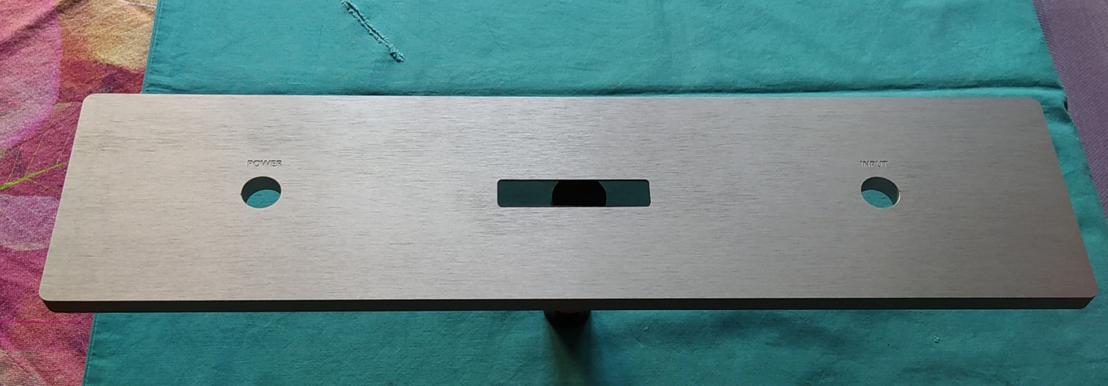

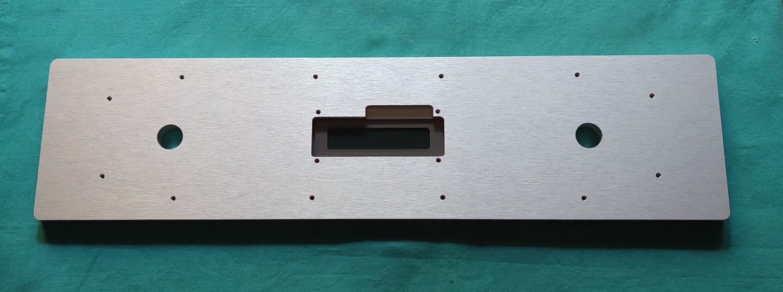

A friend snapped up the front panel for the PCM63 DAC. I don't have time to assemble it right now, but it will look really cool. A large DAC full of transformers and various other innards. 😎
