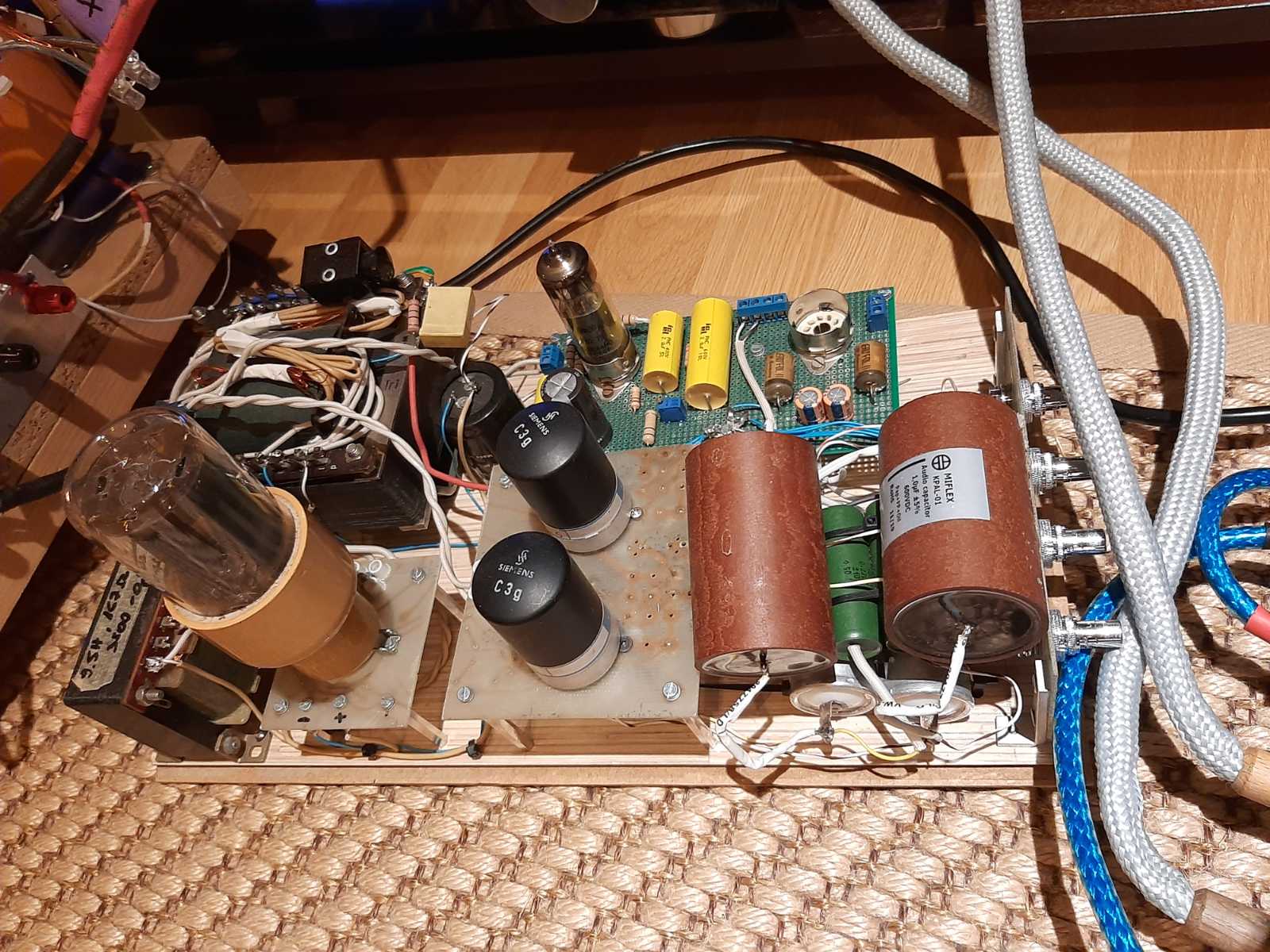

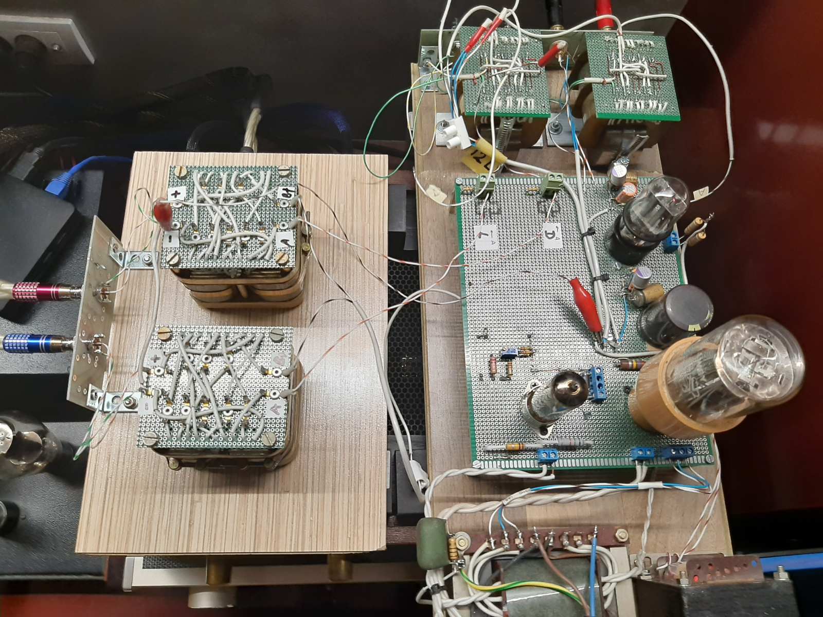

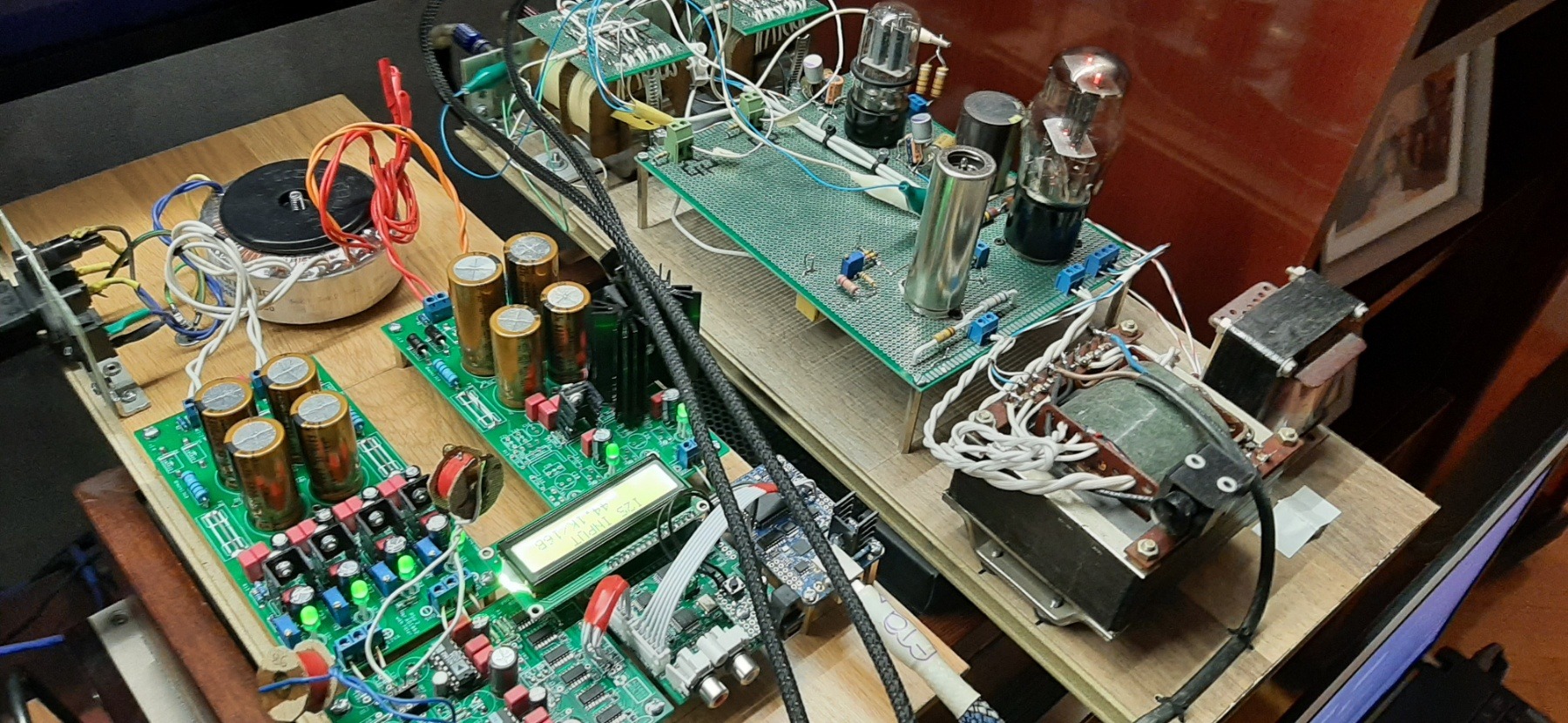

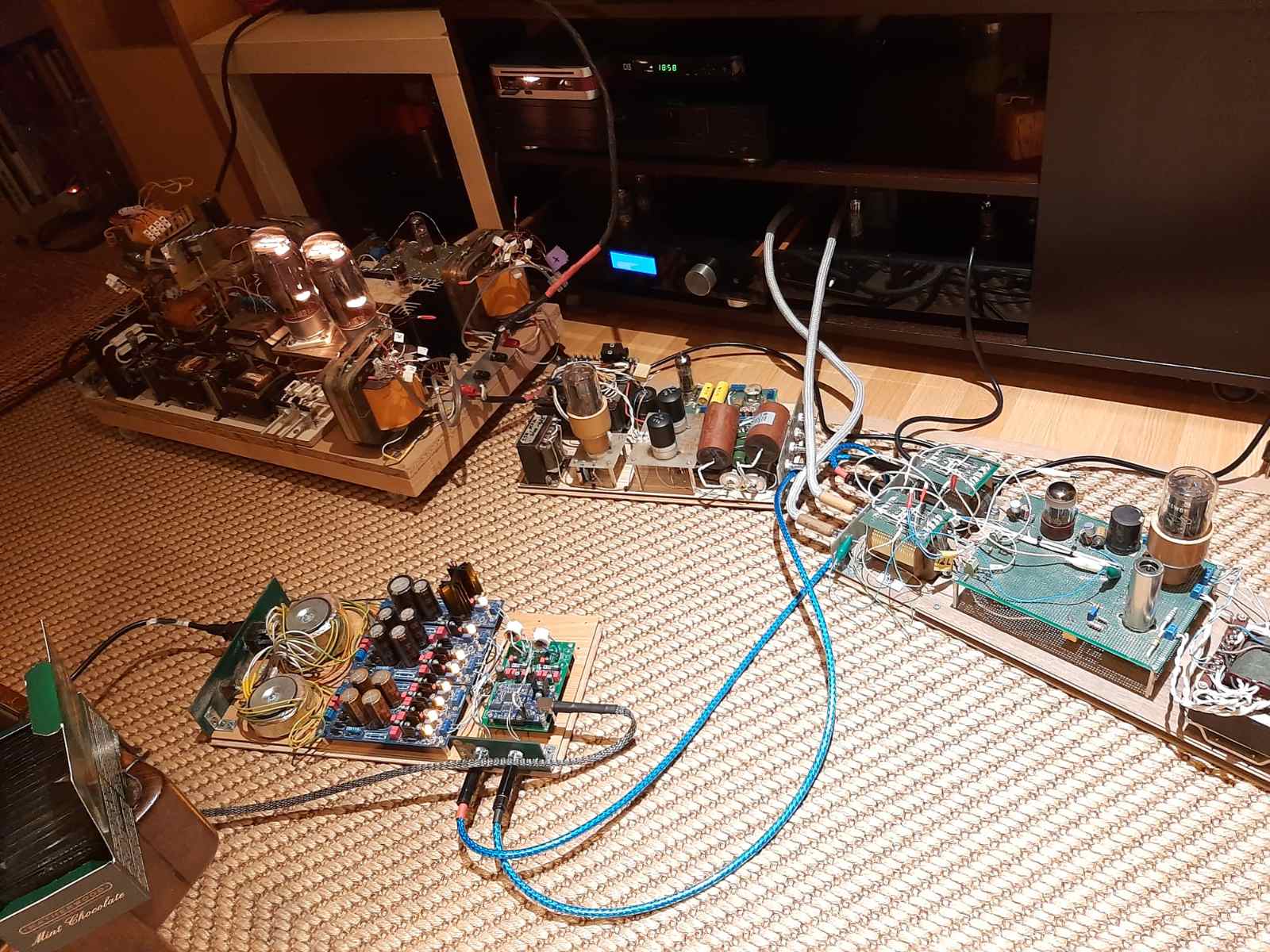

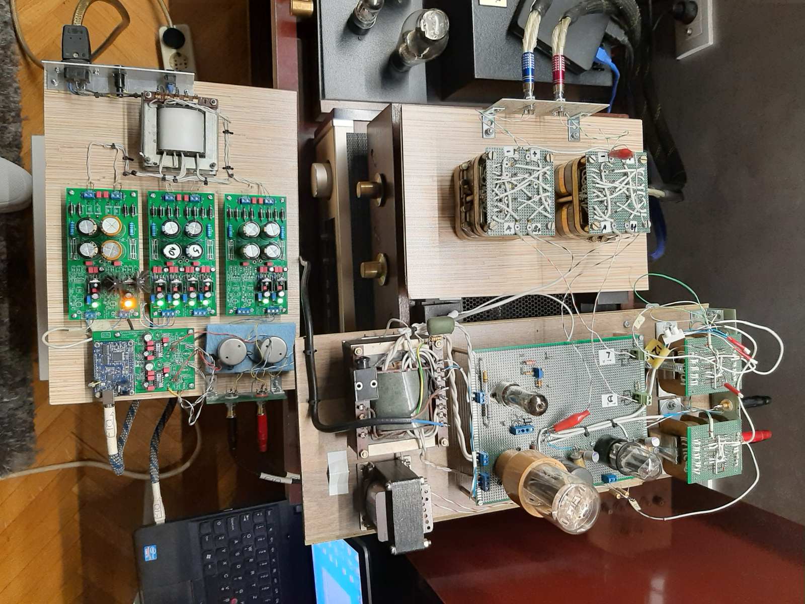

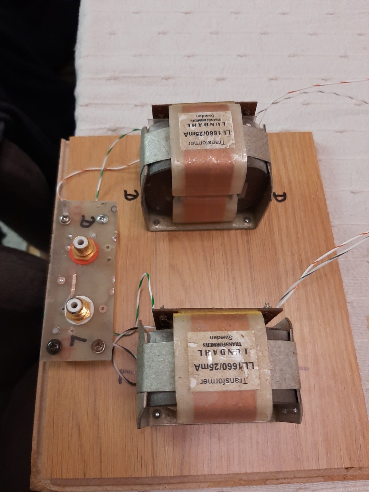

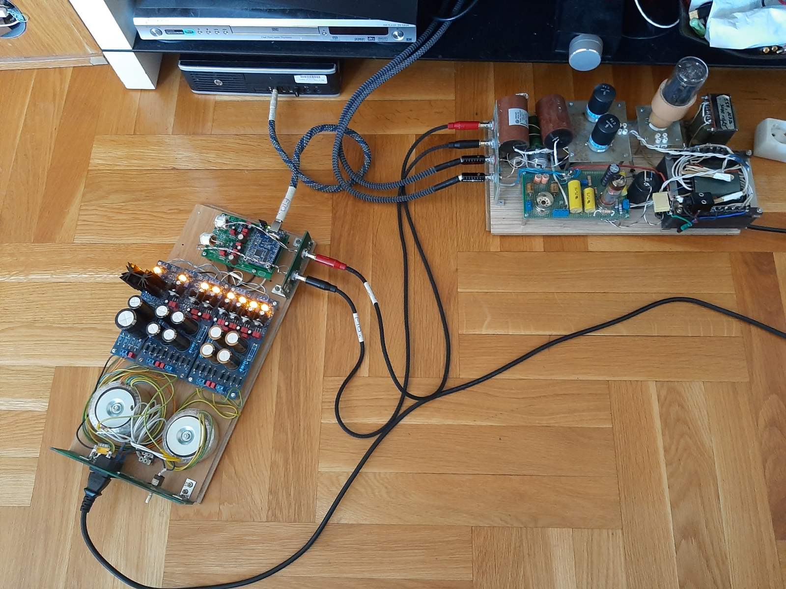

As one of the cople people who have played around with the Miro's DAC I recommend you try tube output. We tried c3g, 6sn7, 6n6p and with adapter 7n7 and ecc88 with transformer and capacitor as output. This is also the order in our opinion. So C3g+OPT, 6sn7+OPT ...Have you got a pic of your tube stage here, did you want a better IV before the tubes?
So put any tube drive of an amplifier with capacitors as outout and it will be more beautiful than the OP AMO outout.
I have an hybrid E188cc (that beats them all as a quiter ecc88 it is and better half matched)for the tda 1541 setuped a laThorsten. Alas expensive OT or very expensive choke are too much for my wallet...
I really don't think a reputable manufacturer and designer name would say it just because of the marketing. It is going a bit too far. As for designing, if it sounds better, who gives a damn about a little bit more trouble, they had a spot to fill with a quality product for high end niche. It most definitely boiled down to what the designer found to sound the best for his/their ears and for the market they planned to release it to. Not a cheap device 😉
Too complicated! Go with my (Grunf) design with ccs tube and no OT!!! 😉As one of the cople people who have played around with the Miro's DAC I recommend you try tube output. We tried c3g, 6sn7, 6n6p and with adapter 7n7 and ecc88 with transformer and capacitor as output. This is also the order in our opinion. So C3g+OPT, 6sn7+OPT ...
