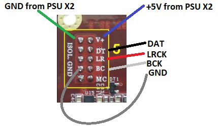

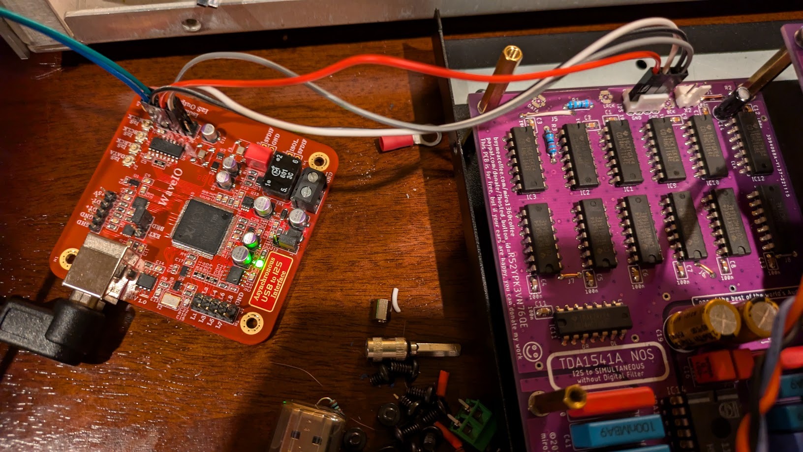

Thanks @zoom777, @rehanabid, and @diyiggy for your tips, they were very helpful. Below are some pics of how I have the wavio connected to the TDA1541. I did have it mounted underneath the miro power supply, as there was ample room there. I took it out for ease of access to test further, after playing with it for a bit I was able to get sound at the outputs of the dac it's very distorted, music sounds like it's clipping badly. I am wondering if it's because the waveIO is not properly mounted, I will have the opportunity to test further tomorrow night and mount it on standoffs on chassis.
the waveIO does have ufl pads, though the TDA1541 dac does not have corresponding GND ufl pad. I can try to purchase and mount some ufl pads on the TDA1541 to see if I have better luck there. Is this the correct part? https://www.electromaker.io/shop/pr...UR53uQTFY2egUiKuPkiGkbo4gJSISXJMXUaPcnOhnx6ug
each ufl pads are connected to ground. Only one side of an uf-l pad is the signal input, the three others are going to ground (so you have to know to solder it)
Does the W . I/O already worked with another dac ? Try any VDC from an isolated reg from 3.5V to 5V to check if it is not a gnd loop problemo.
Have you tried to feed the W. I//O main power plug with a clean 5V in spite of feeding it from the USB (read the datasheet for the jumpers and re read the datasheet).
there is only one size, so the link is ok. you need spares too and more cables than the three needed cause it is fragile.
Reactions: arteom

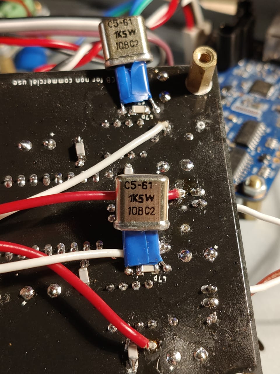

I installed in I/V the foil resistors 1,5K instead of metal film today. Also I have the other Dac with tantal 1206 smd also in I/V. Interesting - what would be better? I think the 1.5 is small value (for volume) and need to increase.

I had not verified operation of the waveio with another dac. This is where I had hoped to first to put it to use.
@arteom Did you connect the +5VD power supply for DAC? (pin X2) 🙂
In computer configure the sampling frequency of that card to 16 Bits / 48 kHz
It should work without problems 🙂
So I did try with another power supply supplying the waveio with 5v to isolated v+ input. With x2 from miro psu connected to dac x2, but miro psu turned off, the led for x2 was coming on and I was measuring some 3v across positive and gnd of x2. I have since disconnected x2 from psu to x2 or dac. Last I looked at audio settings the sampling bitrate was set to 32 bits. Will try asio drivers tomorrow.
@arteom set the sample rate to 24bits instead of 32, I did share my experience with bit rates and different DACs (I think AD1862 and TDA1541).
I experienced this kind of noise from the DAC (AD1862) when the bit rate was set higher.
Connect Wave to supply at X2 both +5v and the ground.
Also check a proper connection between WaveIO I2S pins and I2S connector on the DAC with a multimeter, my guesstimate is that you should get "proper sound" when you set the sample rate to 24 bit and lower.
Reactions: zoom777 and arteom
