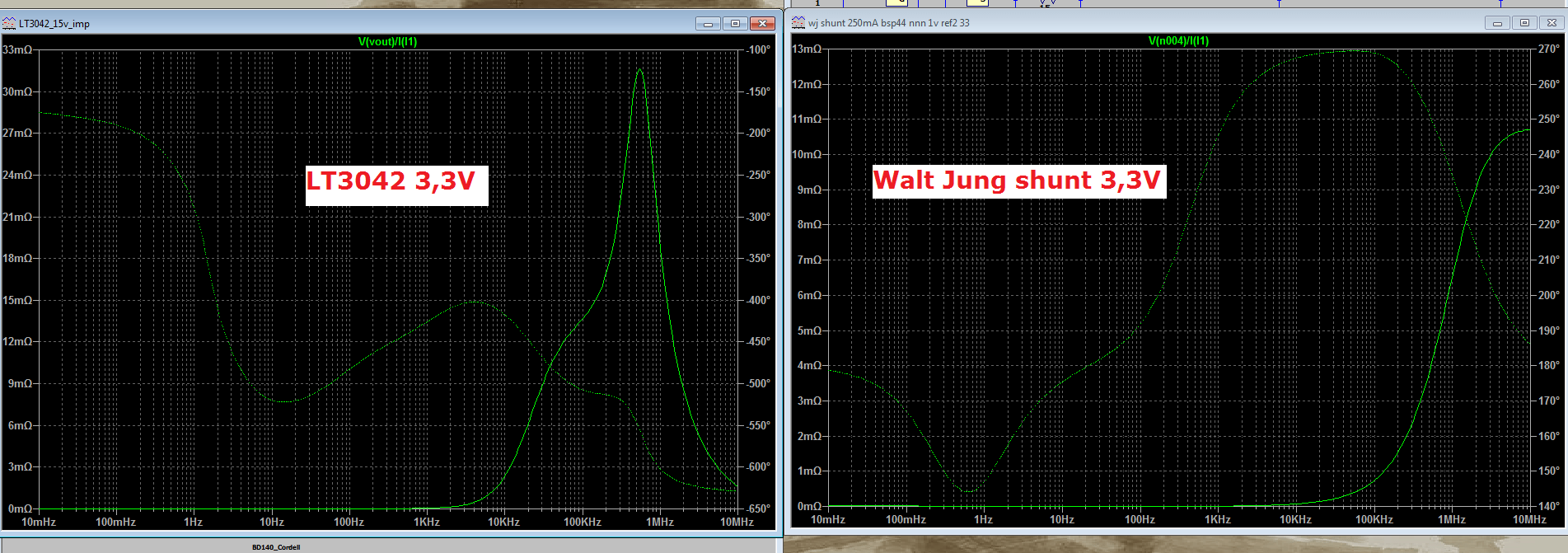

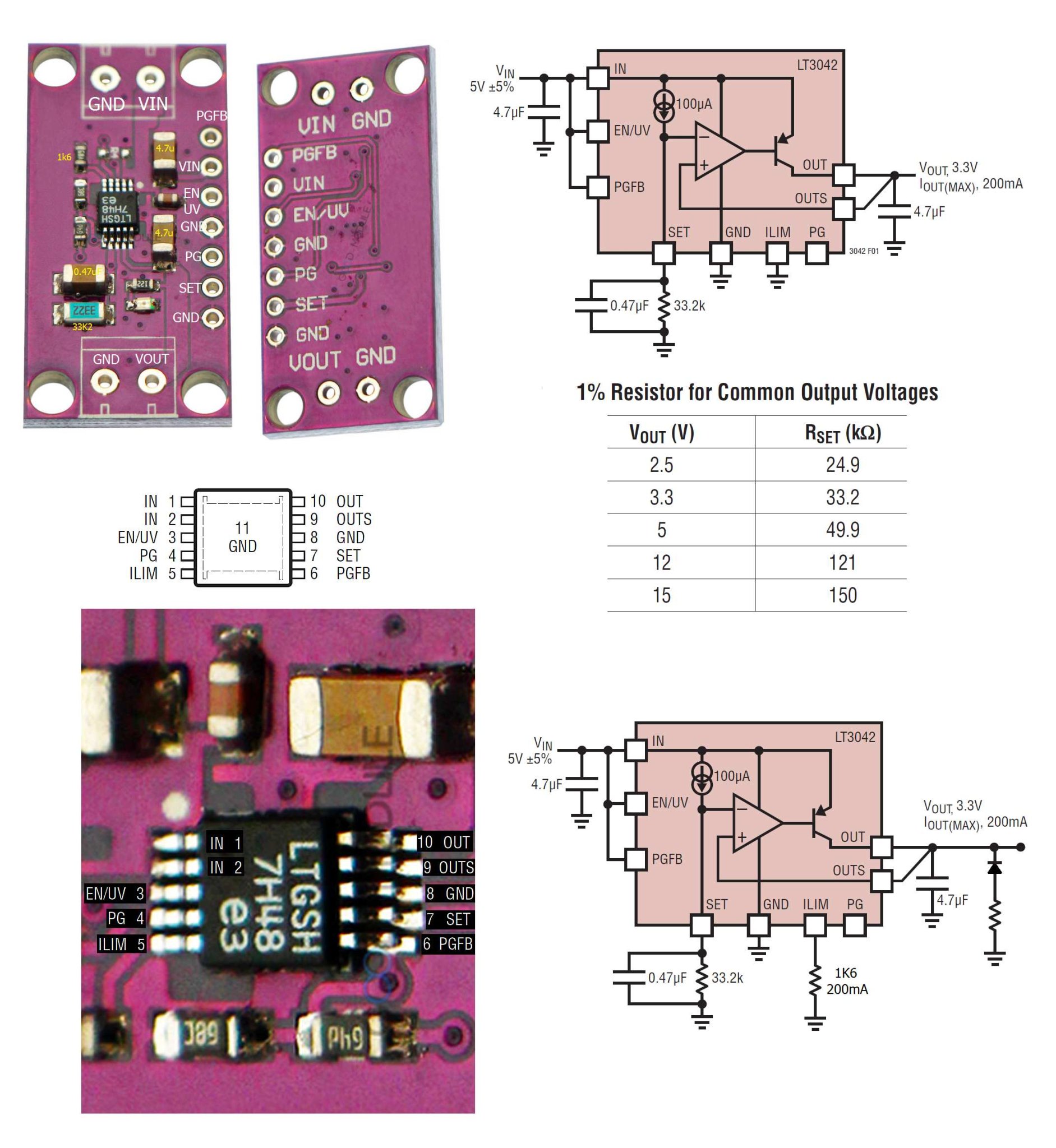

Grunf, I am sorry to say but your simulation of that LT3042 circuit is terribly off. I can imagine many causes that you are doing wrong. I can simulate close to what I can measure, instead.

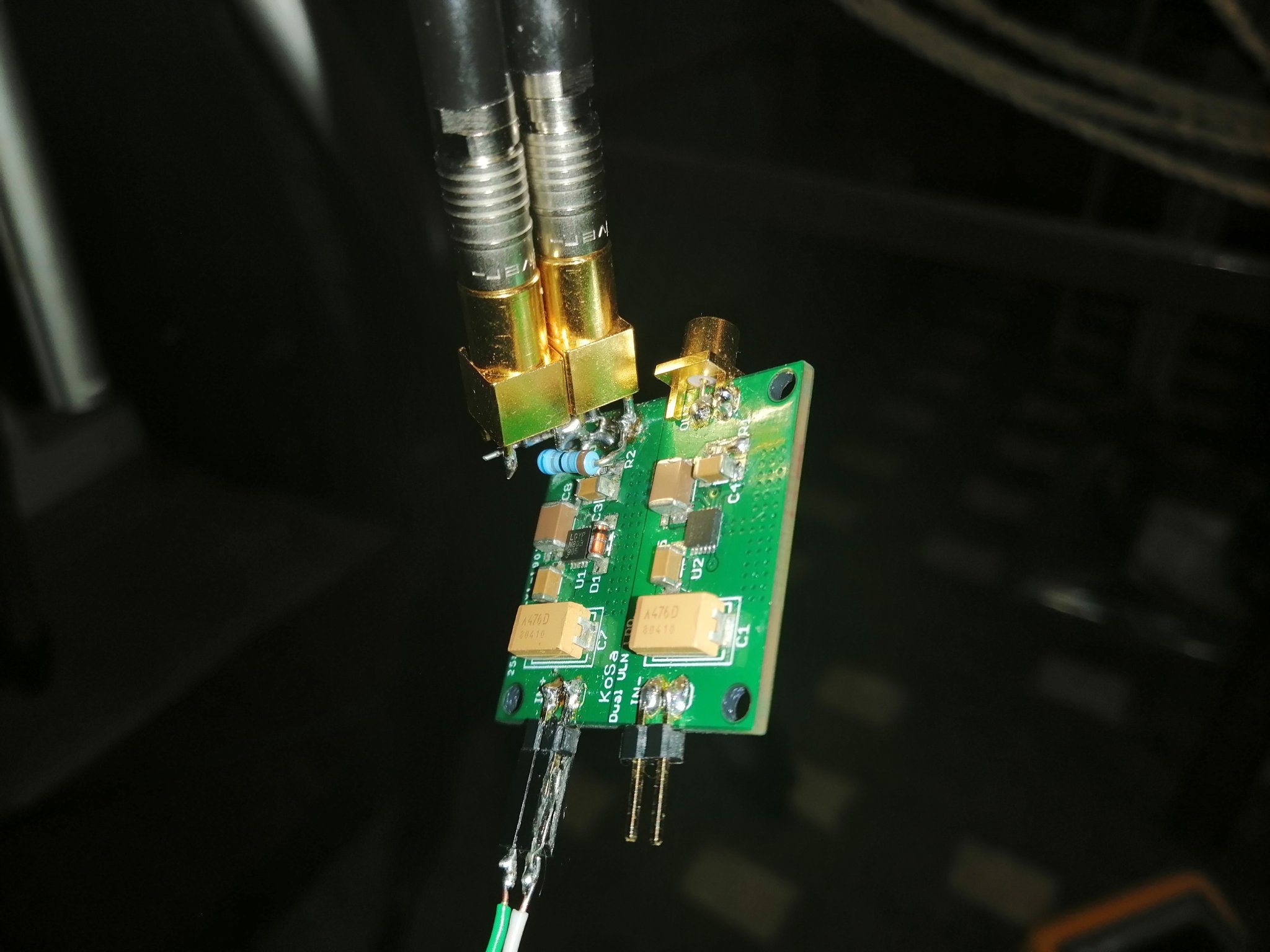

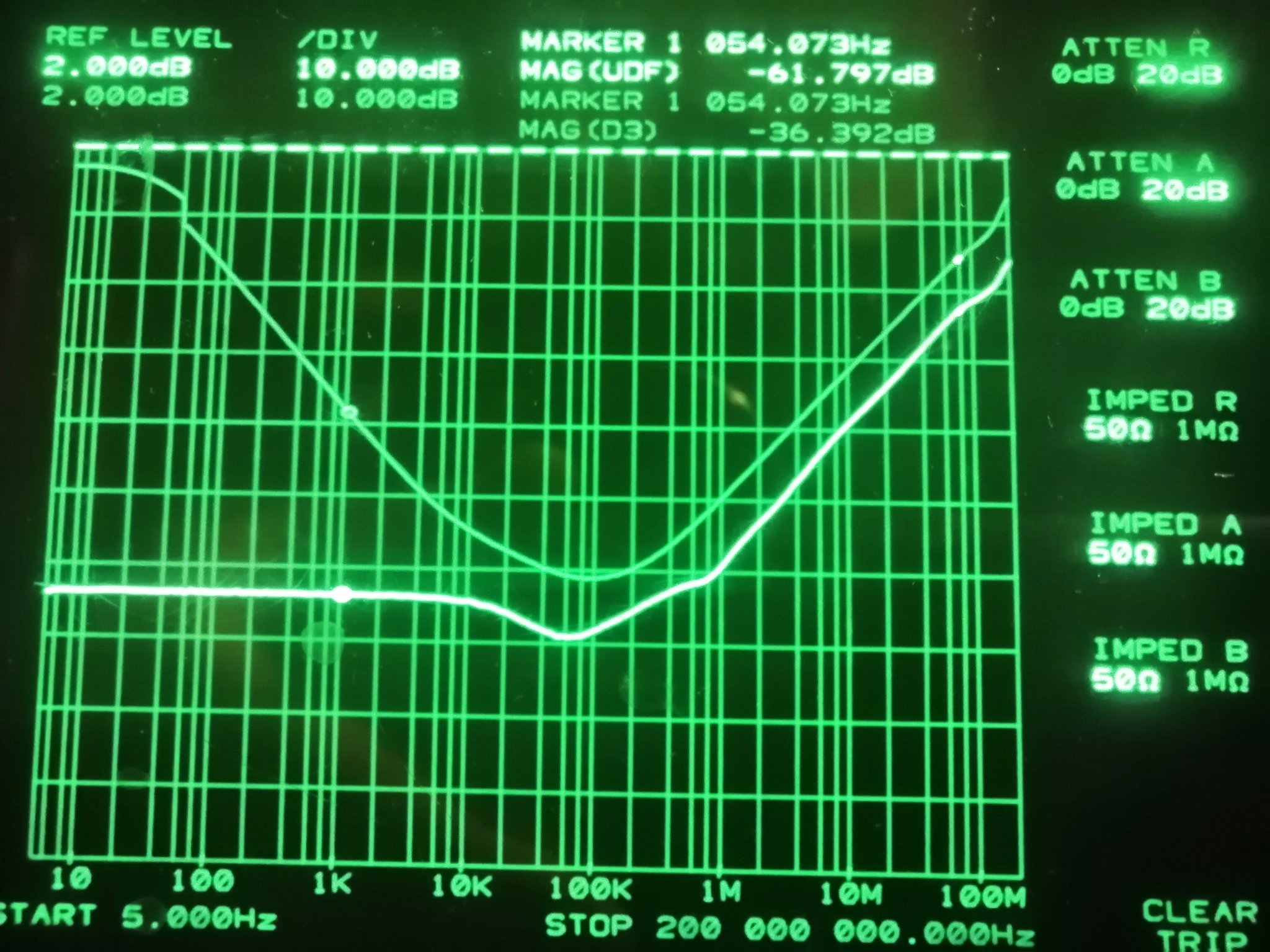

So let's confront your simulated LT3042 impedance curve against my !measured, real life impedance curve of my LT3042 regulator. The impedance at the lowest point (bottom of the curve at ~100kHz is at 7mohm, and it is still <10mohm at 1MHz and a bit above)
The upper, fade out trace is the output 10uF MLCC capacitor impedance alone.
It needs a minimum care to bring out datasheet performance, (and even more to be able to measure it)

And than not to forget PCB track resistance, which easily adds in the 0,0X Ohms.
Therefore sense connections up to mm's from the load help.
I'm using 9 Jung-Didden superreg's with sense connections: everywhere I have a flat line on my scope, even the digital power pin's right at the AD1862. Had a review last week with a person who has a lot of listening experience on a lot of systems, he was really imressed when I compared back and fort with my (now in unuse) Bluesound DAC.

On an experimental point of view, IMHE, I didn't like LT30xx family too, have a poor experience with it on digital clocks, testimonied long time ago here about that on oldest IanCanadas clock boards.
I prefer the expensive AD7x or TS7A families. I am not sure discrete to be always better. Layout is important too as passive parts, when you have sorted out the minimum needs (impedance, noise and so on). There are also alas always sonic dependancies when you check with listenings according the rest of the system... Something than makes us all humble at the end 🙂 as it is not easy to rule or there will not be forum for that.

Unfortunately, I get the same thing if I use the original LT LT3042_DC2246A asc file, so I think there really is some problem with the simulation, not my fault.Grunf, I am sorry to say but your simulation of that LT3042 circuit is terribly off. I can imagine many causes that you are doing wrong. I can simulate close to what I can measure, instead.

It was suspicious to me too and I get a similar result with ADM7151 in LTspice.
I know that the LT3042 and ADM7150 which I used in my DAC before are excellent regulators but for digital they are better shunt regs regardless of their greater dissipation and complexity. Whether it makes sense to complicate the design so much with shunts is another story.
I think it would be a good exercise to rectify this discrepancy, for better 'public' understanding here..
May I ask at what load current do you execute this simulation?
On the photo of mine, You can observe a parallel load resistance. My measurement had been done at 50mA standing current. You must establish a minimum standing current for these regulators, to perform as designed.
In my experience, if you neglect this than You get the peaking that you show..
Not my experience. Simulations or datasheet do not point to that either. In simulations there is a slight bump in output impedance at about 1MHz regardless of load although not necessarily as high bump as in grunf's simulation.You must establish a minimum standing current for these regulators, to perform as designed.
Here is another measurement of output impedance.

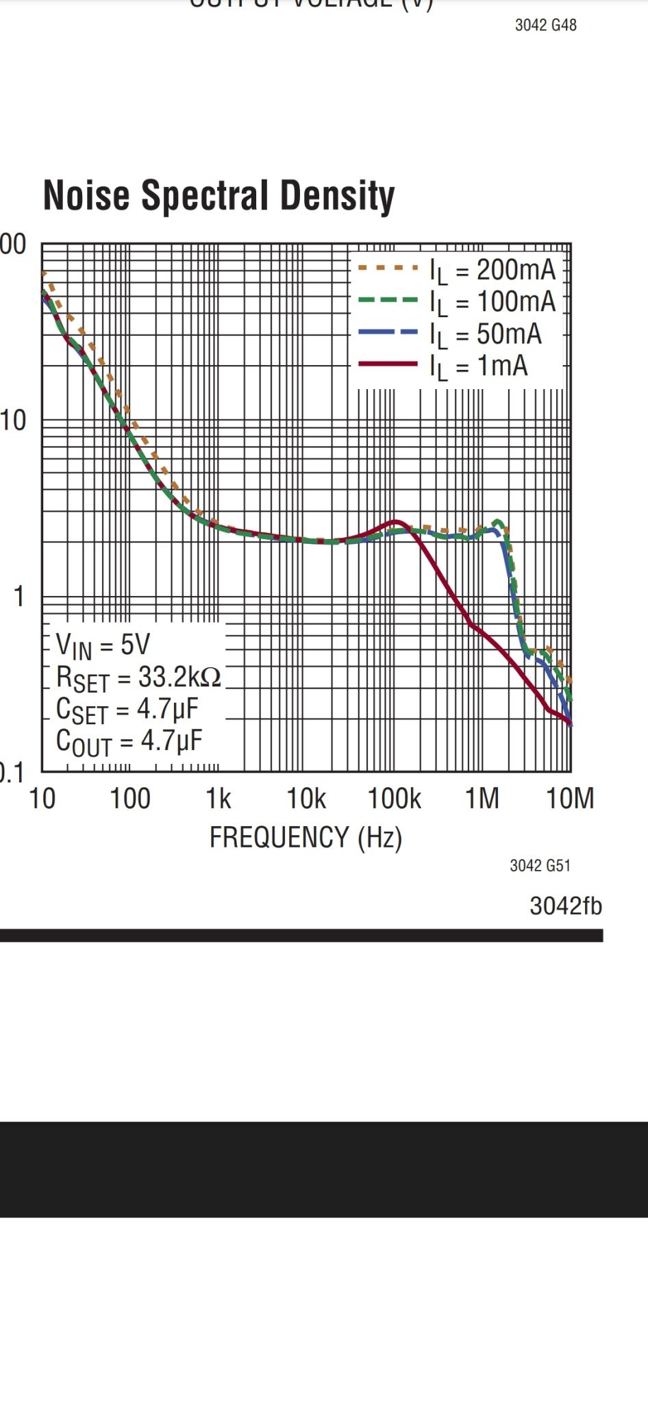

all the datasheet curves had been taken at 200mA /500mA load current. (and no output impedance measurement)
The Cocolog guy is fantastic, I had followed his blog closely.
In my measurement i could not be so precise, the floor flattens out much higher than the micro-ohm levels he releived.

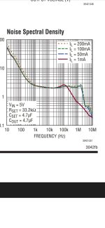

There is a hint in the datasheet about the useful bandwith vs load current, and it shows that 1MHz is only reached at >50mA load current & above:

Do You remember what reference filter value (the bypass cap on the voltage setting resistor) had been used? What type? That has quite an influence on the low frequency noise of the regulator.Must have missed this. At the time of the 3042 fever i felt i was the only one thinking they sounded very unimpressive in clocks.
I hope the datasheet suggested ~10uF output capacitor had been applied.
Then again: Clocks typically present too low current load. Parallel extra resistor could be needed, should be calculated.

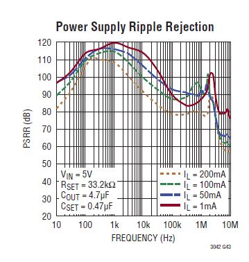

Look at PSRR vs. current. It tells exactly the opposite. I don't see how lower noise density (i.e. better) at 1mA indicates anything about bandwidth.all the datasheet curves had been taken at 200mA /500mA load current. (and no output impedance measurement
