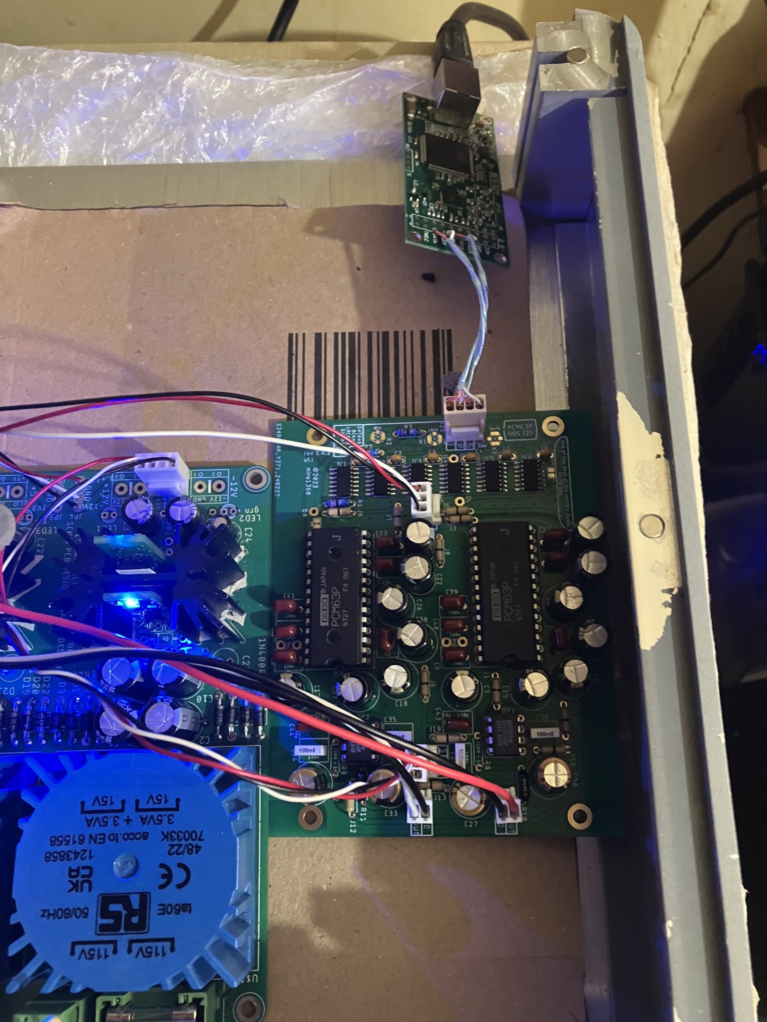

Hey @miro1360 finally got one of your PCM63 DACs up and running, everything works perfectly. Very clean sounding DAC. OPA604 are the only singles I had on hand (apart from LT1021/1121) also the I/V resistor is just a plain metal film.
After listening to the Abbado 2 for a while, the Abbado is more open and musically engaging, the PCM is slightly compressed and sterile but professor @abraxalito pointed out the limitations on the PCM DAC are the op-amps in this case, his Abbado features a bespoke high bandwidth output stage.
Luckily I have snagged a CEN I/V kit so can try a discrete output stage soon, however I will also try some discrete Diamond buffers from Sjostrom Audio and do a comparison.

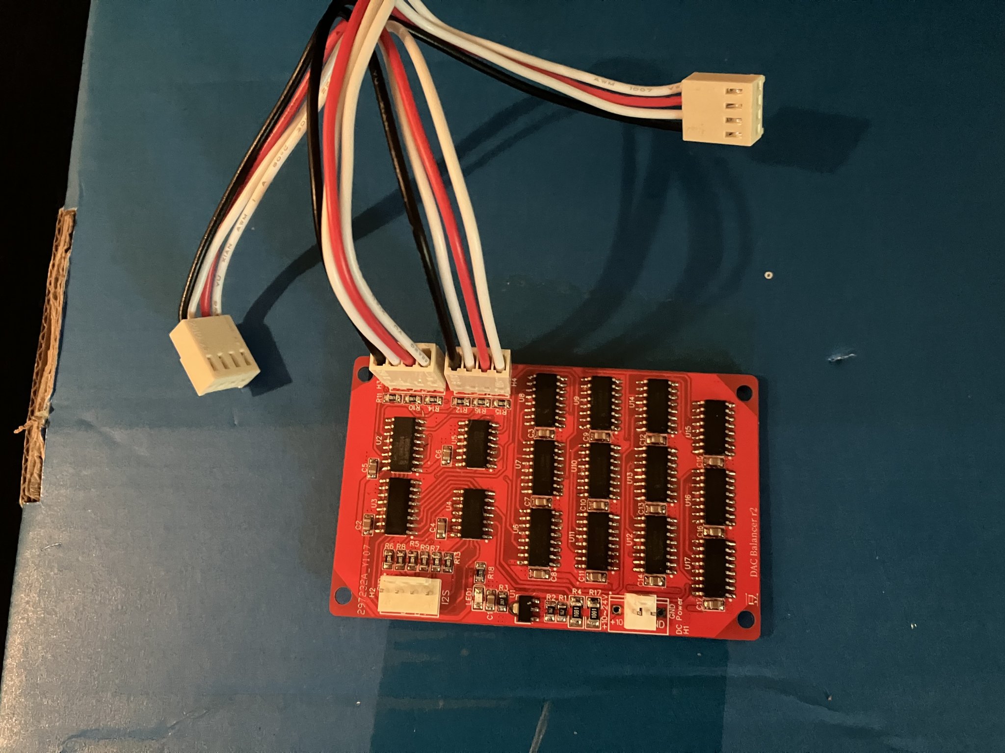

Miro, for making two DAC boards balanced, it might be that I can use Abraxalito's phase splitter module on your DACs inputs, instead of the differential circuit you showed me with OPA1632. This means I can use your OPA627 output boards on AD1862 DACs with no fuss.
Very smart little device, perfect solution for any NOS DAC setup should it work with yours.
