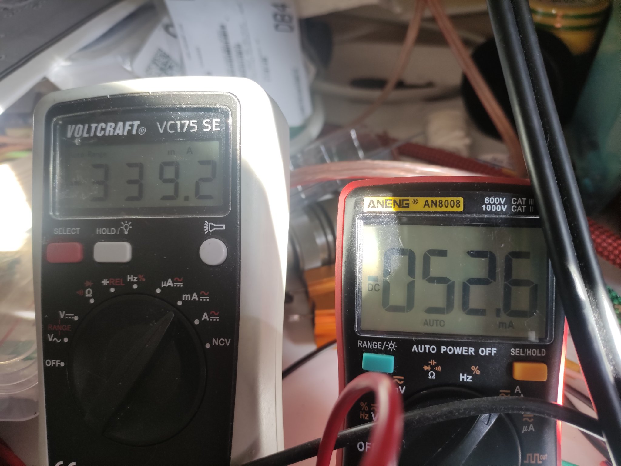

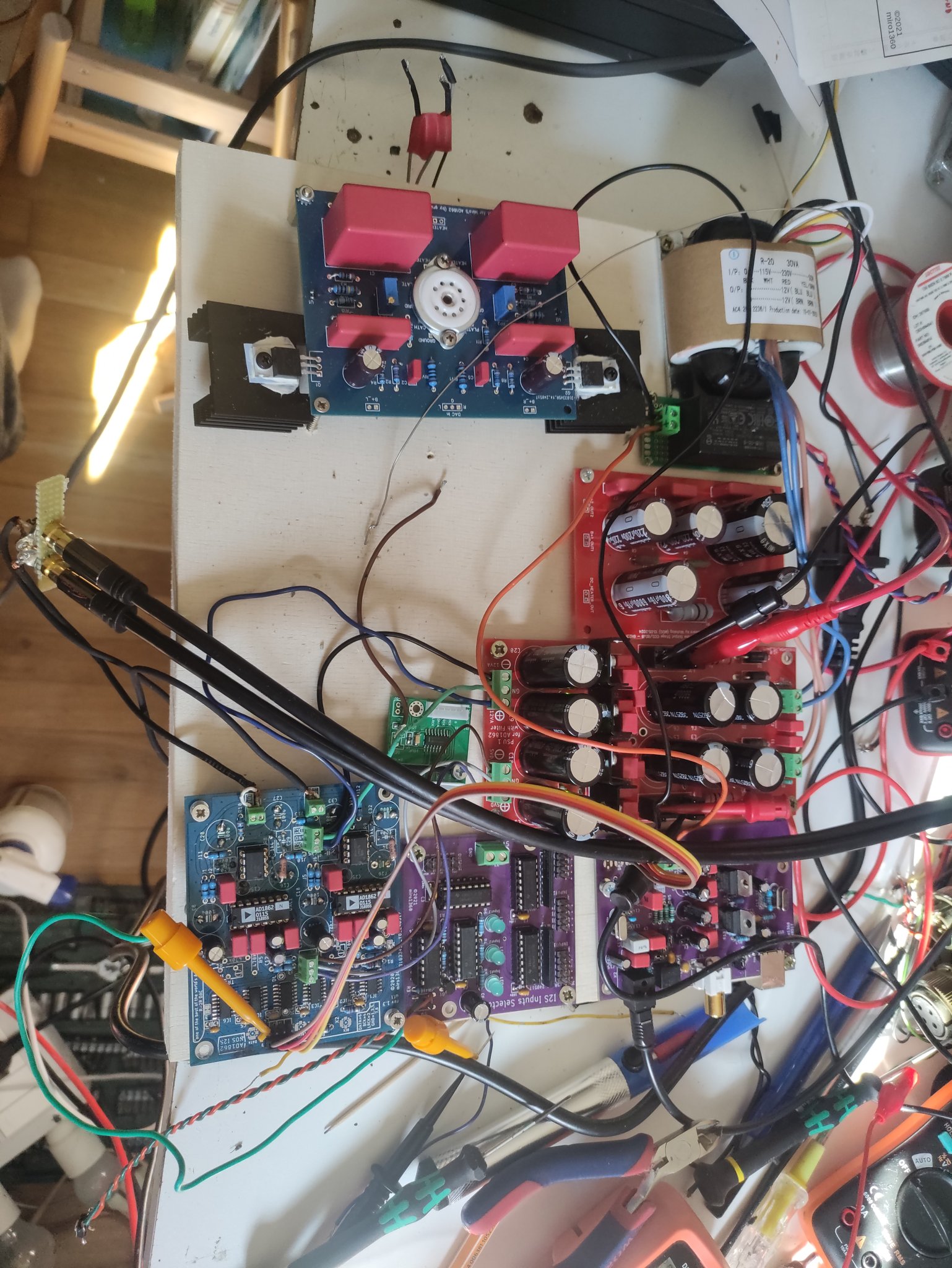

@lasercut Sorry for the bad pictures, but the dmm probes are stuck randomly, so the grey dmm shows the +-12V path, the orange dmm (right) shows the +-5V path.

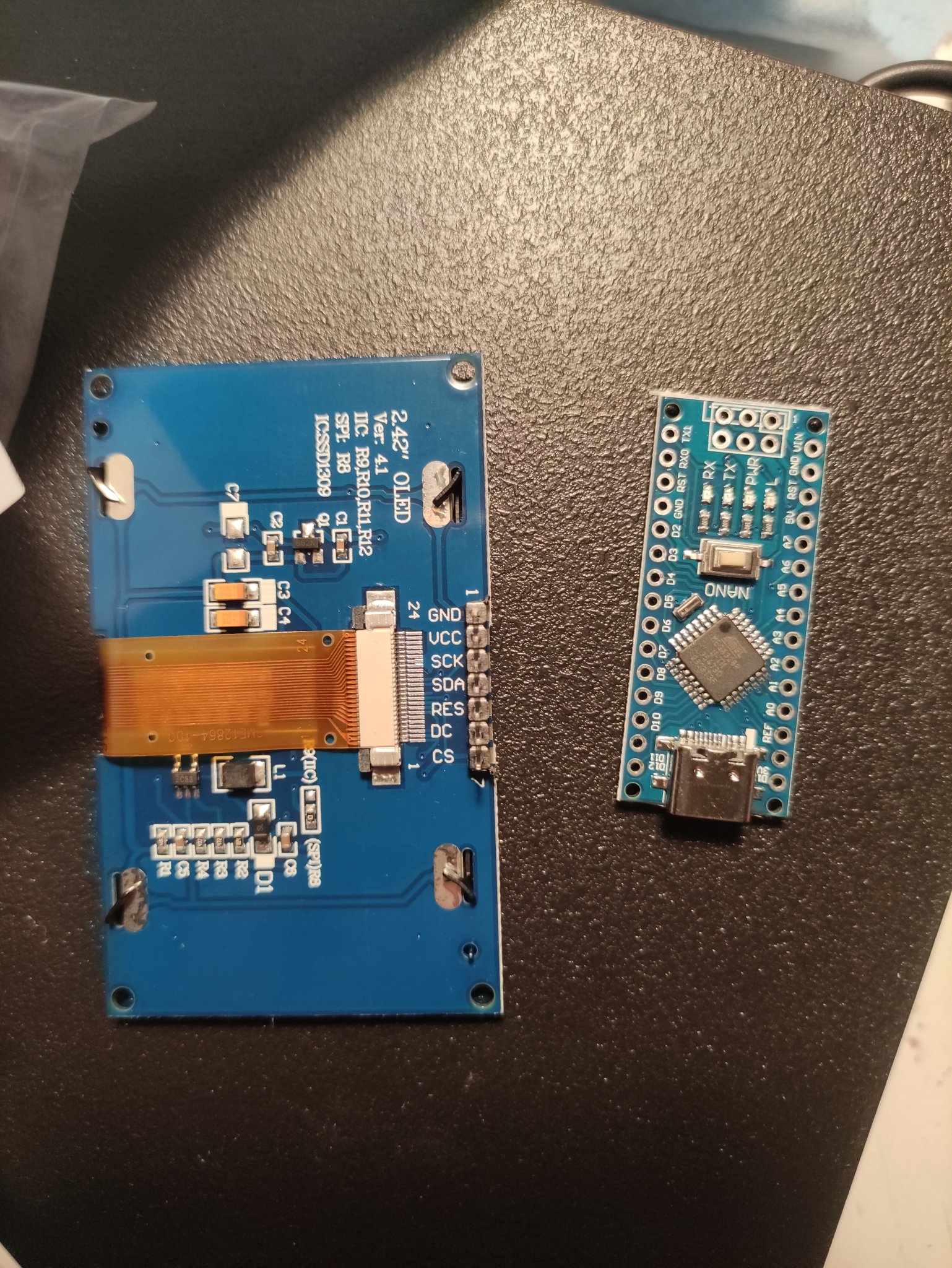

So Friends, approaching to the end of this project (yes enclosure still missing), and starting the next one (TDA1541... Or 1540? Or what?) I'm baffled.
This is called ssd1309, and has 7 pins. Not only I don't have a clue about Arduino programming, but here I don't know how to wire things here (except G and Vcc š )...
What I'd like to show is input (USB, coax, optical) and sample rate (and bitrate?)
To switch between USB/coax/toslink I think I will use a dpdt, nothing fancy. Although I populated Miro's input selector board, his USB/coax/optical board has just one i2s output, so no way using the input selector.
So, how to catch the i2s signal, communicating it to Arduino? And the inputs?
Sorry to monopolize the thread at this point, but this Arduino is Greek to me...
Thank you, mainly for the patience!

What you have is an SPI based OLED, headover to chatgpt (if you have access to version 4 then it will be better) paste my code there and ask it to modify the code from ssd1306 I2C to SSD1309 SPI version, hopefully it will be able to modify the code.
Recently I have found chatgpt to be pretty good in helping with c, c++, python codes for various micros. Give it a try.

Ok rehana, I'm giving it a try.
My question is, where to I have to solder the pins for SPI (MOSI, CLK, CS, DC, RESET) ?
Given that Chatgpt says
#define OLED_MOSI 11 // Pin SPI MOSI
#define OLED_CLK 13 // Pin SPI SCK
#define OLED_DC 9 // Pin DC
#define OLED_CS 10 // Pin CS
#define OLED_RESET 8 // Pin Reset
// display object
Adafruit_SSD1306 display(SCREEN_WIDTH, SCREEN_HEIGHT, &SPI, OLED_DC, OLED_RESET, OLED_CS);
const int lrclkPin = 2; // Pin LRCLK
const int usbPin = 8; // Pin input USB
const int coaxialPin = 9; // Pin input COAXIAL
const int bluetoothPin = 10; // Pin input BLUETOOTH
so, bluetooth is 10 (as CS?) coax is 9 (as DC?), etc.
edit:
WOW! I corrected him, and gave out
#define SCREEN_WIDTH 128
#define SCREEN_HEIGHT 64
#define OLED_CS 4 // Pin CS
// Crea un oggetto display
const int usbPin = 10; // Pin input USB
const int coaxialPin = 6; // Pin input COAXIAL
const int bluetoothPin = 7; // Pin input BLUETOOTH
