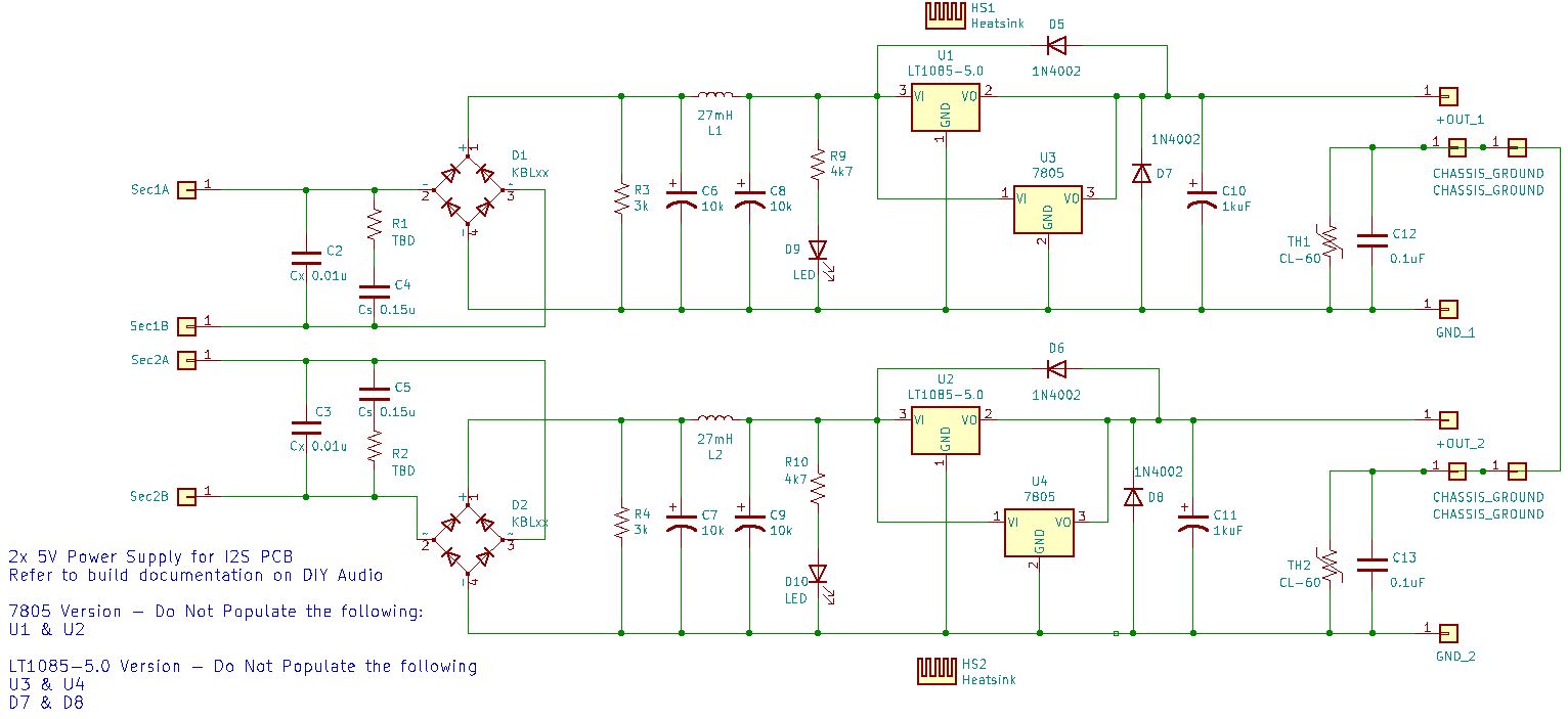

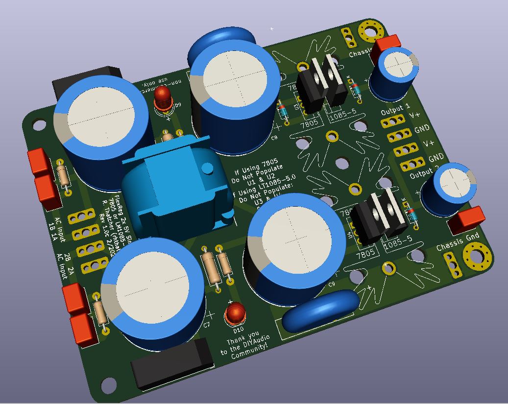

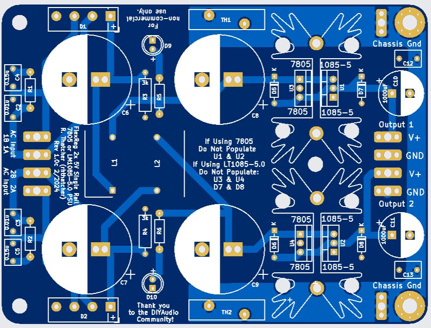

Attached are Gerbers & a build guide doc including BOM for a power supply PCB for your I2S/USB boards (5V@400mA + 5V@100mA)
This has 2 independent regulated 5V rails with CLC pre-filtering, snubbers, and TH || cap ground breakers. Feed it from 2 pairs of transformer secondaries.
Get some made at your favorite board fab (JLCPCB or similar) and share the extras with your fellow builders.
Thanks to Miro1360 for the fine DAC work, and to Kokanee and Vunce for the inspiration and input on this board.

This is great, I just sent the PSU 1 ECO to jlcpcb planning to use it as my 5v supply board from dual 9v secondaries. This will work even better. On that note Newark has this transformer on sale if anyone is interested. Cant go wrong for 7.88 Usd.

You can go wrong with a 230v primary... for most of us in North America, anyway...This is great, I just sent the PSU 1 ECO to jlcpcb planning to use it as my 5v supply board from dual 9v secondaries. This will work even better. On that note Newark has this transformer on sale if anyone is interested. Cant go wrong for 7.88 Usd.

The 5V psu and Gerber files was an unexpected surprise, even includes a mini build guide!Followup to post 8030.
Attached are Gerbers & a build guide doc including BOM for a power supply PCB for your I2S/USB boards (5V@400mA + 5V@100mA)......
Thank You Randy.

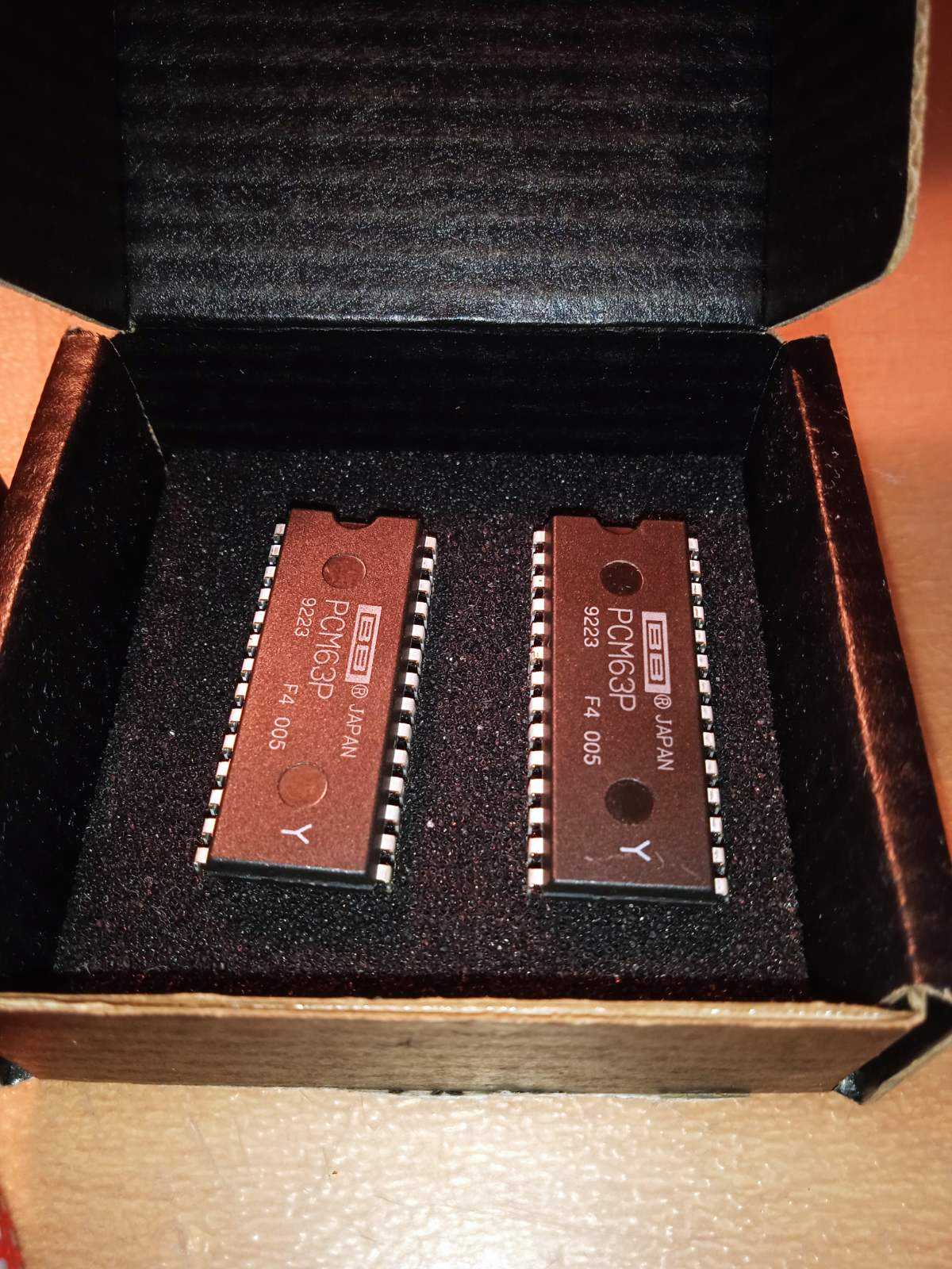

What is your impression? PCM63P-K vs PCM63P-Y vs AD1862 ??
I do not know. Very strange chip. When I listen to it, I have the impression that all the tracks play faster than on others. It does NOT forgive if the recording is bad or if the sound designer and production is not top-notch. The brain struggles to process the amount of information coming out of it. It is not for everyone's ears. Especially for the 'basshead' listener/preference in music. Or who likes soft and warm reproduction. Maybe it can be compensated with a dedicated opamp, but then the sound of the opamp becomes dominant.It's all very similar. The PCM63P-Y gives the brightest sound so you need to choose your I/V opamp carefully. We will see the result with some tubes, it will be something completely different.
