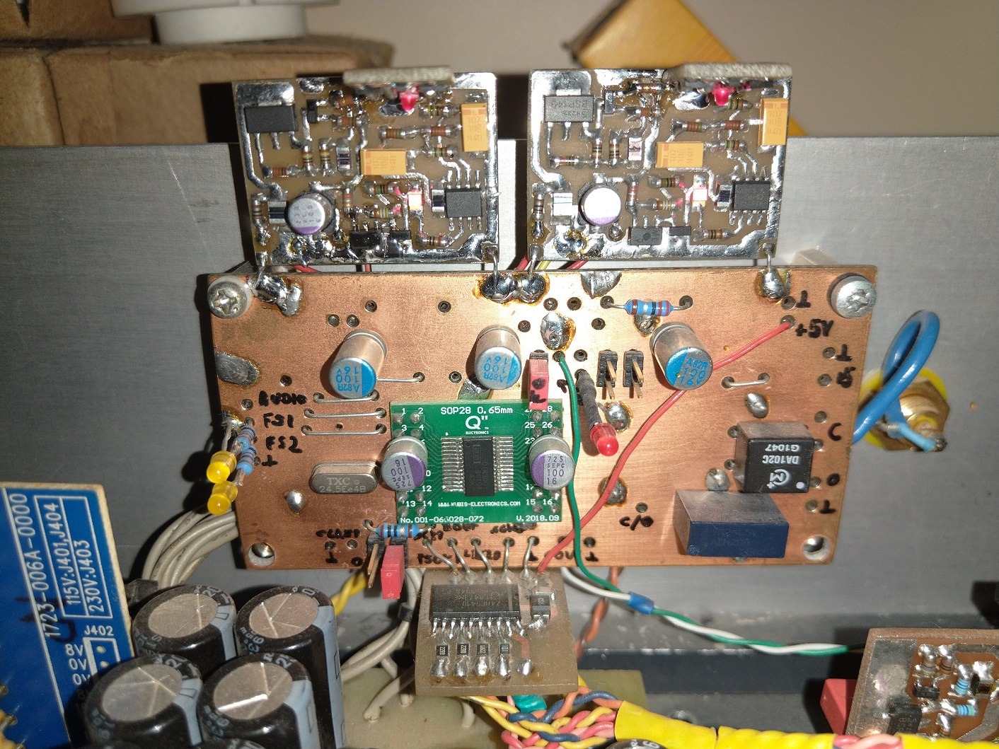

I was ordered another spdif board - Dir9001. I hope to use together with Jlsound but that's later. I want to see how it works first.And something else about these AK4113/4118 boards.

What kind the impressions of AK1113 board?

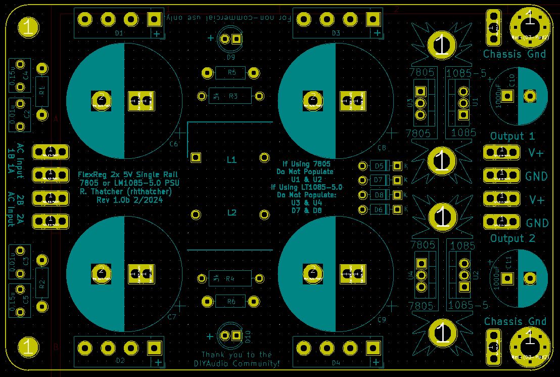

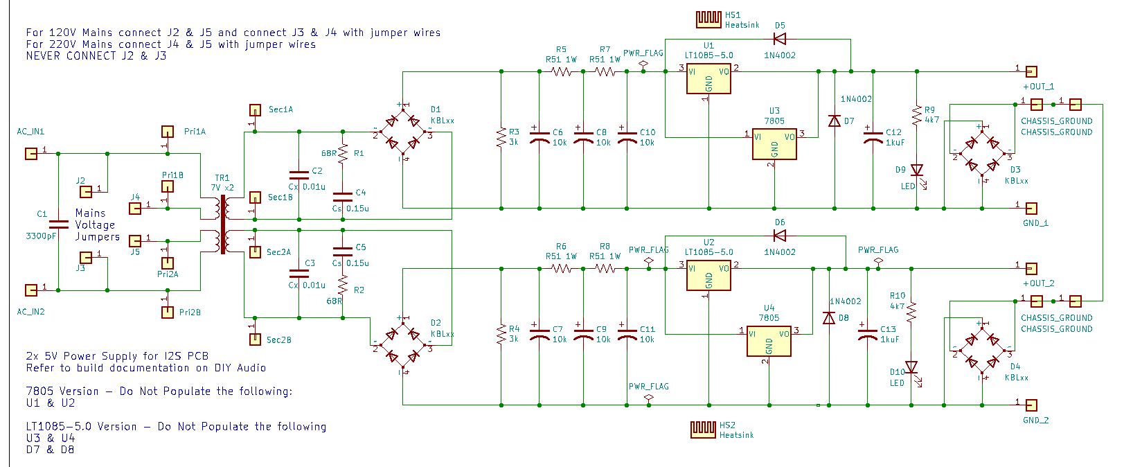

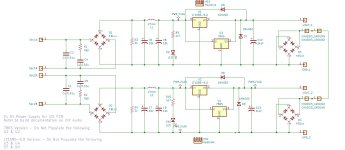

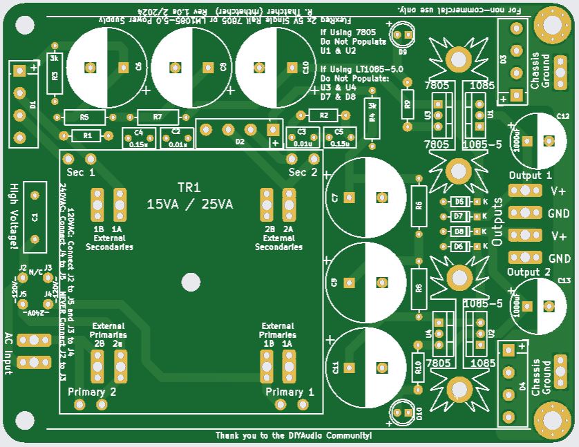

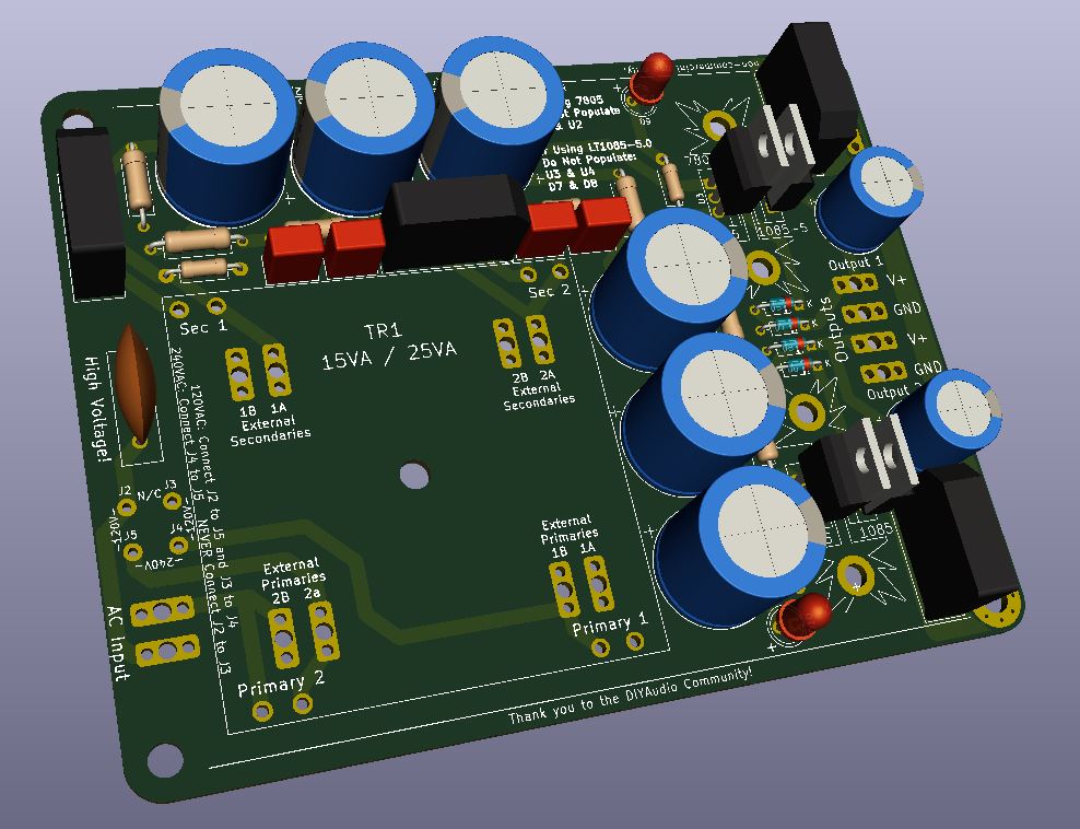

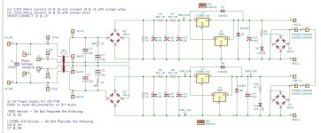

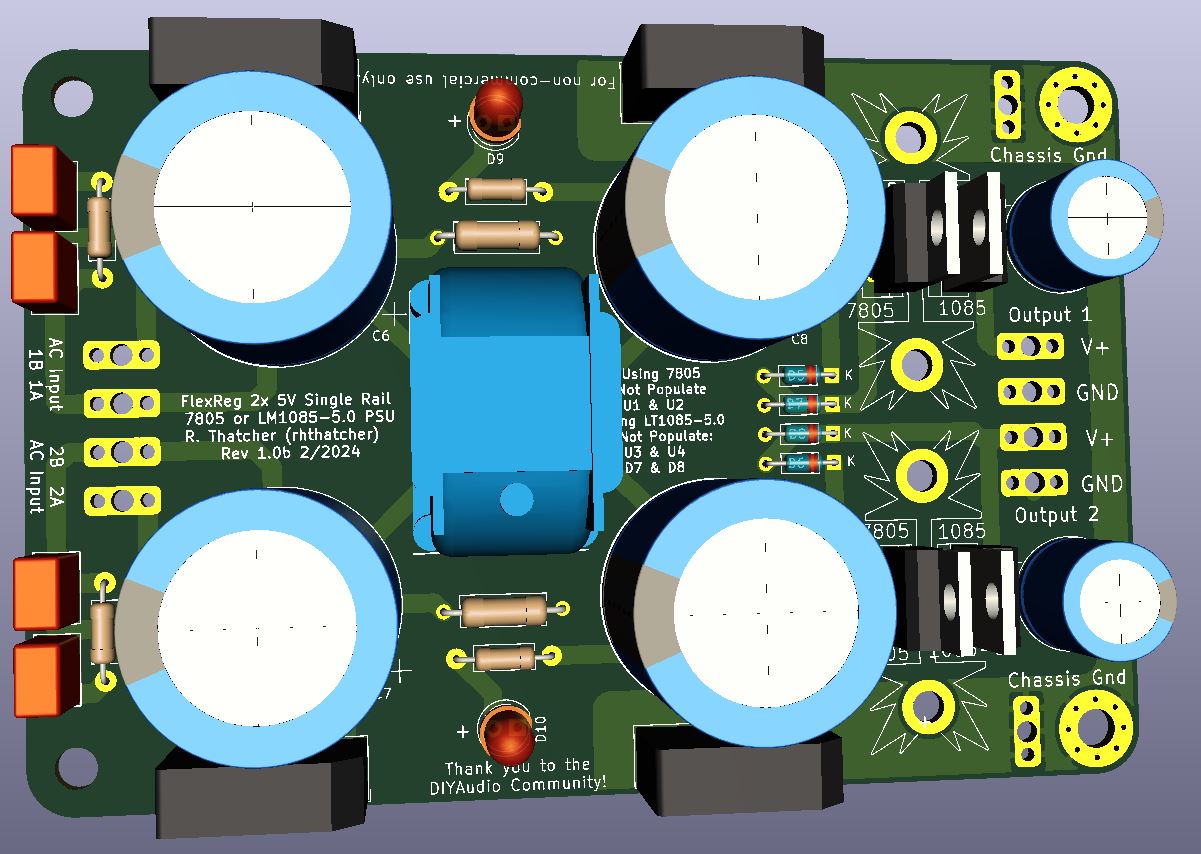

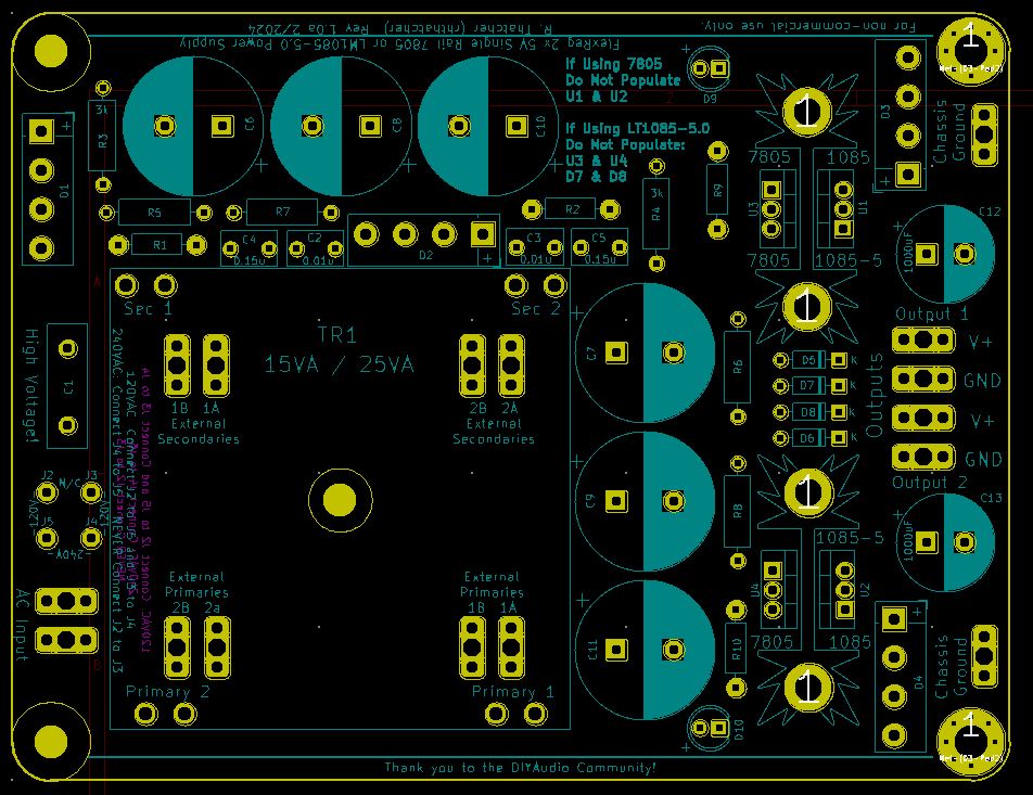

@Kokanee recently asked about a possible standalone 2x Single Rail power supply to supply 5V @400mA and 5V@100mA for the I2S board. I have 2 "FlexReg" boards I make that look like a good jumping-off point for a purpose-built board.
I sketched up a version with an on-board transformer (60x60 Amgis or Talema 15 or 25VA), and a separate version that can be used to hook up an existing transformer. I understand quite a few folks are using R-Core transformers with multiple secondaries, so the more compact board may be more attractive.
This is set up for FIXED regulators with pinouts like 7805 (Vin, Gnd, Vout) and LT108x-5.0 (Gnd, Vout, Vin). I didn't look at every possible regulator and associated pinout, so there may be other options that drop right into one side or the other of the heatsink if the pinouts match.
Here's a summary of what's going on for each PCB.
WITH TRANSFORMER:
PCB Dimensions: 100x130mm
Mounting holes on 10x10mm grid for easy modushop bottom plate mounting.
Includes AC Cap at input.
Configurable for 120V/240V
Use a 60x60mm Amgis or Talema 15 or 25VA transformer OR hook up to external transformer secondary connections
Includes rectifier snubbers (Optional - use Quasimodo to measure transformer)
Uses bridge rectifiers (easy install)
CRCRC pre-filter stage before regulators (18mm / 7.5mm LS caps)
FLEXIBLE to use either 7805 regulators OR LT1085-5.0 fixed regulators
PCB mount heatsinks. Of course smaller bolt on ones can be used for lower current.
1,000uF cap at the output
Each rail has a diode bridge as ground break to chassis ground.
LED indicator for each power rail
Bleeder resistor for each power rail
Connectors can accommodate soldering in wire (old school), Quick Disconnect spades, OR terminal blocks with 5/5.08mm lead spacing

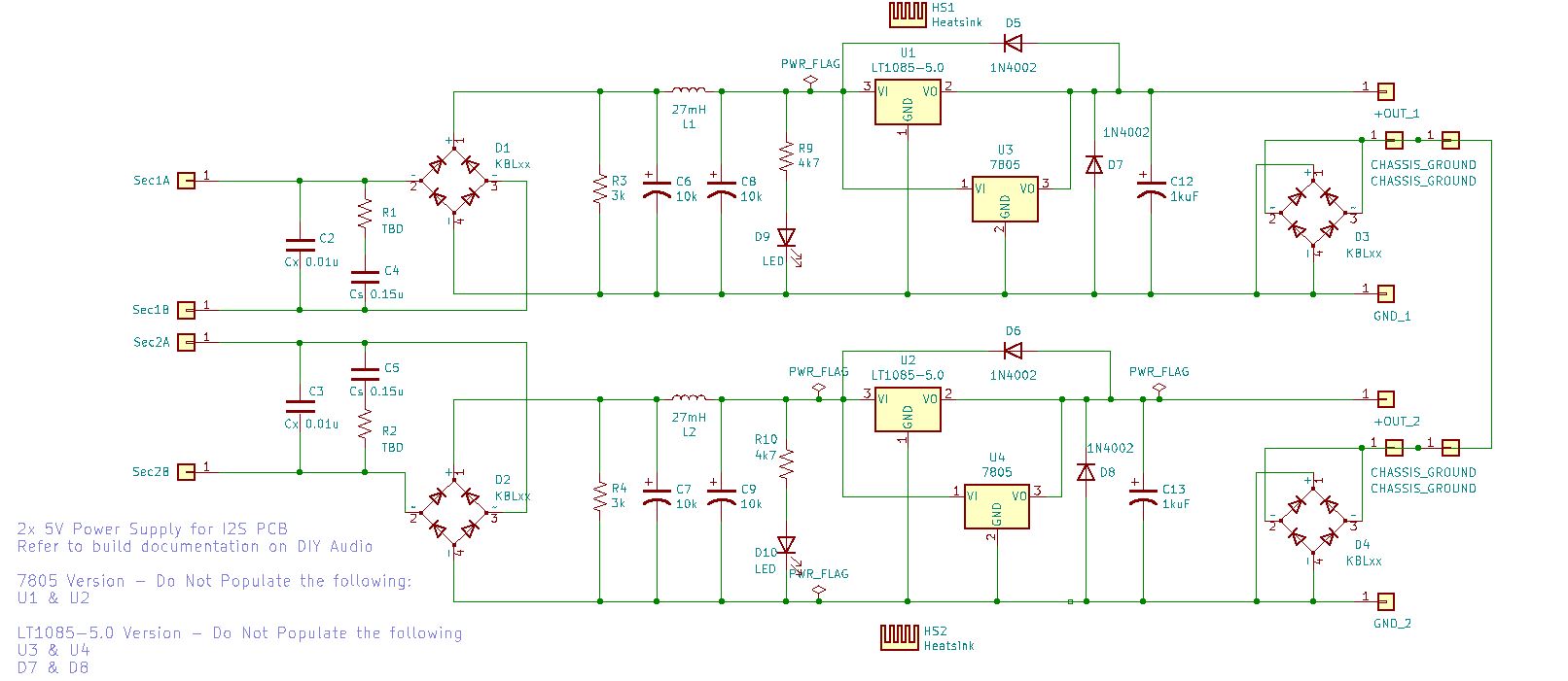

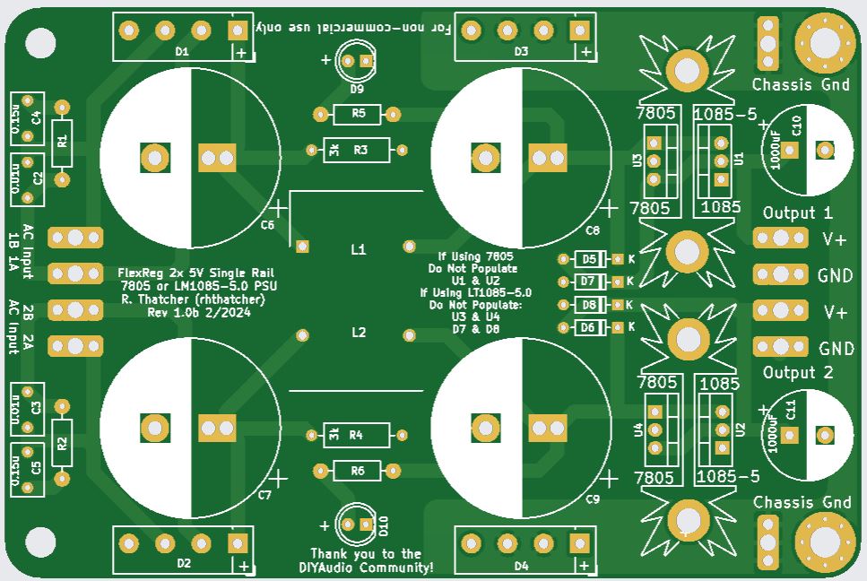

WITHOUT TRANSFORMER:
PCB Dimensions: 80x120mm
Connections to hook up to external transformer secondary connections
CLC pre-filter stage before regulators (Caps can be up to 25mm / 10mm LS or 18mm / 7.5mm LS caps)
The rest is the same as above - except for the AC bits that are missing.
Any interest in these?
I'll take comments and I'm willing to make some minor edits to one or both of these PCB's. I'll post Gerbers if there is interest.
Super cool Randy!
Even equipped with ground loop breakers 😉.
Will the skinny heatsink handle the higher current if used to power the USB side of the JLSounds board?
Maybe add vent holes in the pcb around the heatsinks.

Let's do some math.
I think folks are running R-Cores with 9V secondaries. Let's assume a factor of 1.4x for voltage at the cap bank, so 12.6V before the regs. 5V after regs. 7.6V drop at the reg and 400mA draw.
P = I * V = .4A x 7.6V = 3.04W
Let me check heatsink specs....
These are the footprint currently on the PCB
1" Tall 13.4°C/W p/n 531002B02500G 40°C over ambient - TOO HOT
1.5" Tall 11.00°C/W p/n 513102B02500G 33°C over ambient - Pretty hot. Too hot?
I could go for a larger footprint heatsink:
1" Tall 5.50°C/W p/n 529702B02500G - Much better
1.5" Tall 3.70°C/W p/n 529802B02500G - Better yet

That works, and like you mentioned a taller sink can be used.
This board will be handy for the DIY'ers toolbox.
Edit: Datasheet states 13.4ºC/W?? That would be 40ºC above ambient.
529802B02500G is definitely better, especially with holes underneath.
The board will grow a bit, but IMO it's worth it.

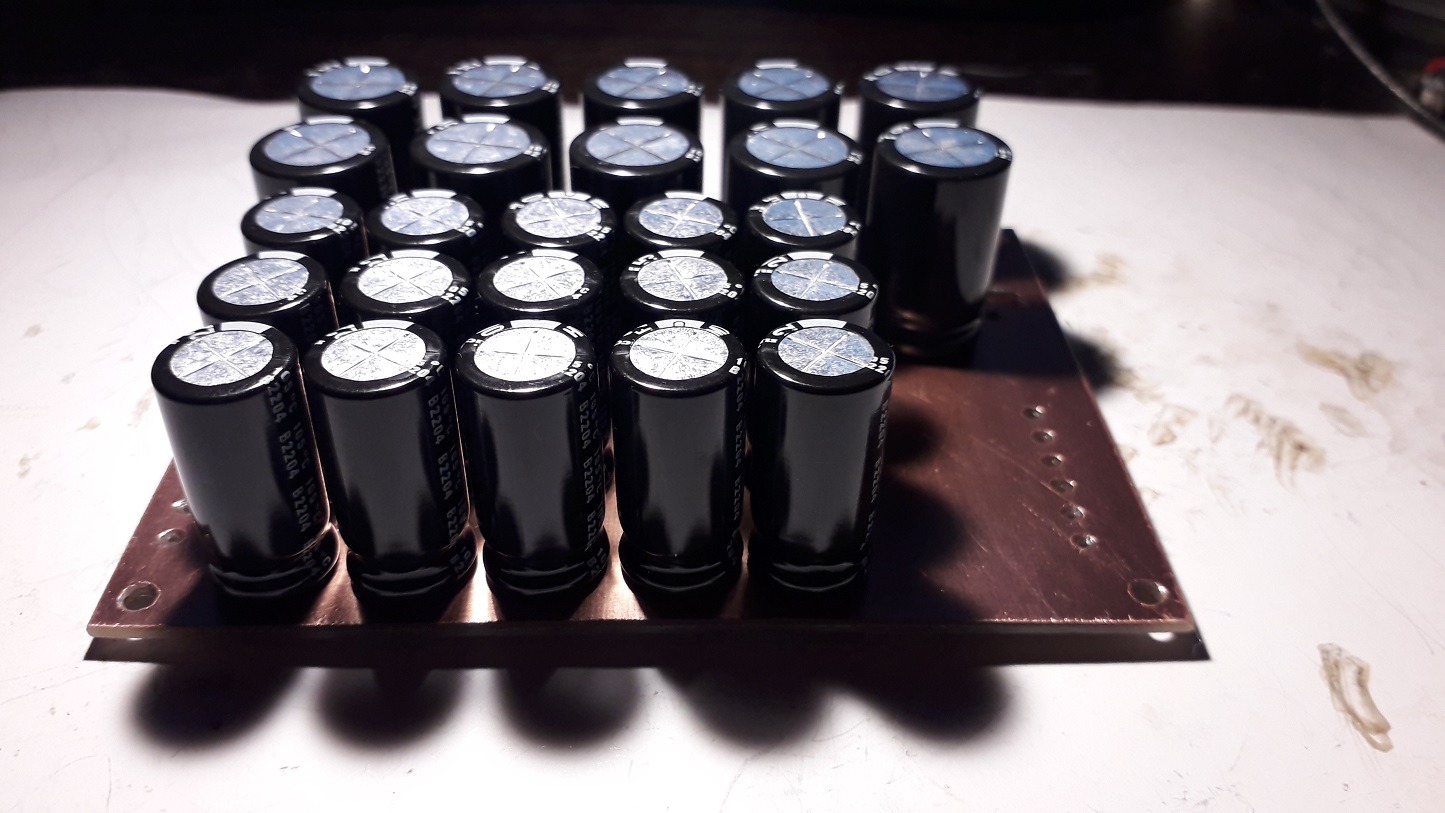

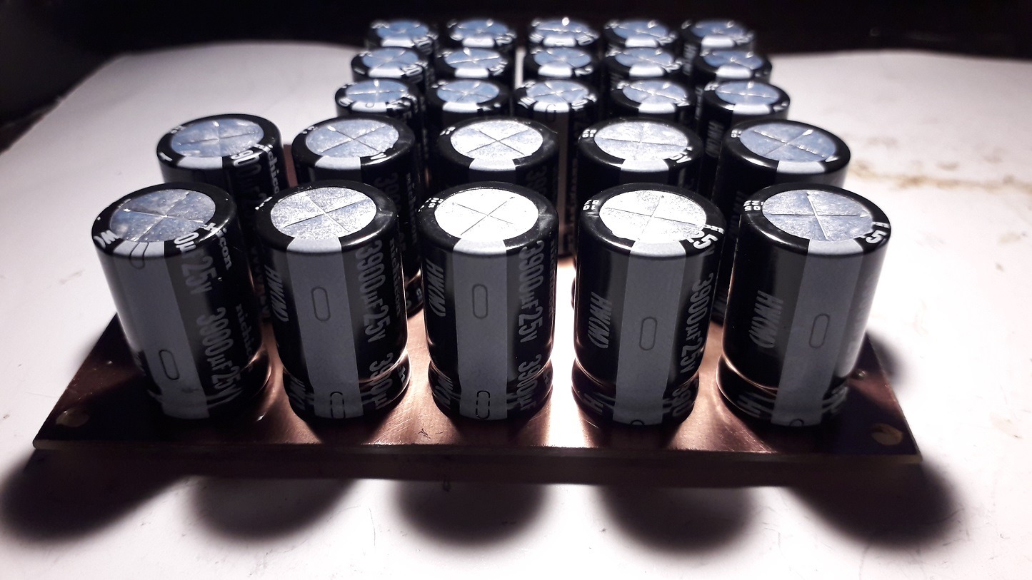

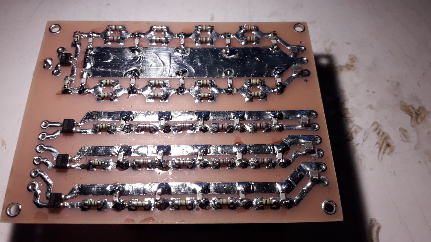

Speaking of rectifiers, here's what I did for my DAC. Three 10V supplies for PMD100 and DIR9001 and one +/-18V for 8*PCM1702.
Low VF Schottky bridge rectifiers and CRCRC... filters, 15pcs 2200uF/25V + 10pcs 3900uF/25V, all Nichicon UHW, resistors Vishay MELF 1W, and small capacitors COG + SMD film were used.
Otherwise, this kind of rectifier makes sense with shunt regulators when the currents are constant and when the CRC filter does its job properly. After filtering, ripple no longer exists 😉 .

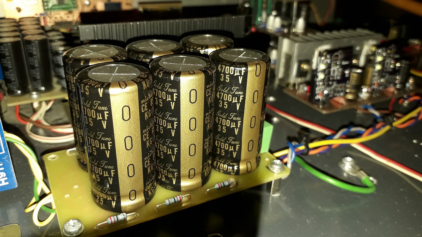

The analog section has the same type of rectifier but with 6 Nichicon LKG 4700uF/35V on a separate PCB.

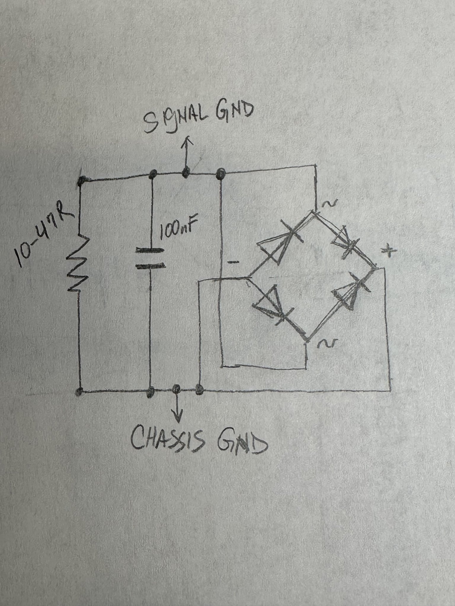

The bridge only setup is what’s used in pearl psu. It only conducts when voltage is above diode Vf setting Works for safety. It’s by no means the only way to do this.Hi Randy,
I was looking at the ground loop breaker and it’s missing the parallel resistor and capacitor between signal gnd and chassis gnd.
Or omit the BR and use a thermistor//capacitor between sig gnd and chassis gnd.😉
I use a CL60 thermistor in power amp PSUs for this function.
I’m happy to update this PCB to TH and cap instead of bridge. Is there a consensus on which TH? CL60 is big. ZM uses a smaller one on IronPre. I could go for that one. Although I like CL60 because I buy them in bulk.
