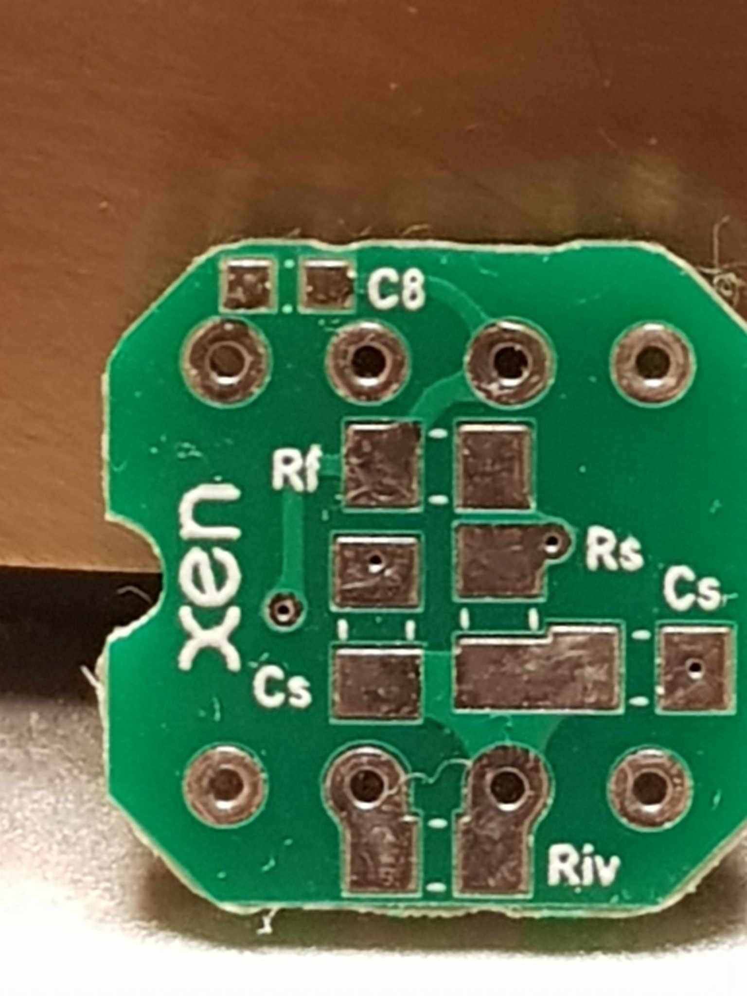

Here the Gerber files and the BoM :
1x IC1 AD797 SOIC8
facing downwards
1x Riv Susumu 0805 27R 0.5%
1x Rs Susumu 0805 27R 0.5%
1x Rf Susumu 0805 2.7k 0.5%
2x Cs Murata C0G 0805 10nF 25V
1x Civ Murata C0G 0603 2.2nF 50V (solder between Pins 2 & 3)
1x C8 Murata C0G 0603 51p 50V (for AD797 only)
Many thanks to Fran for verifying PCB.
Enjoy,
Patrick

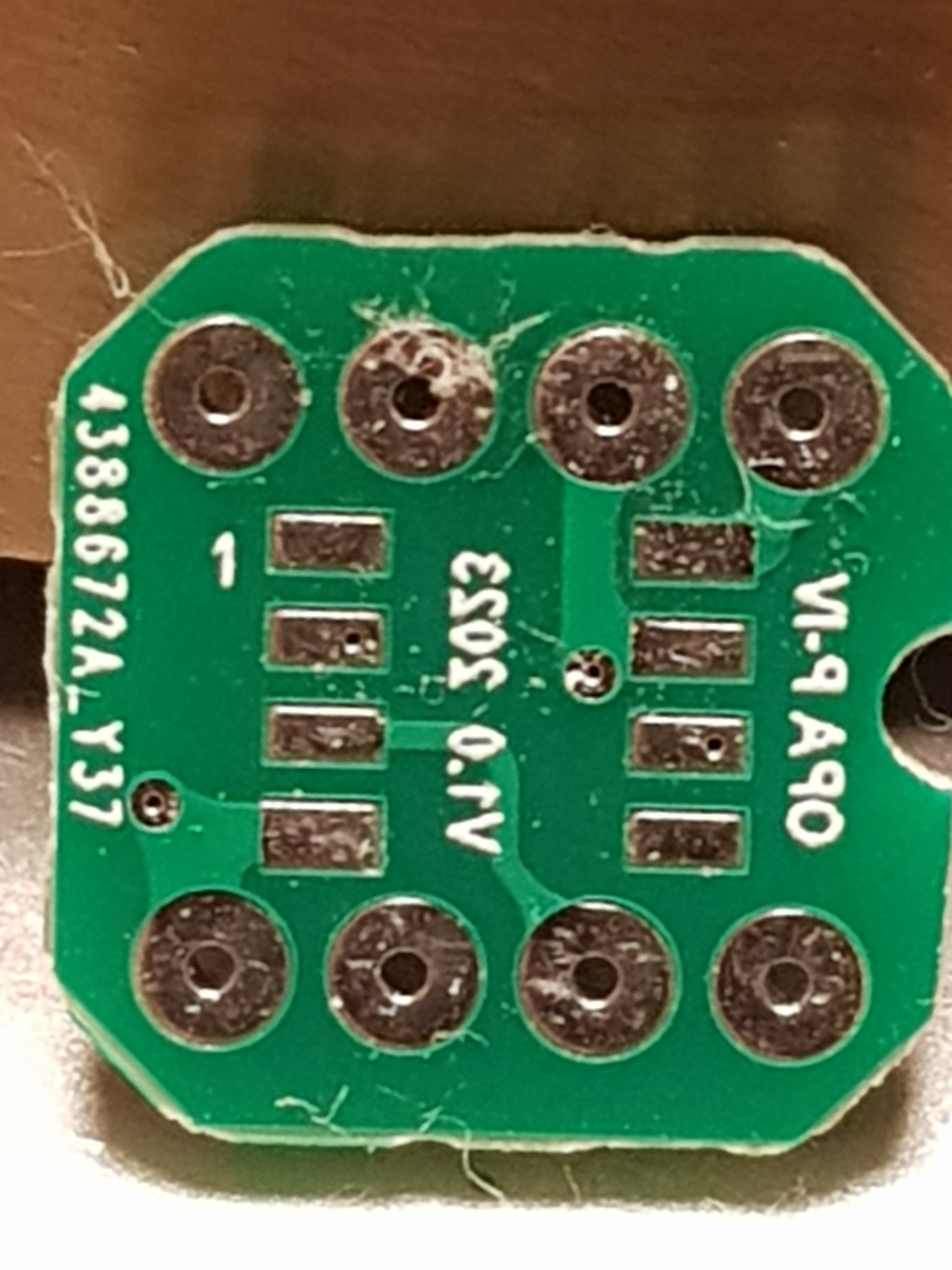

I don't know which pins 2 & 3 are?
Is there anyone who might show me a picture of soldered PCB?
Pin 1 is already indicated on the board on 2nd pic. So solder civ across pin 2 &3 on the smd op amp.Civ Murata C0G 0603 2.2nF 50V (solder between Pins 2 & 3)

The half circle cutout is the same as in a DIP8 package, indicating pin orientation.
Pin 2, 3 are where Riv is connected.
And Civ is in parallel with Riv, without saying.
You cannot solder Civ at the SOIC opamp.
You need to solder directly next to Riv at the round pads for the DIP8 pins.
Patrick

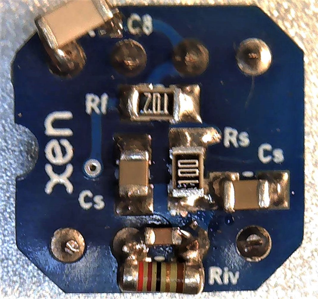

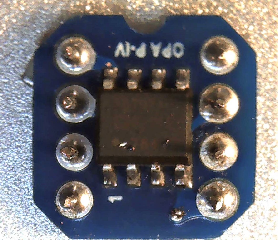

I hope the following picture help.
The "1" on the underside of the board is for alignment to pin 1 of the AD797. Then the cut-out notch shows the orientation for plugging it into the op-amp socket in the DAC board. You can see how I used a melf resistor for Riv and a ceramic cap for Civ in between the pins for 2&3. The only cap I had to hand for C8 was a little large, so it hangs off the side a bit!
I mounted mine in an op-amp socket and then can easily plug that into the DAC board.
Don't forget - you must remove Riv and Civ if they are installed on the DAC board!!!
My original post is here
fran
fran
