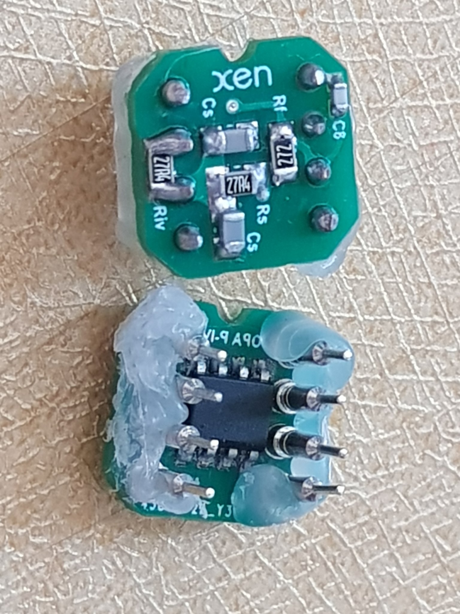

What is the reason for the glue/silicone substance?I soldered the AD797 I/V PCBs....
@EUVLI have written many times.
When you're using the passive IV with AD797 gain stage,
You MUST remove Riv and Civ from the Miro PCB.
Patrick
Thank you!
Now I see.
Just removing Riv Civ and keeping the state opened.
