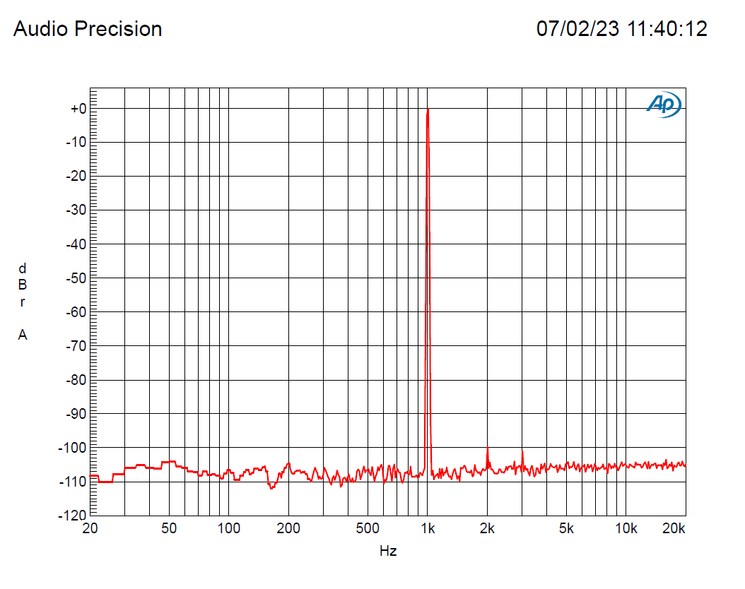

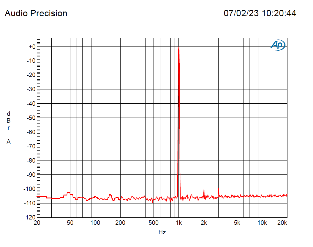

Earlier, while still in stock, we bought some 40 pcs of PCM56K from Rochester.
We also have some 16 pcs AD1862N on hand.
Last weekend, I had a chance to measure their distortion with an Audio Precision SYS2722 distortion analyser.
The DACs were driven directly with a JLSound I2SoverUSB suitably configured.
WAV files used were 16 bit 176.4kHz (4x oversampled).
IV conversion was OPA1612 with 3k Riv to ensure consistent measurements.
The 40+ PCM56s have an output current range of 0.869 ~ 0.899mA.
i.e. 0.884mA +/-0.015mA, or +/-1.7%
All harmonics (H2, H3) were between -99dB and -102dB.
Higher harmonics are all below noise level.
The AD1862s have tighter tolerance.
Current of 16 devices ranges between 0.990 and 0.997mA, or +/-0.3%.
But distortion is also in the same range as PCM56k, i.e. -99dB to -102dB.
And the fine H3 trimming at -60dB does not bring significant improvement.
If you must have perfectly matched output amplitudes, it is super easy to adjust Riv to suit.
For me, PCM56K is just as good as the AD1862.
And there is hardly any difference in noise level.
Of course people will tell you all about subjective impressions.
I'll leave that to them.
Patrick

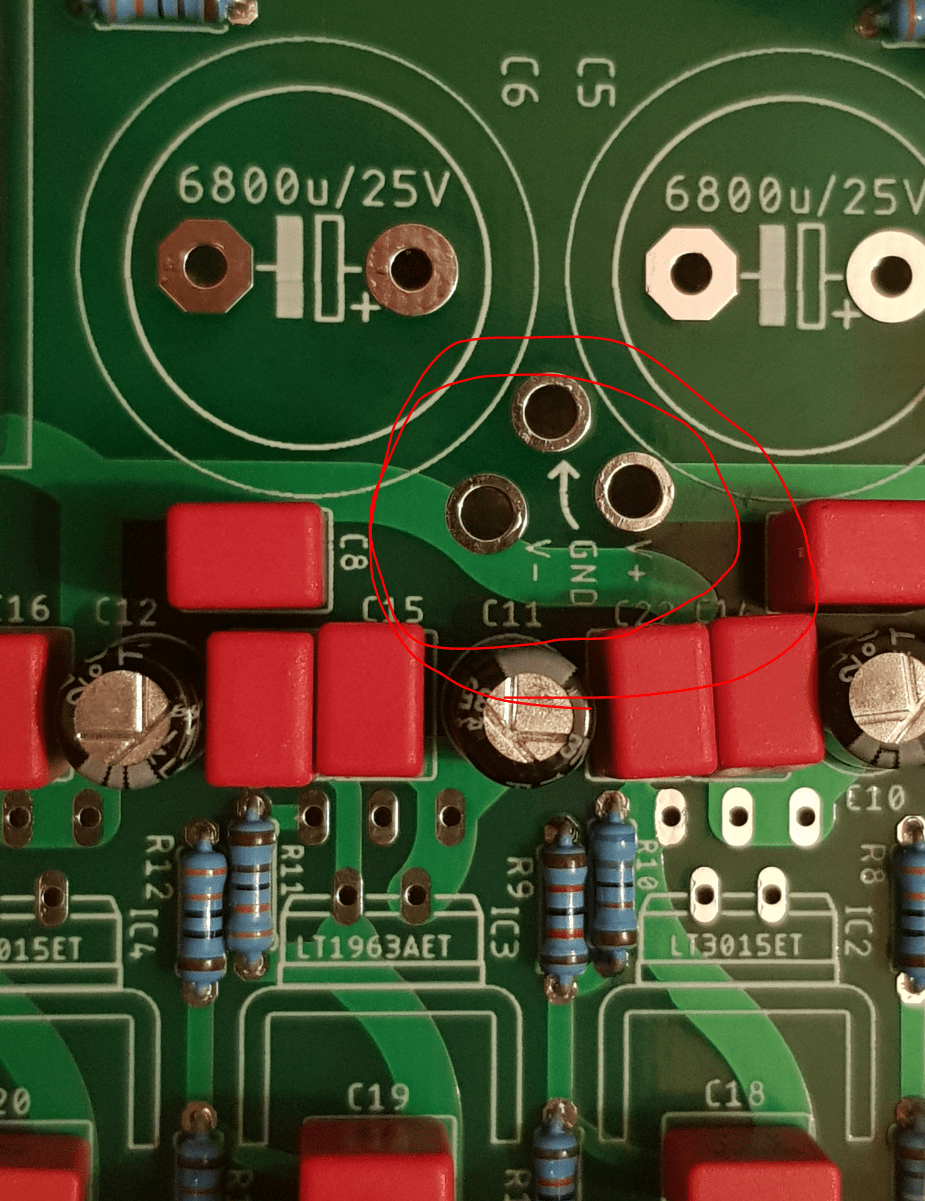

What is purpose of +V/-V/GND pin holes on PSU 2 of AD1862?
Someone has connected this GND to the chassis earth ground with CL60.
Is it proper usage of this GND pin hole?

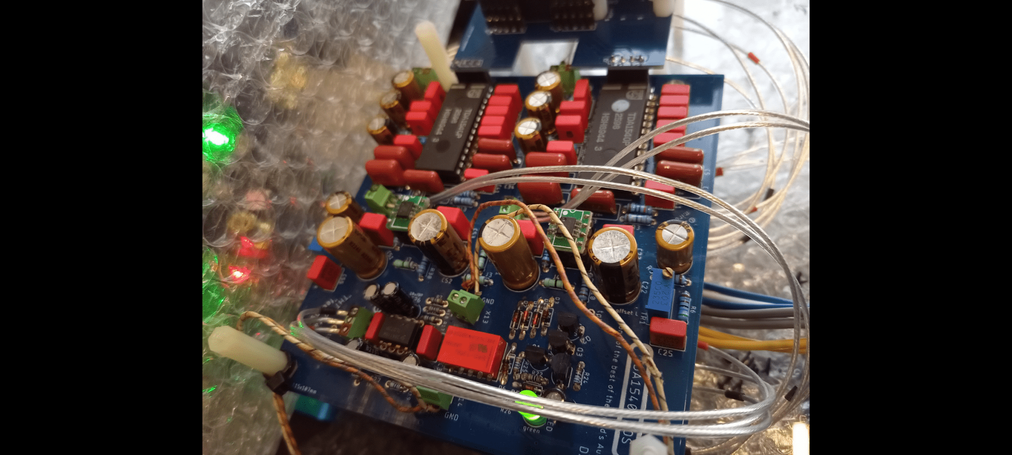

thanks miro. long time no update, i swapped from pcm63 to tda1540 a few months ago, sound beautiful.
@chi0001 , may I know what is that board connected to the inputs of the DAC?thanks miro. long time no update, i swapped from pcm63 to tda1540 a few months ago, sound beautiful. View attachment 1189561

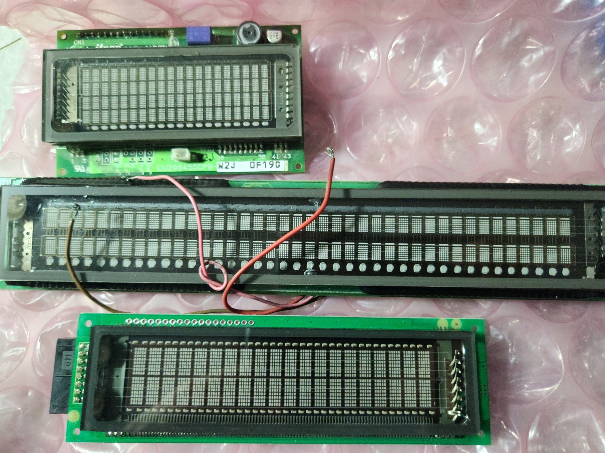

I was working to incorporate a decent display to the DAC from among these:
But these are power hogs, although they are extremely easy to implement, one is HD44780 compatible (20x4) and other two second from top and bottom one (40x2, 20x2) are three wire serial interface compatible (I have used them with 2 wires GND and Rx). I though of incorporating ILI9341 type while I started working the code for an STM32 based solution, I came across this interesting blog. Hope it could be of use to who want to have a display interface in the DAC.
https://www.dimdim.gr/arduino/universal-usb-to-i2s-interface-indicator/#
