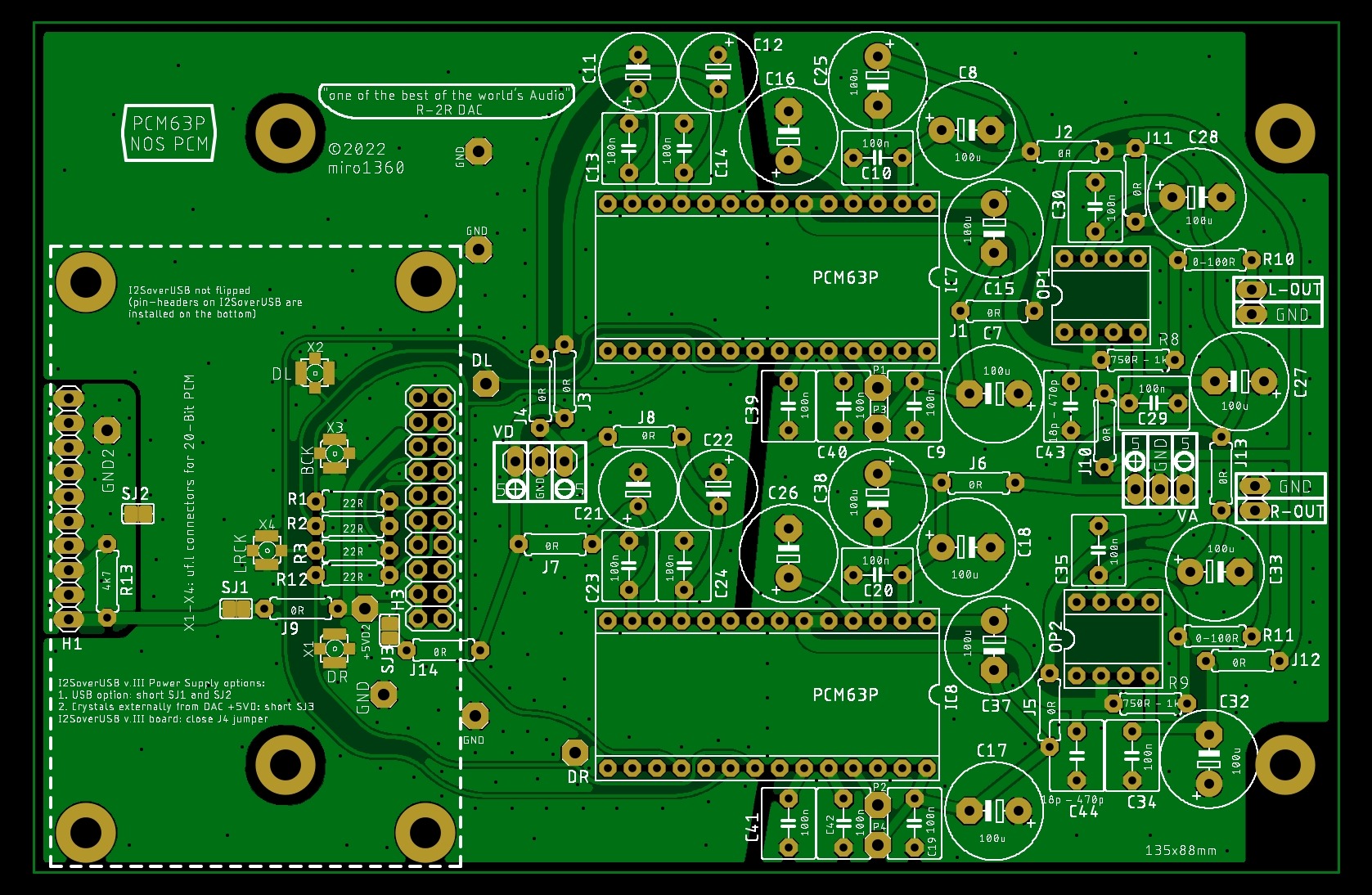

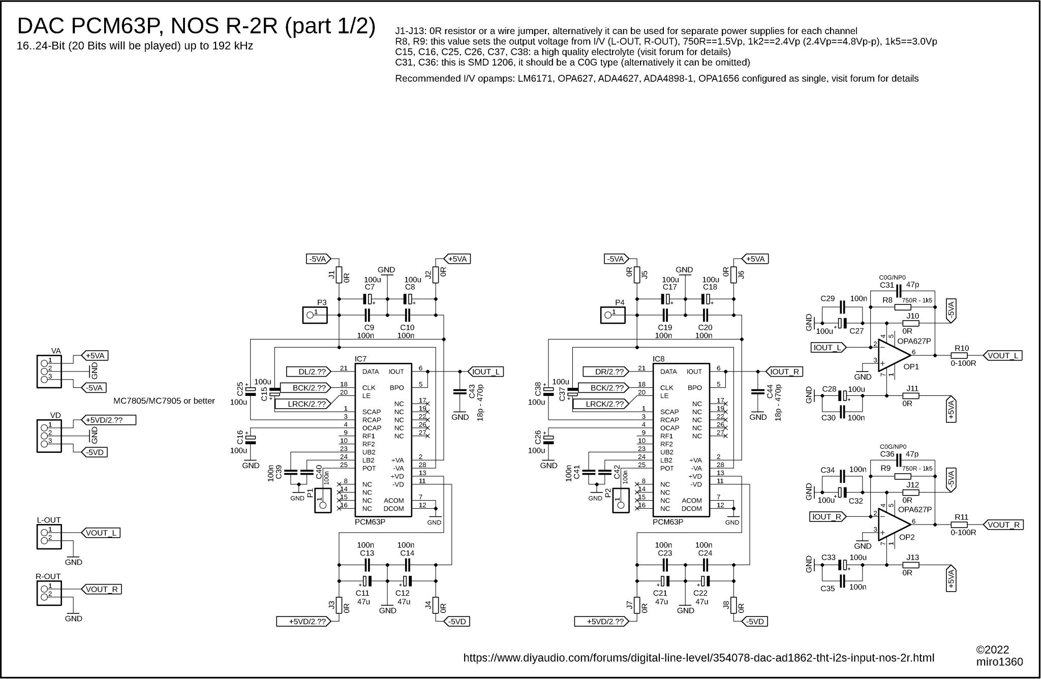

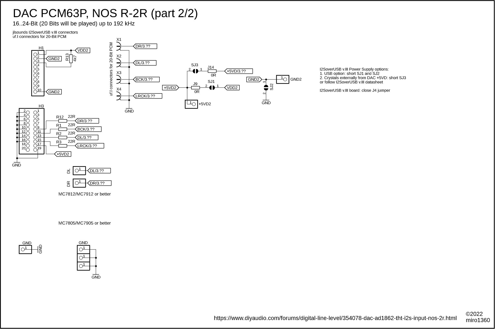

Did I share the PCB? If not, here it is 😁Yes they are BRN 😉
diyAudio_PCM63P_DAC_v1.4_uf.l_jlsounds-notFlipped_align_2022-12-22.zip771 KB · Views: 117
diyAudio_PCM63P_DAC_v1.4_uf.l_jlsounds-notFlipped_align_PCB.jpg511.6 KB · Views: 264
diyAudio_PCM63P_DAC_v1.4_uf.l_jlsounds-notFlipped_align_Schematic1.jpg297.5 KB · Views: 269
diyAudio_PCM63P_DAC_v1.4_uf.l_jlsounds-notFlipped_align_Schematic2.jpg167.8 KB · Views: 263

I've run the simulations, everything is working perfectly, I was assuming that the input of the 3rd shift register chip was taken from the 2nd's final output, instead of the 3rd.
Anyway is it possible to use only one data signal and acquire both DL and DR from the 2nd 74HCT164's 3rd output? In this case an inverter (e. g. 74HC04) would be needed for the left latch signal. The advantage, less digital components, the drawback is the added inter-channel delay.
Would this have a significant impact on sound, what do you think?

@danny92 It is inaudible shift, you can do that. Since you add one inverter, you already have 3 ICs. In that case, it might be better to do my stop-clock solution ... #3969 #4862
Or you can use the CPLD and omit the digital chips altogether: https://electrodac.blogspot.com/p/i2s-to-pcm-dac-converter-tutorial-cpld.html
... my CPLD does stop-clock, does not use MCLK, is probably the easiest way to do it so that it does not process a lot of calculations == even less digital distortion for DACs 😁
... It all depends on your preferences, but the original solution from post #1 is still great and well tested 😊
You need the HCT (it is TTL) ... HC has different input levels (it would have to be converted or dealing with power supplies).

Hello @miro1360 these are the instructions for the JLsounds I2SoverUSB on the dac board.
So if i am using two external PS ie. one for USB and one for the clock for the I2SoverUSB , SJ1~SJ3 should be left open?
Yes, SJ1-SJ3 is left open for two external PS. Next you must cut external power supply jumper on the I2SoverUSB board located on the bottom side of the board.
First external power supply for USB side goes on H1.1 and H1.2. Second external power supply to H3.17 (+5VD2 pin) and H3.19 (GND pin) 😉 ... Note that in this option the USB side is not powered from PC, but externally.
Alternatively you can power the USB side from PC (not cutting external power supply jumper on the I2SoverUSB board). Just provide one external power supply for crystals on the +5VD2 pin and GND.
