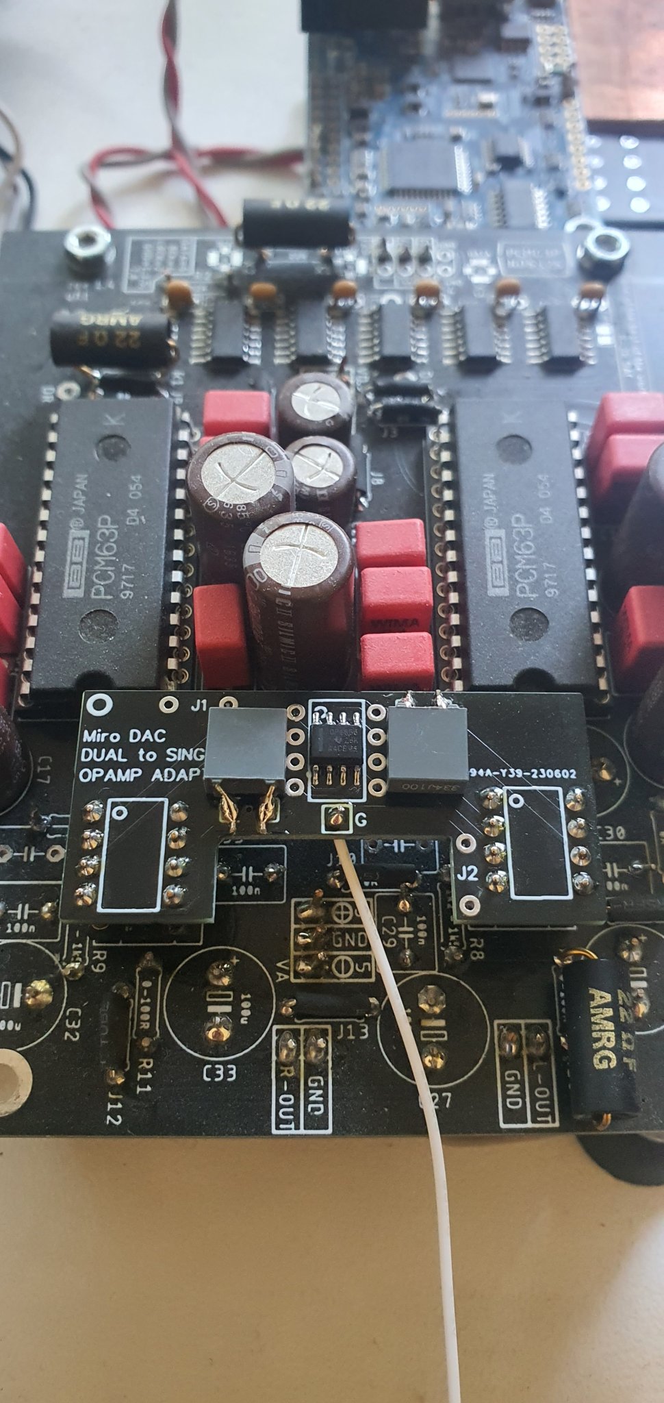

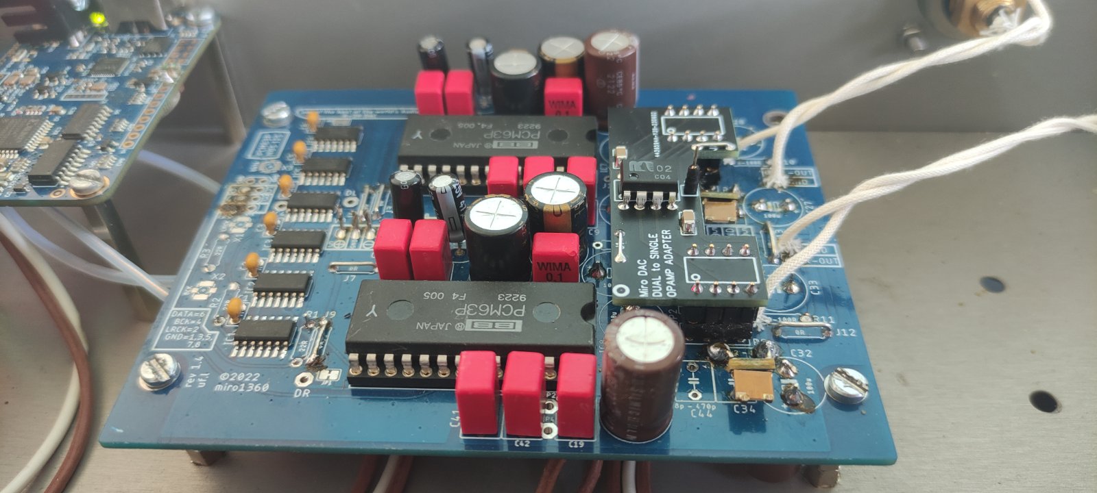

This is the final version here at my place. For this DAC and this box. No 22R - Jupiter silver AWG 23 - Muses 02 on adapter...
I hear ghosts 😎
Superb, how did Muse sound.
BTW did you make the adaptor yourself? willing to share because it looks to be measured precisely, I would like to try using LM4562, and LME49720 - TO99 type.

Muses02 sound is much more natural, everything is more musical and the highs are not overdone, the upper middles are not separated and the bass is tight and strong, the position of the instruments is correct, the voice is of a realistic size. With the Bursons/Sparkos/New ClassD, people are three meters tall 🤣Superb, how did Muse sound.
p.s.
Note - I'm listening on headphones.
I would strongly suggest you try opa1656 😊I would like to try using LM4562, and LME49720 - TO99 type.
In my system, on pcm63 it sounds sooo close to the high end of opamps. I have quite a few, and currently this plays for some reason 😁
I've tried at least 20 opamps.....In the end, personal taste always decides. 😎

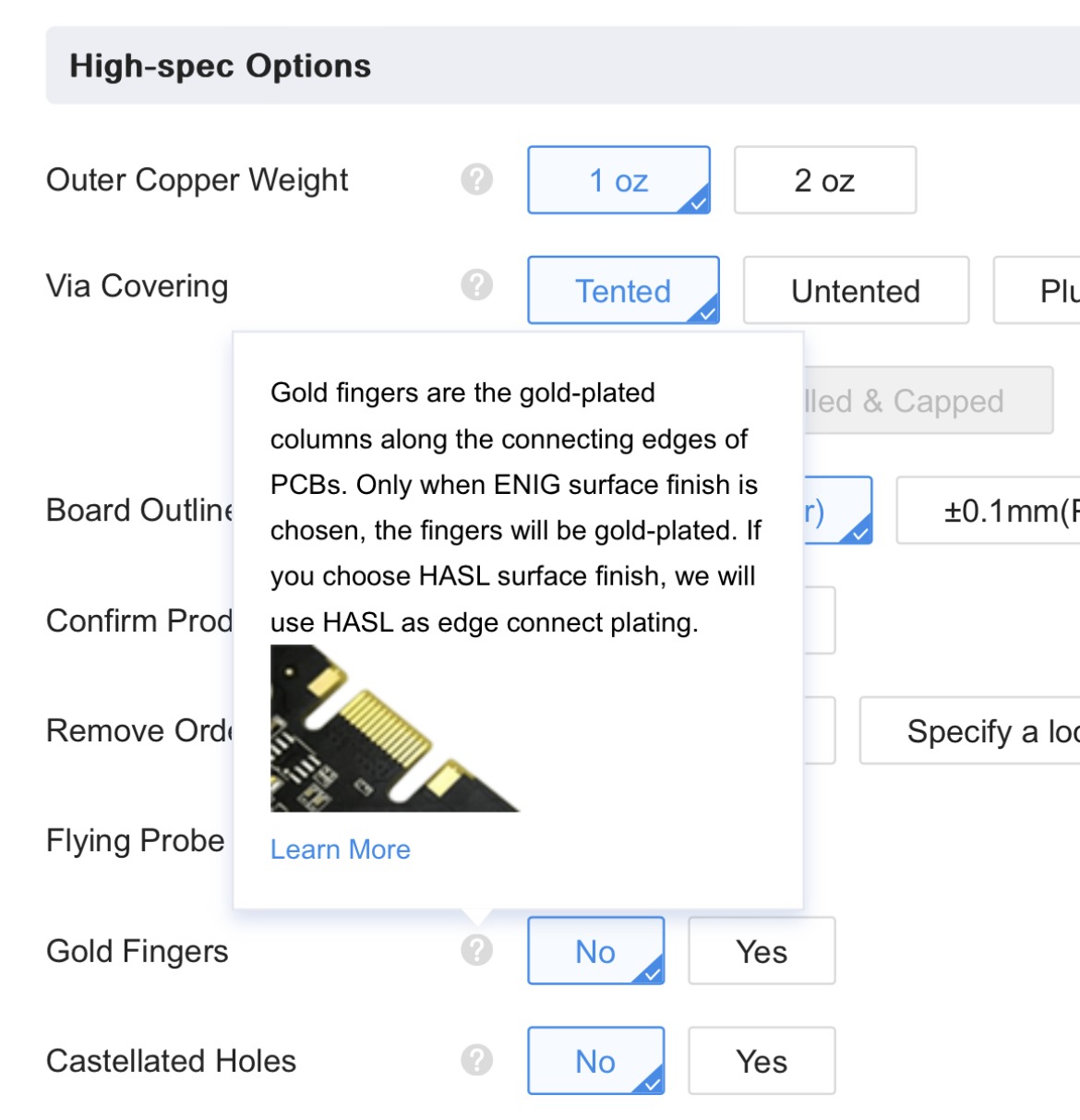

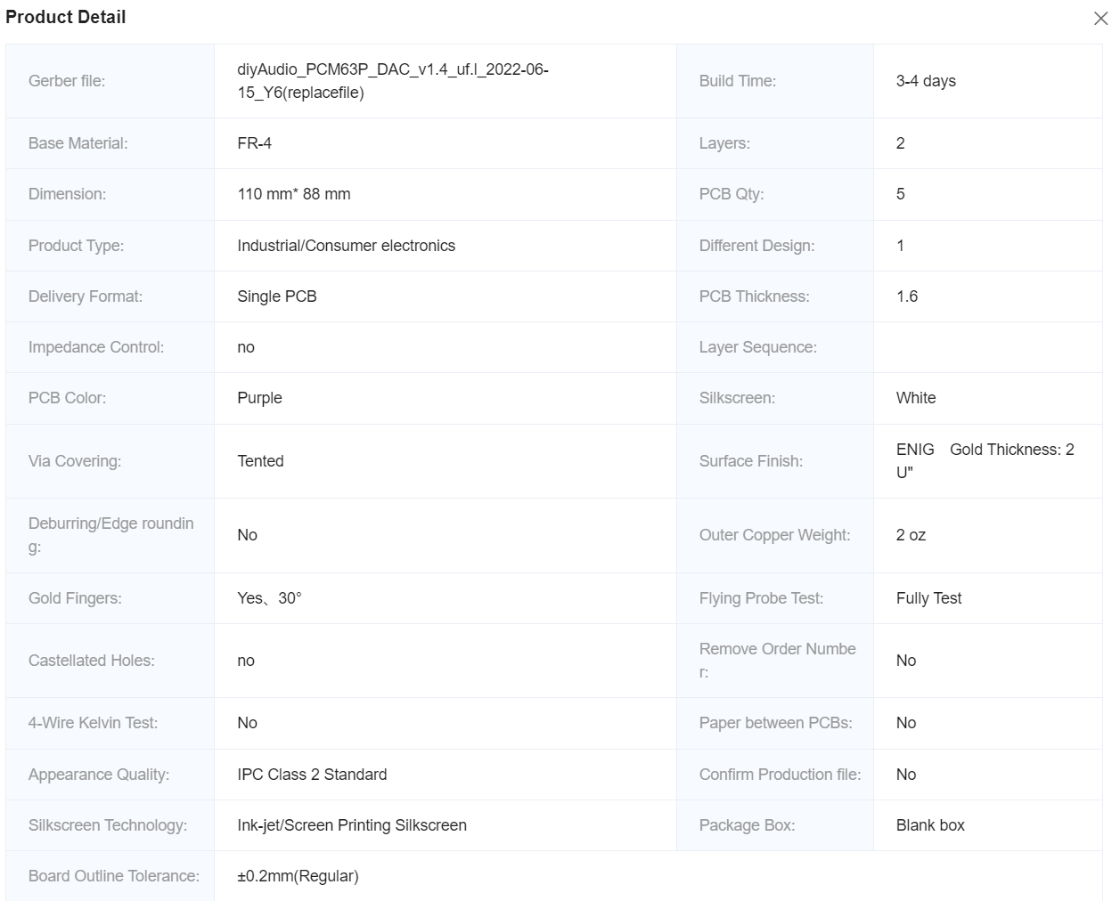

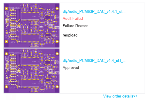

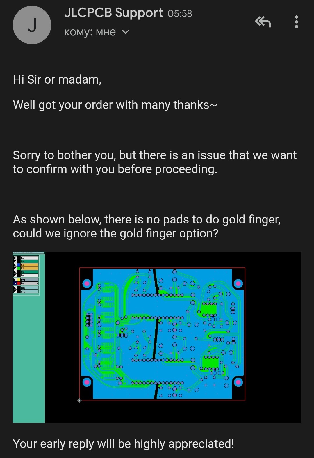

Hello!
sent for production, jlcpcb write that there are no pads...
what is it, can you ignore them?
Thank you!
Thank you!
I have no idea what 'gold finger' is but I sent the same Gerber to the same place for fabrication just three weeks ago without any issues.
You selected gold fingers when ordering (you know those pcix connectors on graphics cards, those tiny connector pads), and you don't need them for this. You can proceed no problem.Hello!
Thank you!
Thank you!There is no ‘gold fingers’ on the pcb:
This is my first time ordering so I'm wrong.
Now I will recreate the order with new parameters
