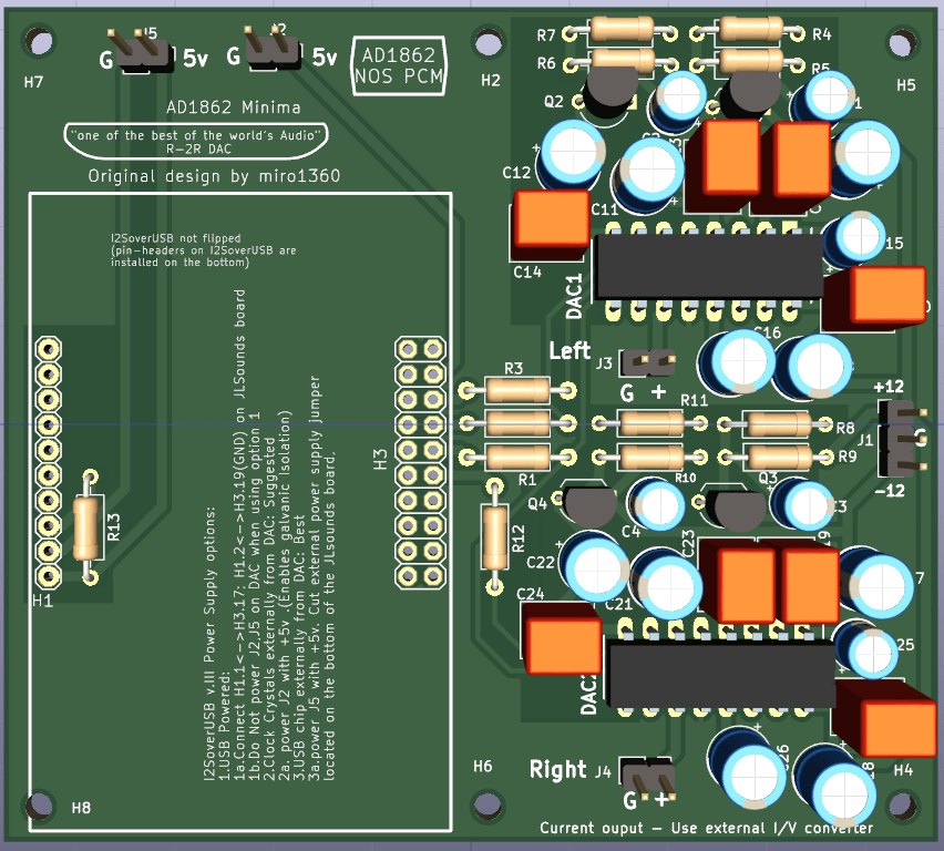

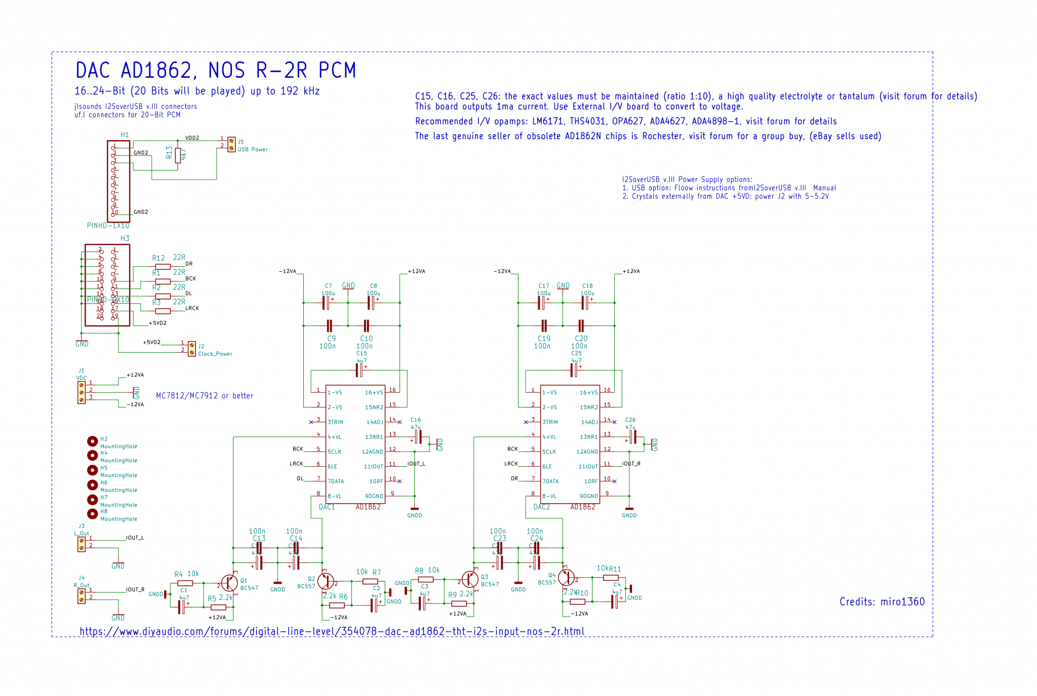

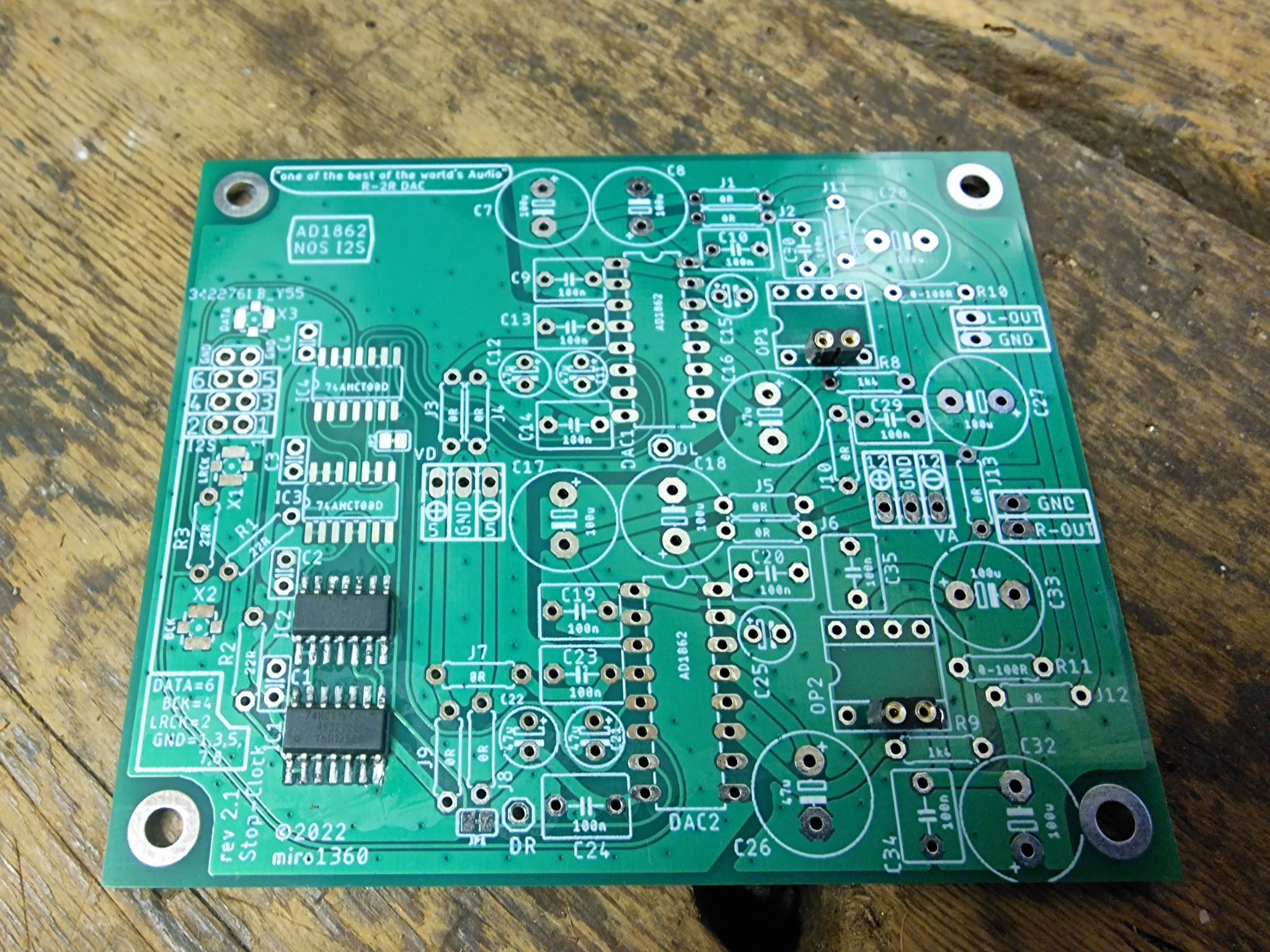

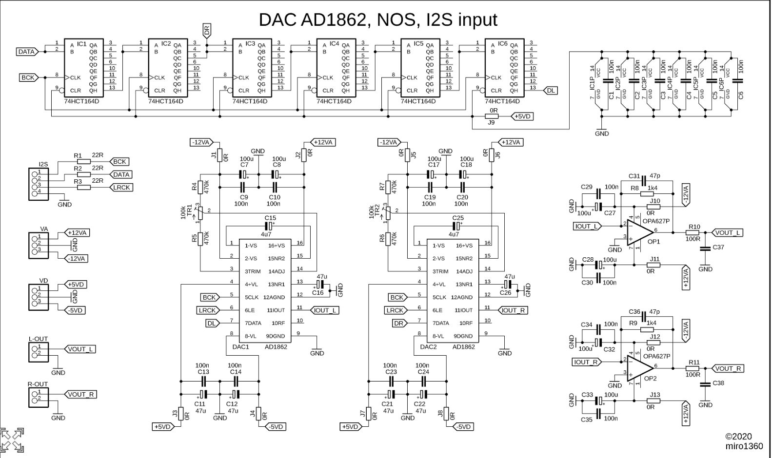

Presenting a minimalist version of AD1862 DAC.
Based on JLSounds version of Miro DAC.
1. DAC works on +/-12v rails simplifying power supply requirements
2. Digital and Analog Grounding is in line with Spec sheet
3. Removed MSB trimmer and u.fl connectors as they seem to have been used very little.
4. Moved I/V conversion out of the board to enable tweaking.
Can be turned into a dual mono version if anyone is interested
Credits to Miro for original design.
Mallik

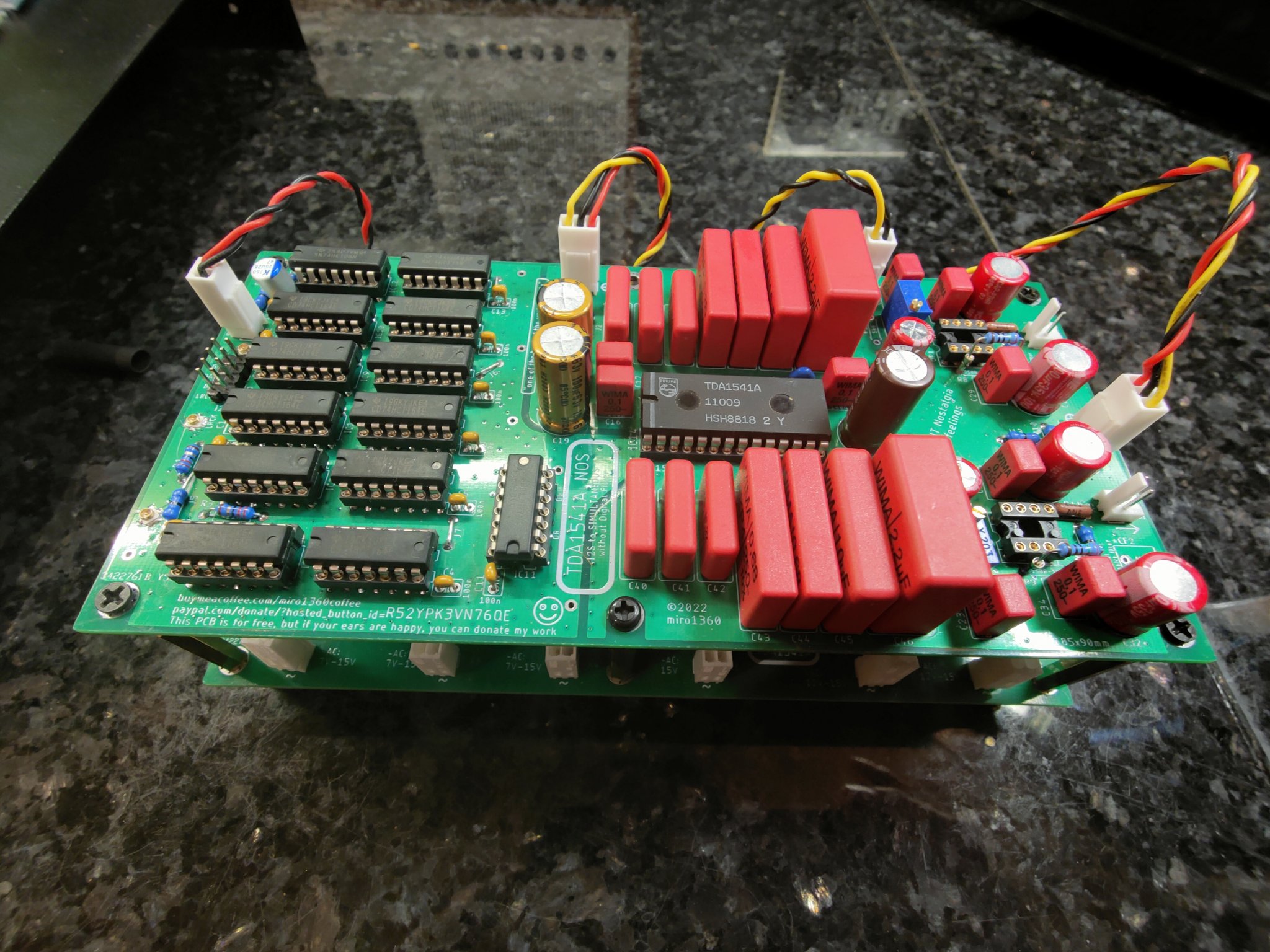

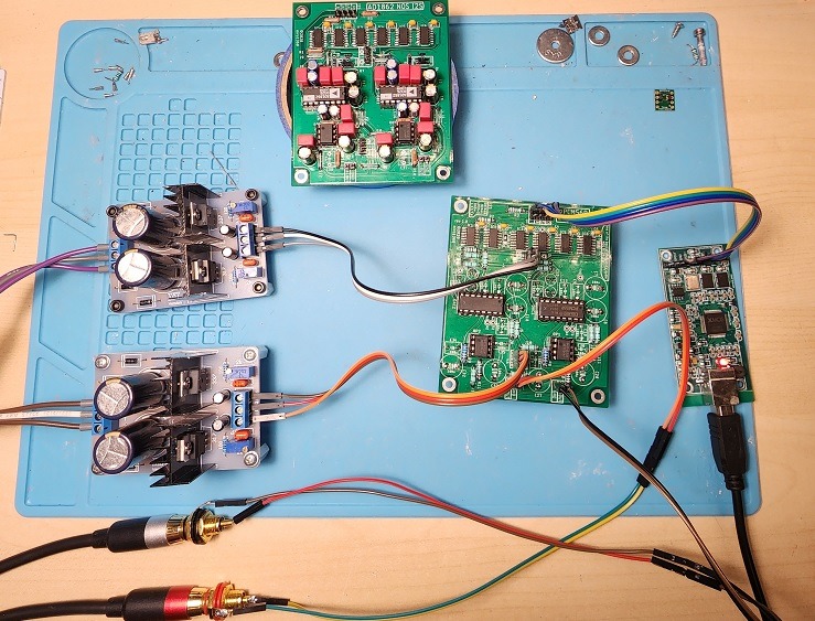

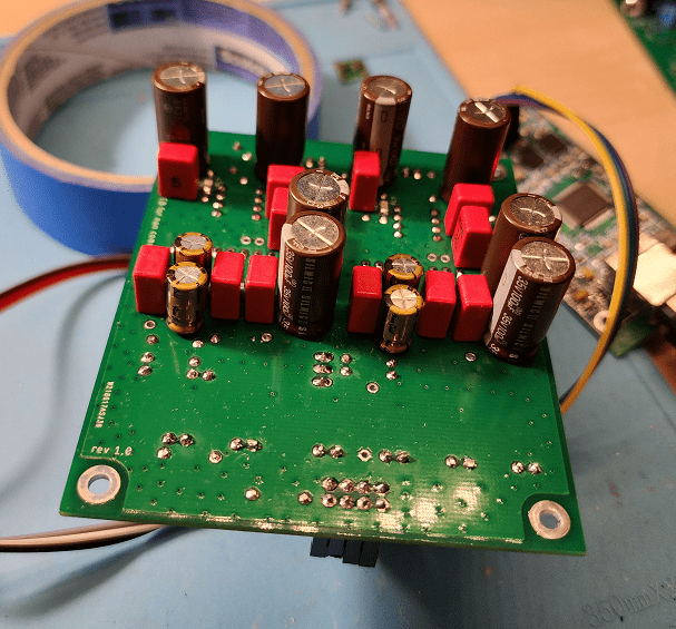

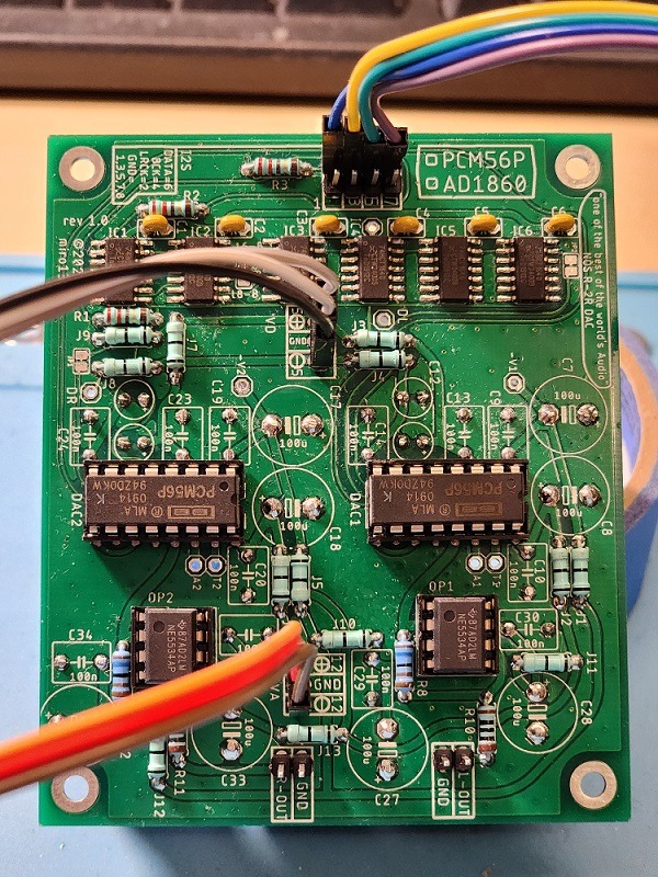

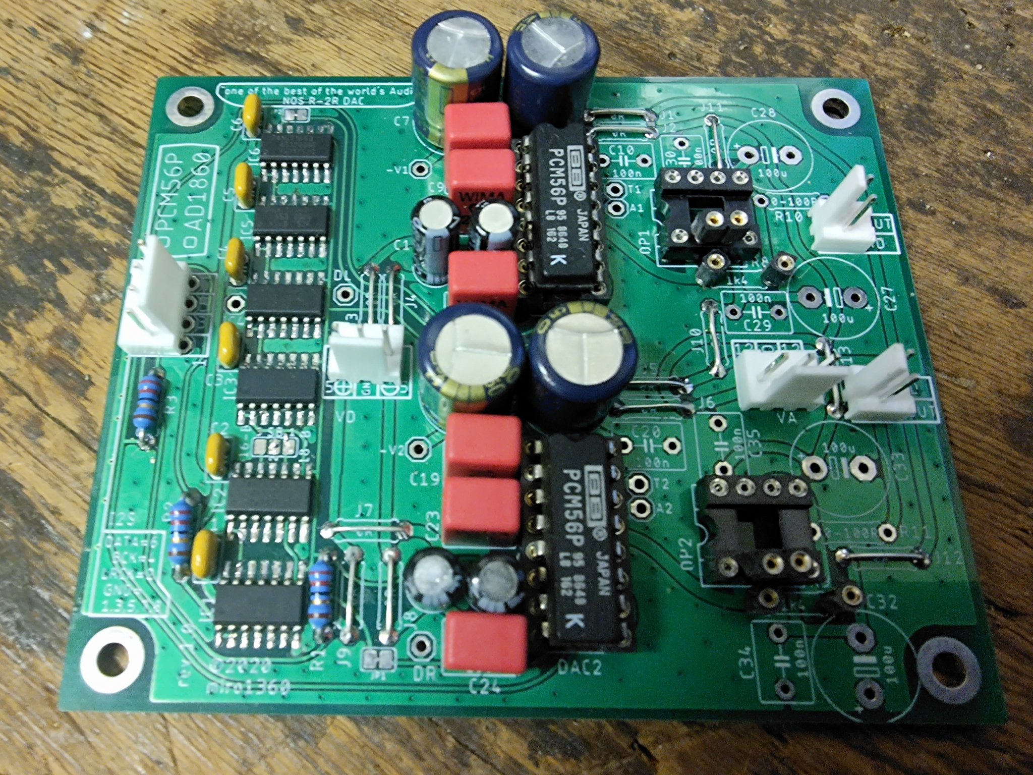

Joined the PCM56P club now as well. Mounted most of the caps on the underside but will take a break before I do any I/V experiments. Used the opportunity to try out T-962 reflow oven to solder the level shifters, which worked out very nicely but you have to be sure to clean up solder balls afterward. Thinned out the solder paste and applied in strips and didn't get any bridges but touched up a few pads on the end of 3 rows. Fired up on first try so I'm very 😊
Thank you miro1360!

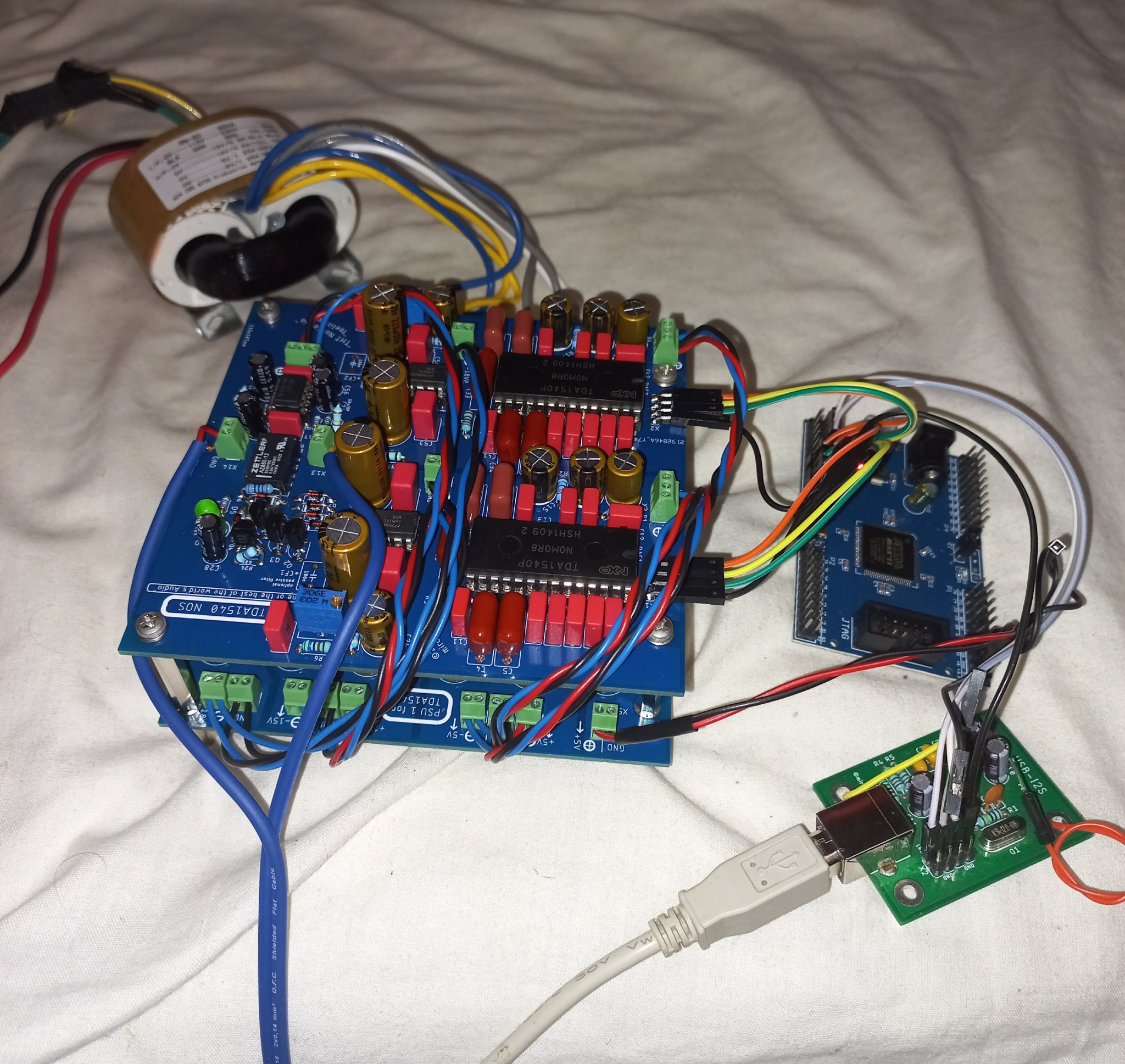

In the last few days I have been testing the promised TDA1540P :hphones:
It works nicely, no audible digital distortion, no glitches. The sound is very dynamic (slightly harder with strong bass, the bass guitar is very much alive :yes:)
Power supply is compact and stackable. The input is standard I2S as always (but you need to programm the CPLD converter with my VHDL program, no worries - step-by-step tutorial will be included).

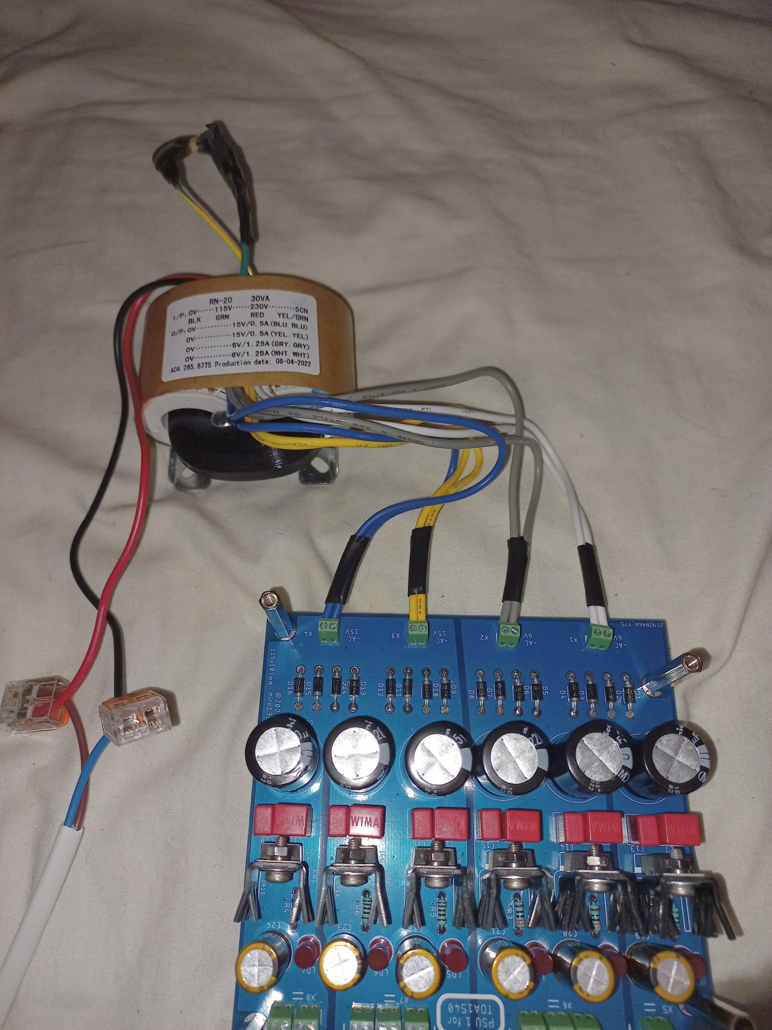

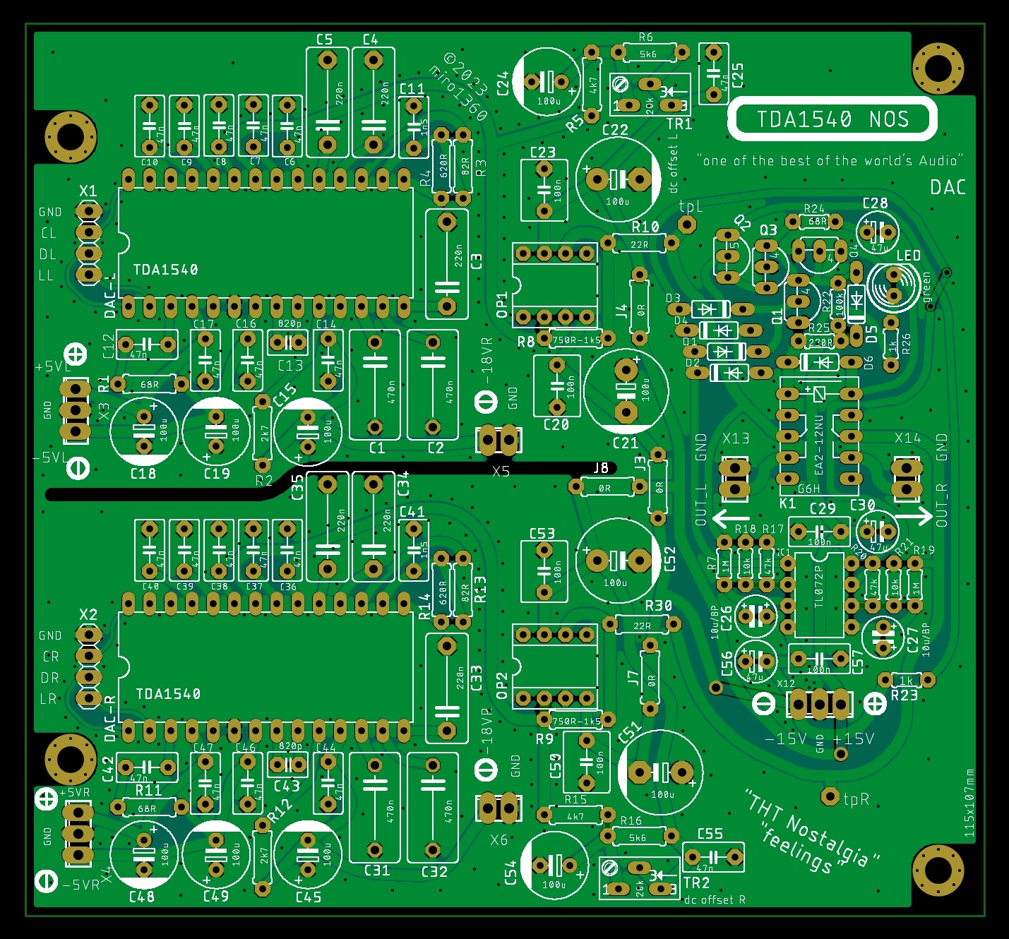

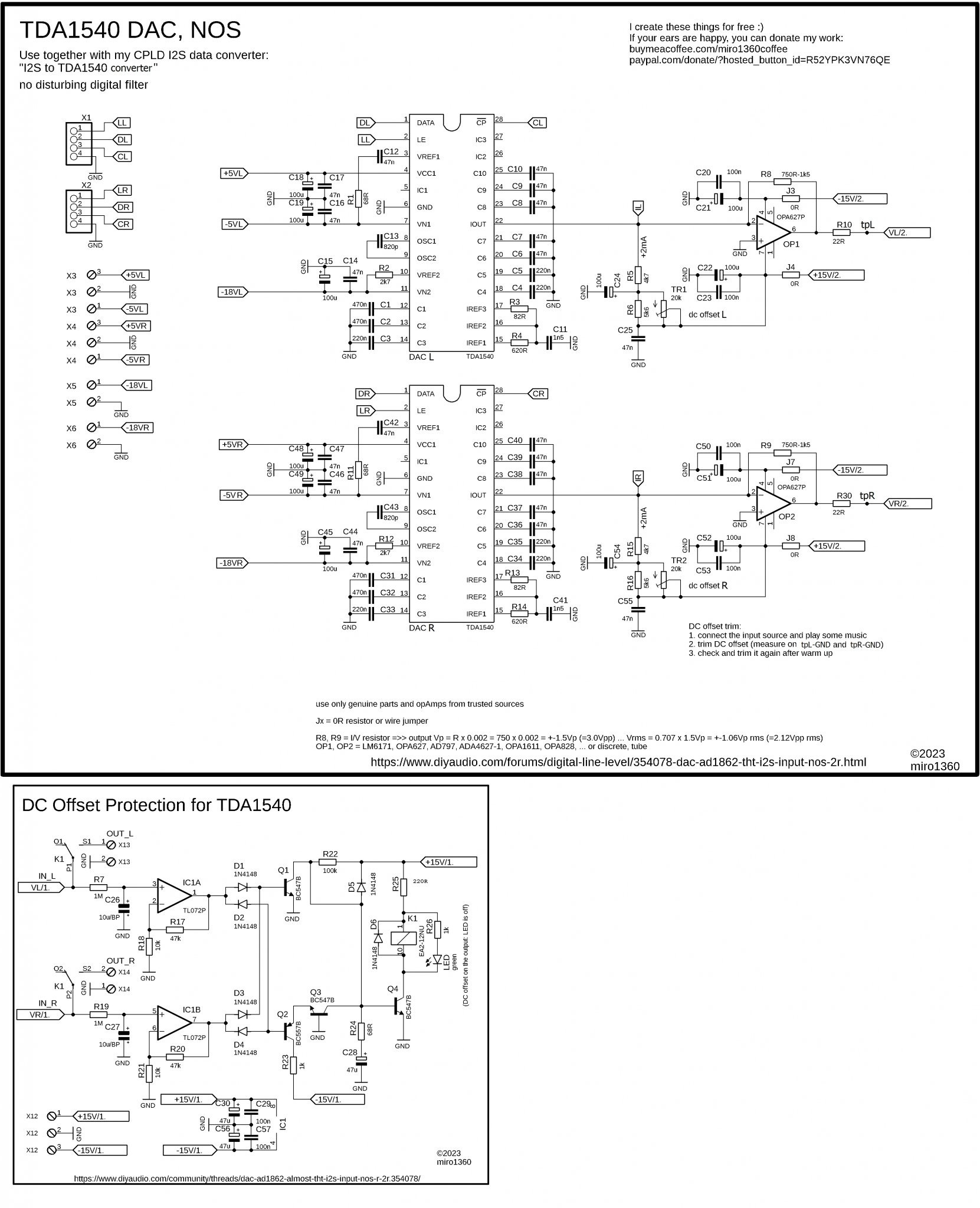

TDA1540 NOS DAC :hphones:
  • NOS, without digital filter
  • simultaneous input (with external I2S to TDA1540 converter)
  • integrated DC output protection
I2S to TDA1540 converter for this DAC: I2S-TDA1540
Power supply is shared in the next post and PCB has the same dimension (can be stacked).
Null DC output voltage:
1. be sure that programmed I2S to TDA1540 converter is connected with TDA1540 DAC and I2S input source is turned ON
2. turn-on DAC and play some music, stop the music
3. measure DC offset between tpL and GND, null it with trimmer TR1
4. measure DC offset between tpR and GND, null it with trimmer TR2
5. the green LED should light up (output is active == no DC voltage on the output is present)
6. try the music on speakers or headphones
Measure it again after warm-up and check it in the future.
DC output voltage can fluctuate a few mV.
If TDA1540 DAC is turned ON with disconnected I2S input source (or the I2S source connection is lost), then DC on the output is present and DC protection kicks in (do not adjust the voltage this time, just connect the I2S input source and it resets to zero, this is normal function of TDA1540).

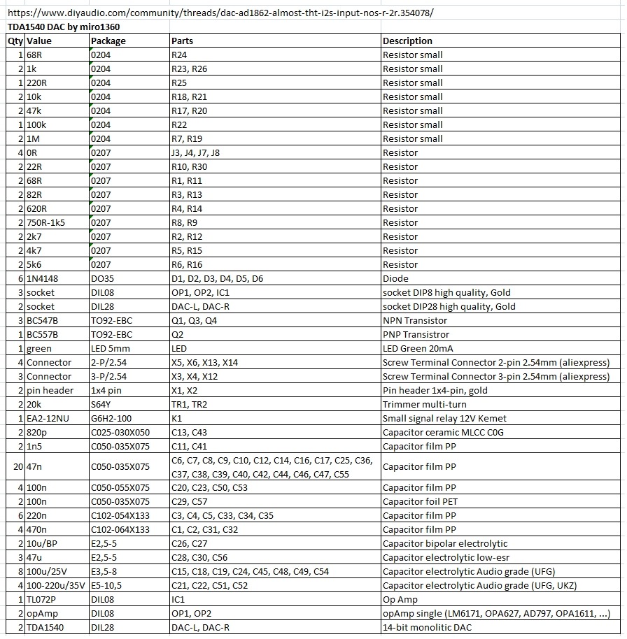

BOM example:
https://www.mouser.com/ProjectManager/ProjectDetail.aspx?AccessID=495d7a1474
connectors 2-Pin, 3-Pin: https://www.aliexpress.com/item/4000867583795.html
R-Core transformer: https://www.aliexpress.com/item/4001293182295.html
relay if not available on mouser: https://www.tme.eu/sk/en/details/az850-12/miniature-electromagnetic-relays/zettler/

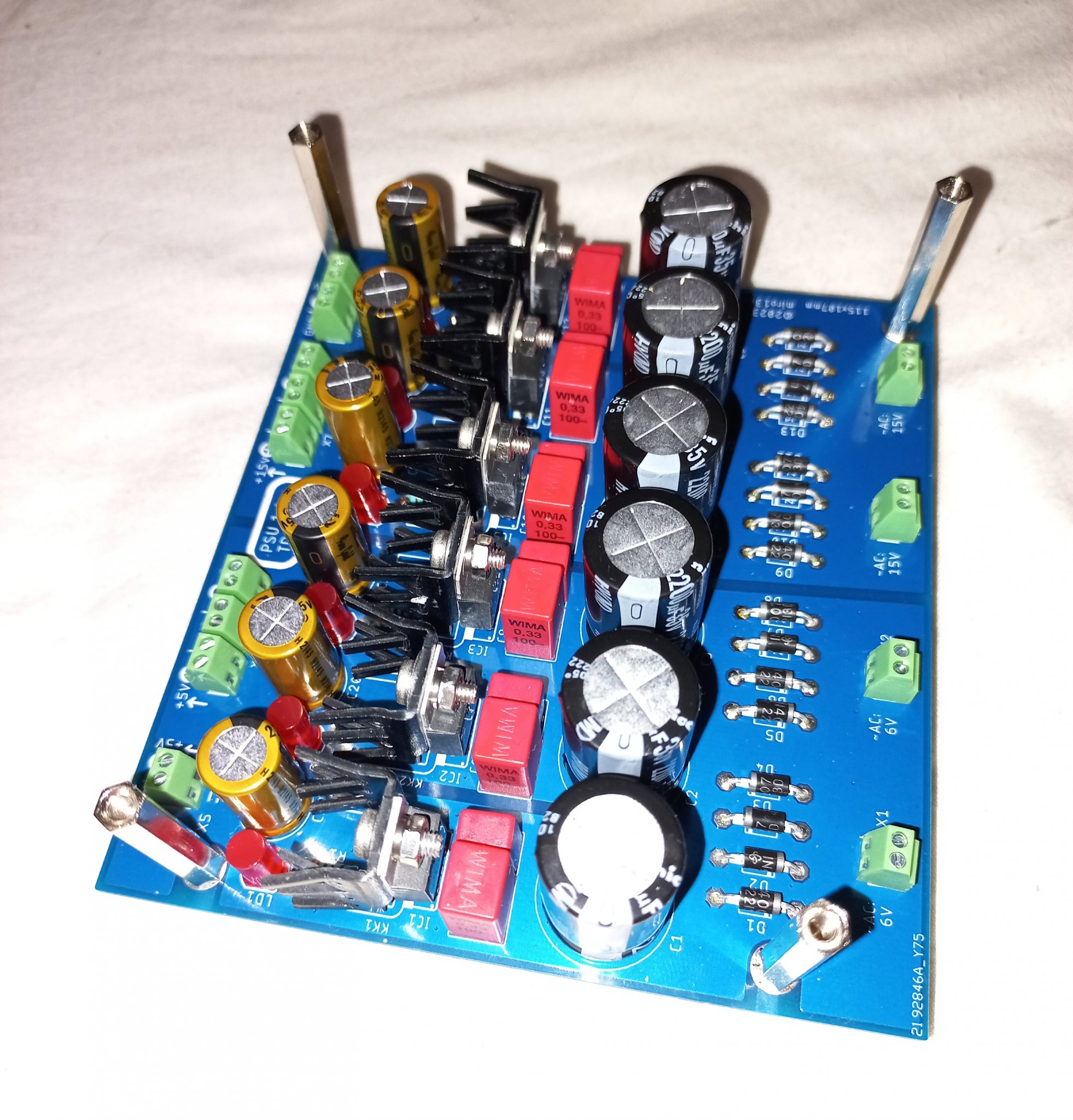

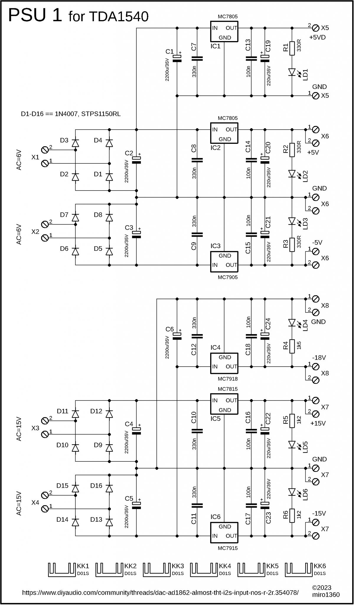

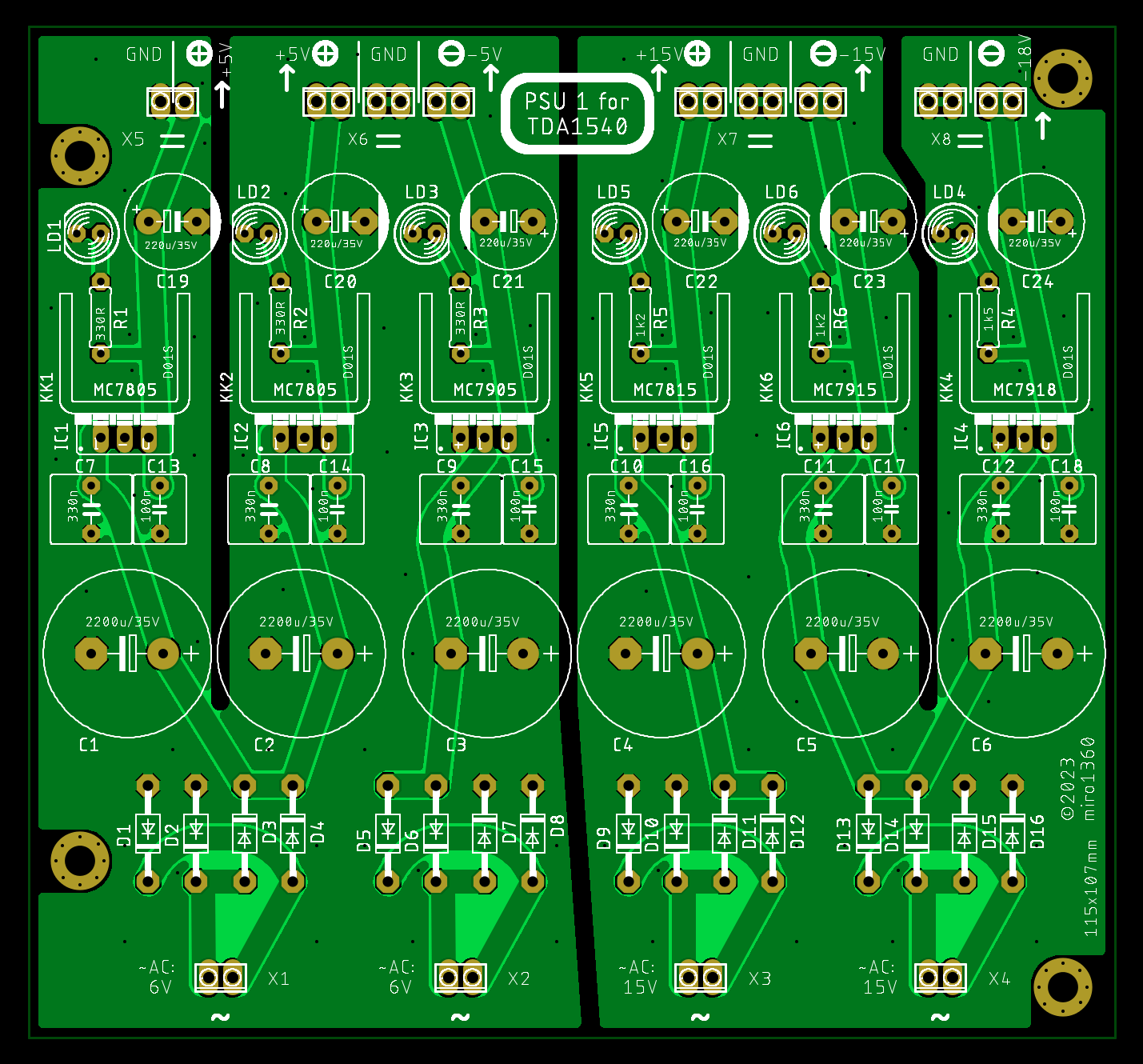

PSU 1 for DAC TDA1540
  • PCB has the same dimensions as DAC, so it can be stacked
  • Grounds are already separated for best results (connected in DAC PCB)
Use only high quality components (low ESR and Audio capacitors).
78/79xx regulators from onsemi (MC78xx/MC79xx, be sure you get these).
You are working with mains voltage, so very careful because it can be deadly and no one is here responsible for your life and health :Pirate:
Build hints:
  • start with diodes, resistors, connectors, LEDs, foil capacitors, big electrolytes
  • install heatsinks on regulators and put them into PCB (let a small space between heatsink and PCB)
  • triple check electrolytic capacitors polarity
  • install AC wires from transformers (you can first try them and measure AC voltages)
  • triple check everything (especially solder joints (cold joints, bridges), regulator ICs positions)
  • put on safety glasses, turn it on and hide for a while (watch for smoke or explosions LOOL 🤣)
  • if nothing bad happens, touch electrolytic capacitors if they are cold (touch also heatsink - it can be warm because there is small current consumption, but not very hot)
  • now measure DC output voltages (and also AC input voltages)
  • turn it on and off a few times, everything should work without further settings

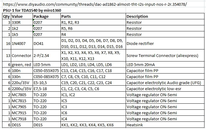

BOM example:
https://www.mouser.com/ProjectManager/ProjectDetail.aspx?AccessID=49b4bec728
heatsink: I have this D01A https://www.avelmak.sk/index.php?lm=1435&pg=det&article=38184 (13.2 x 12.7 x 19 mm, 21K/W) ... you can find alternative on aliexpress or from another local distributor
connectors 2-pin, 3-pin: https://www.aliexpress.com/item/4000867583795.html
https://www.aliexpress.com/item/1005002952338852.html (30mm or 35mm M3 screw spacer)
https://www.aliexpress.com/item/1005004127890102.html (15mm M3 screw spacer)
https://www.aliexpress.com/item/1005003411992910.html (M3 screws)
maybe a few M3 gaskets ...
missing components can be found on tme.eu or from another distributor
