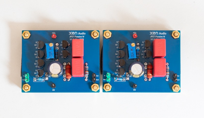

Over the course of a week, I listened carefully to 5 different IV stages. These were played in different orders over that week, but with the same tracks on each occasion to try and avoid patterns.

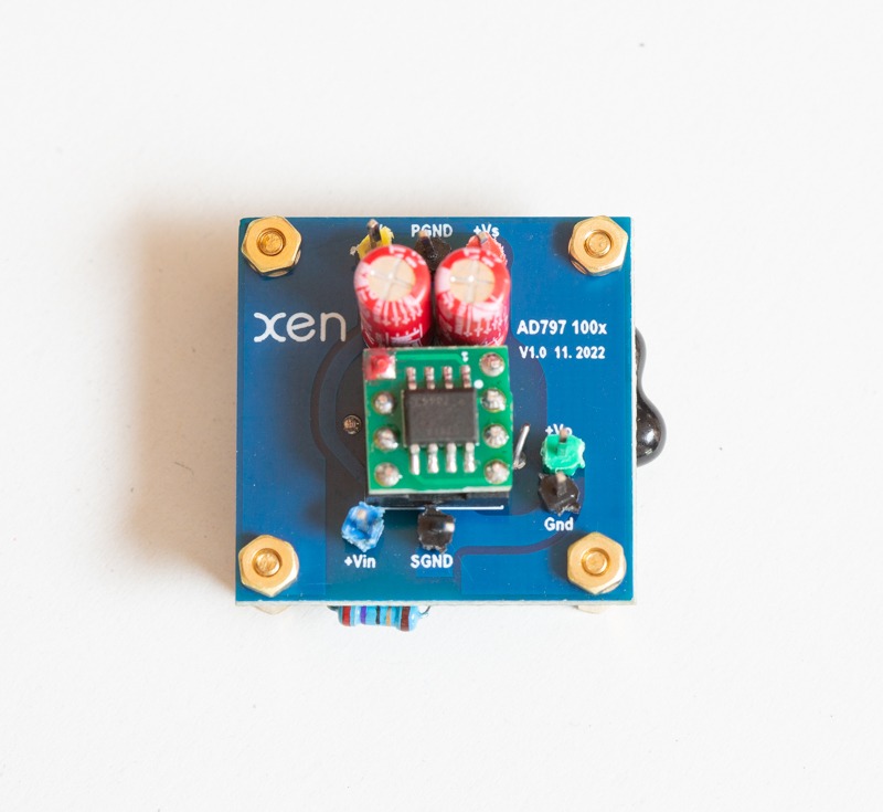

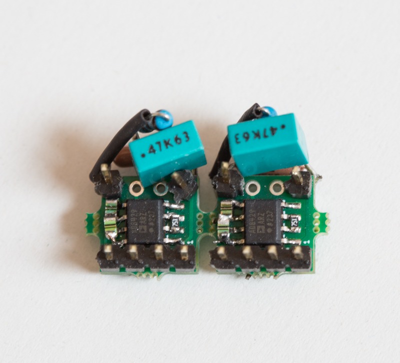

First up is a passive IV stage using the AD8429 opamp - an instrument amp with 3 opamps inside, has high input impedance and negative feedback . The IV resistor is set at 27r, and the opamp configured for 100x gain, and powered by a +/-15V low noise supply from diyinhk.com. This delivers a really smooth gentle refined sound. In my set up the soundstage from side to side is excellent, but not as deep as some others. Excellent sense of ā€œblacknessā€ between the notes very evident in more sparse music. I would say overall this is a more refined laid back sound – if you had a partnering system that tended to be a little harder then this could be a perfect match. I built this on some adapter boards, and given the low parts count this turned out as a very compact size.
Next is another passive IV-opamp stage but this time using AD797, well known, single opamp with negative feedback. This stage is very similar to the AD8429, but vocals are a little more forward, and there is more sense of depth to the soundstage. I remember thinking as I listened that it was impressive, and easy to build, low parts count. Either of these two stages would deliver long term enjoyment for very little outlay. Both opamp based stages were powered by the same supply.
The next IV stage is a discrete jfet IV stage, and powered by a Salas ubib shunt supply. This has no negative feedback, has output coupling caps, a single ended circuit with H2 dominant and not the lowest distortion ever. This stage is a little unusual, in that sound changes a little over the first 15mins or so – I waited at least 20mins before listening. You can imagine that this alone creates bias – I suppose so does everything. The scale of the soundstage is bigger here than with either of the opamp stages. Side to side width is about the same, but there is more front to back depth. Vocals, although bigger (due to the scale) I think are a tad softer than with the passive IV opamp stages, and piano is a little more dynamic, key strikes carrying more impact. There is more recording ambiance here too – say the slight reverberation you hear in a recording.

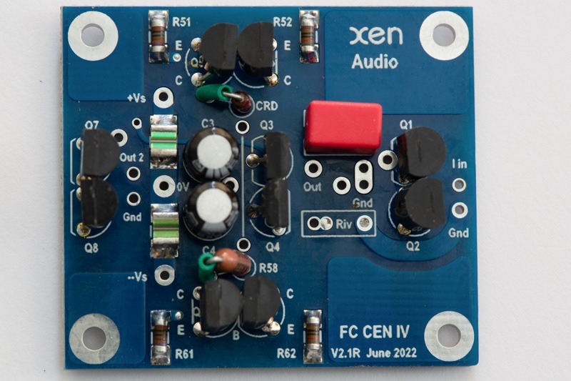

Next up is the FC CEN IV discussed elsewhere here, a JFET push pull current conveyor with no negative feedback and DC coupled at input and output – which in short I consider sonically to be the equal of the 3a5 reference stage. In other ways it is far superior – cheaper to build, quieter, less prone to noise pickup, tunable Sallen-Key filter to name a few. If I hadn’t built the 3a5 stage before FC CEN was available, I would never have made it. Bass is tight and with lots of texture. I believe there is more presence here than with other stages (ie the illusion that the performance is in the room) but I would think this is extremely subjective. This is a standard to aim for, it is at the top of the list – and over the last few years I have made and listened to a lot of IV stages, all with the same DAC and associated equipment.
I want to add that I am listening to these and searching out differences – the things I am pointing out above are generally small differences, and honestly are not that easy to determine. The differences between both opamp stages for example are really tiny. Having said all that….. 3a5/FC CEN IV remain at the top of the pile for me, then jfet behind by a small but definite margin, and the both opamp stages together. I would think that different power supplies might make a difference to that running order. I think the passive IV with AD8429/AD797 would make a great alternative for someone who wants to keep the small footprint of the Miro DAC onboard opamps (and supplies) where the JFET and FC CEN are more involved builds and need their own supplies

A few notes perhaps on passive IV.
People will tell you that current-out R2R DACs need to see a virtual Gnd. Hence the usual opamp IVs. But many of them actually work quite well with a small load impedance. For example in this tutorial by Analog Device, a 25R IV resistor is used :
https://www.analog.com/media/en/training-seminars/tutorials/MT-019.pdf
If we use a 27R resistor directly at the output of an AD1862, we shall get +/-27mV output. Amplify this by 100x then gives you about 2Vrms. The question is then how to do 100x amplification.
The easiest is to use a low-distortion, low-noise, low-DC-offset opamp, such as AD797 or AD8429, as they are used e.g. in phono preamps. The AD8429 is especially easy as the gain can be set by a single resistor. The AD797 has slightly better performance, so choice is more subjective. But both have good PSRR and can work with say +/-12V. So this makes them very easy to use in this particular application. And now you can do resistor rolling as well. Anything from Beyschlag MELF, Nikkohm RP-44, to Vishay bulk foil or fancy wire-wound resistors, the list is endless.
The discrete JFET gain stage is essentially also a 100x voltage amplifier with a tube-amp like topology. Which means it also has all the drawbacks such as no PSRR or capacitive output coupling. But it is H2 dominant, which gives you this tube-like sound that some prefers. As it is using all active components, it is low cost and fun to build. Only requirement is a low noise power supply, like the Didden super-reg. The otherwise excellent LT3045 will not do the required 32V output. What a pity.
Anyone want to do Beta-test, Fran has some boards left, so you can contact him direct.
