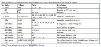

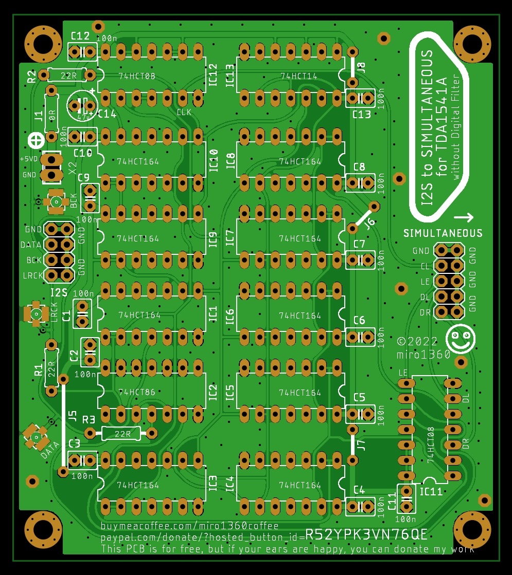

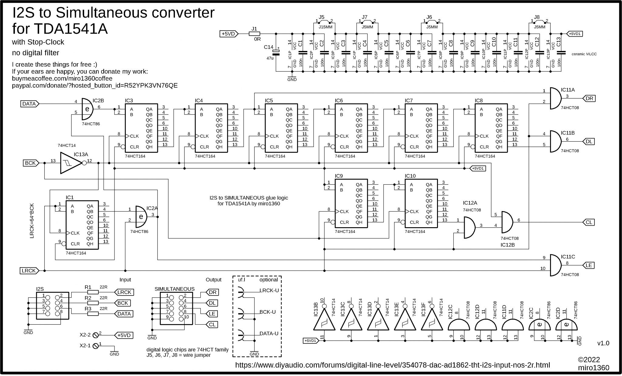

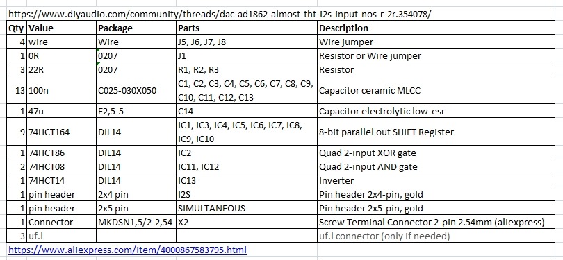

I2S to Simultaneous for TDA1541A by miro1360
I share separated input part for TDA1541A (it is the input digital logic alone from my TDA1541A DAC).
It may be helpful for someone who has a DAC or a device with TDA1541A in I2S mode or with digital filter, and want it simultaneous without digital filter.
  • all logic ICs are 74HCTxx type
  • start the build with wire jumpers (let paper thin space between wire jumper and PCB)
  • triple check everything (especially solder joints (cold joints, bridges), logic ICs positions)
  • make sure that the pin 27 on your TDA1541A board is connected with -5V (pin 26) to activate the simultaneous mode
  • diyAudio_I2S-to-Simultaneous_for_TDA1541A_2022-10-30.zip
