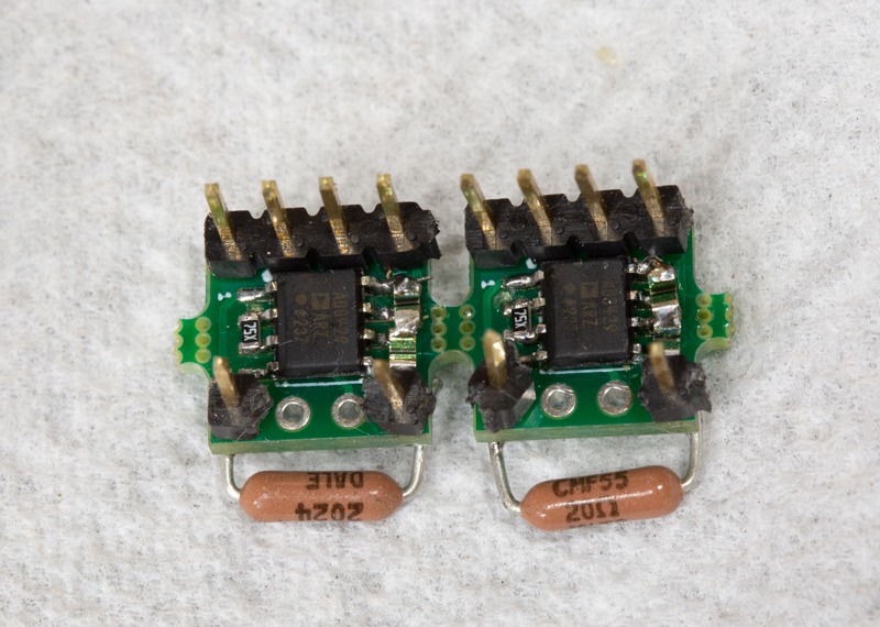

I mentioned earlier a passive IV resistor of ~27R and with 100x voltage amp using AD8429.
https://www.diyaudio.com/community/...st-tht-i2s-input-nos-r-2r.354078/post-7138645
Well, brave man tried and said it was much better than he expected.

Looks interesting, can you share the schematic?I mentioned earlier a passive IV resistor of ~27R and with 100x voltage amp using AD8429.

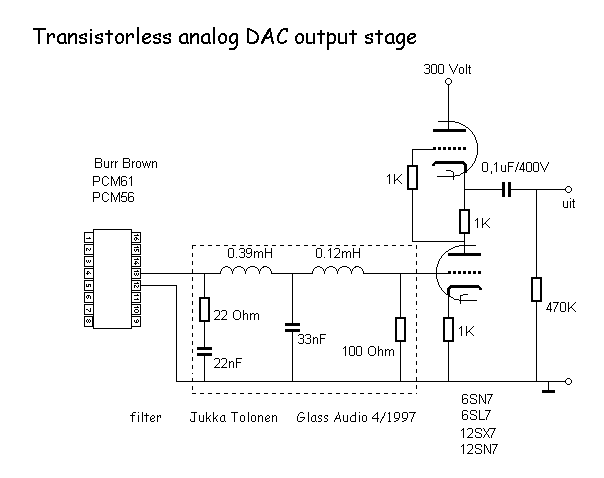

This is not so good approach... Current output of the DAC chip is loaded directly with Reactive load and then going to Riv.The schematics in #5381 has of course no filter, just a simple R to convert i to v.

After that is SRPP stage with local feedback (without Ck at Rk)
Value of Riv is large. And should be tested fist smaller values and appropriate instrumentation low distortion OP amp gain stage.
But maybe it could be achieved with smaller Riv because that Riv is in the same time a R load for the passive filter. Generator is the internal impedance of the DAC. That should be checked too.
Better way is
- first to determine right Riv value for each specific dac by measurements
- Make some slight HF filter with some C parallel at Riv to some higher F, to be slight capacitive load for the week DAC output but still nave moderate roll off...
- employ some buffer after the Riv stage. It is quite convenient to use some JFET simple SE buffer because of the +- 12V supply from the analog stage of dac. In this point is good to use passive filter of higher order following with the same buffer. Because Rg is from very high value in JFET gate as input.
- After that we have small signal but low impedance source. One option is to go with transformer for isolation + SE tube gain stage with tube buffer.
