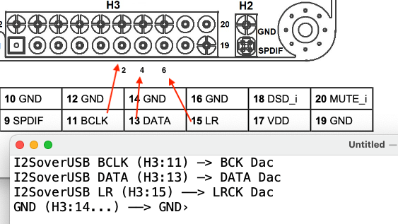

Does this also apply to PCM63 ? I have a hissing sound like a radio station - only with B3 😬The reference for DAC with glue logic still be this (without R1):
I2SoverUSB BCLK (H3:11) —> BCK Dac
I2SoverUSB DATA (H3:13) —> DATA Dac
I2SoverUSB LR (H3:15) ——> LRCK Dac
GND (H3:14...) ——> GND
But now in manual is section with different I2S protocols, do the following configuration from the page 5:
"JLsounds AK4396 DAC board I2S mode (old I2SoverUSB board)"
J3:Open, J4:Open, B1:Close, B2:Close, B3:Close, B5:Open
... this should be the standard I2S mode in 64-bit frame
Closed B1 B2 and B3. Still static noise. When play is pressed. When I change the frequencies, the noise also changes.@mikorist Exactly, close jumpers B1, B2 and B3
Noise is full stereo... Changed the USB cable, restarted the computer.. Checked I2S again 2, 4, 6 is H3:11 H3:13 H3:15
GND is shared because i have onother PSU 2 a separate one only for the digital part.
I have no idea what to look at next... I don't have an oscilloscope .... 😬
I mixed I2S - It is plaing nowClosed B1 B2 and B3. Still static noise. When play is pressed. When I change the frequencies, the noise also changes.

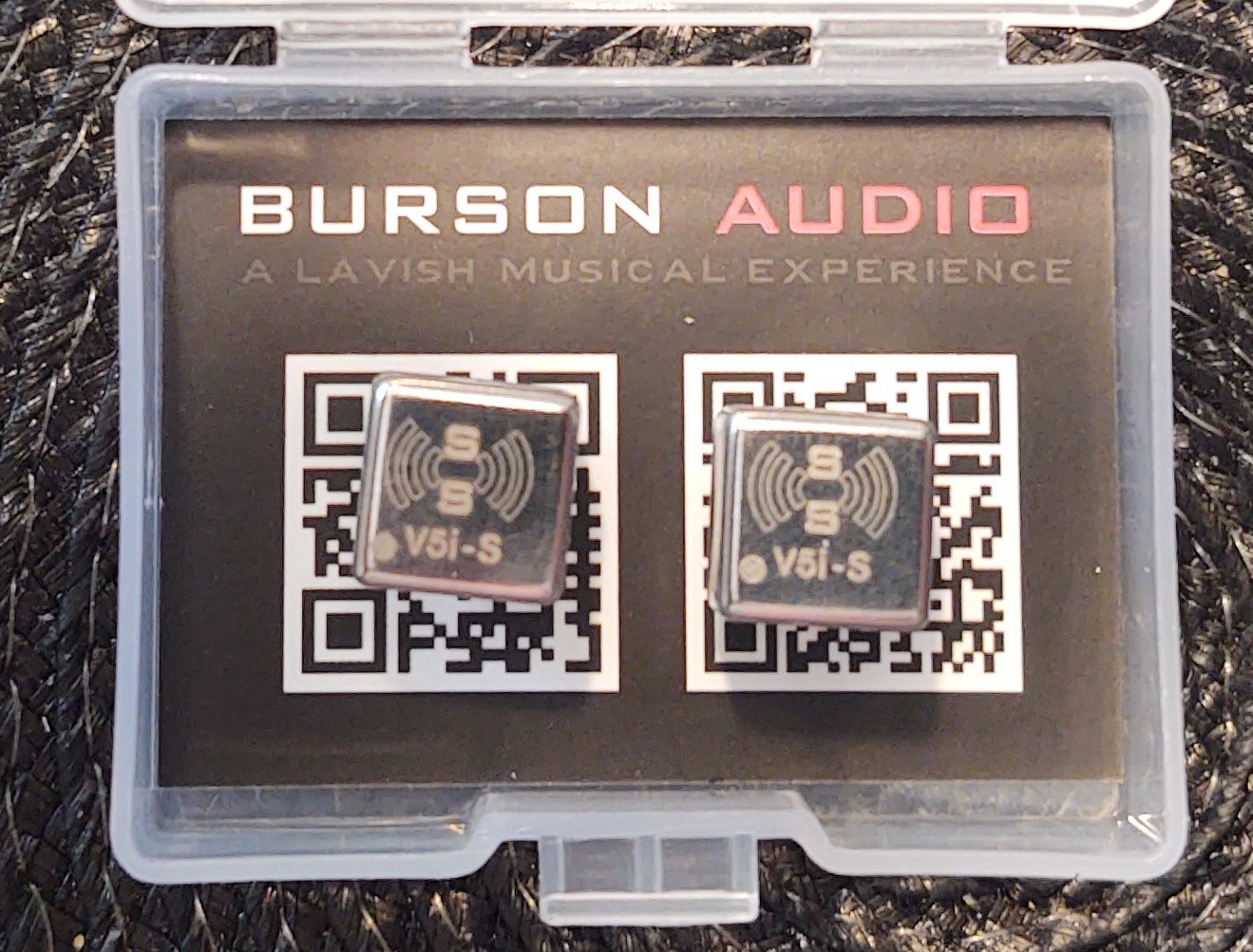

The nice folks at Burson were kind enough to send me a pair of their V5I-S hybrid opamps to try out. They seem to be a combo of a regular opamp and some pixy dust in a smaller more easily substituted size. I gave them a good listed today. Before the test I had some Sparkos labs discrete opamps in the I/V spot. I substituted in the Bursons and listened to the same song list. The Bursons are very nice and clearly bested the AD797, LME49710, and LT1363 opamps that I had on hand to try, of those regular opamps I liked the AD797 best. The Bursons were clear and on the warm side, nice detail, good soundstage, and good balance across the spectrum. Seemed to have less glare on piano than with regular opamps. I certainly could live with them and they are a worthy lower cost upgrade. However next to the Sparkos labs fully discrete some magic was lost. Flatter less holographic sound stage, not as liquid, and not as detailed across the board. The Sparkos are back in.
