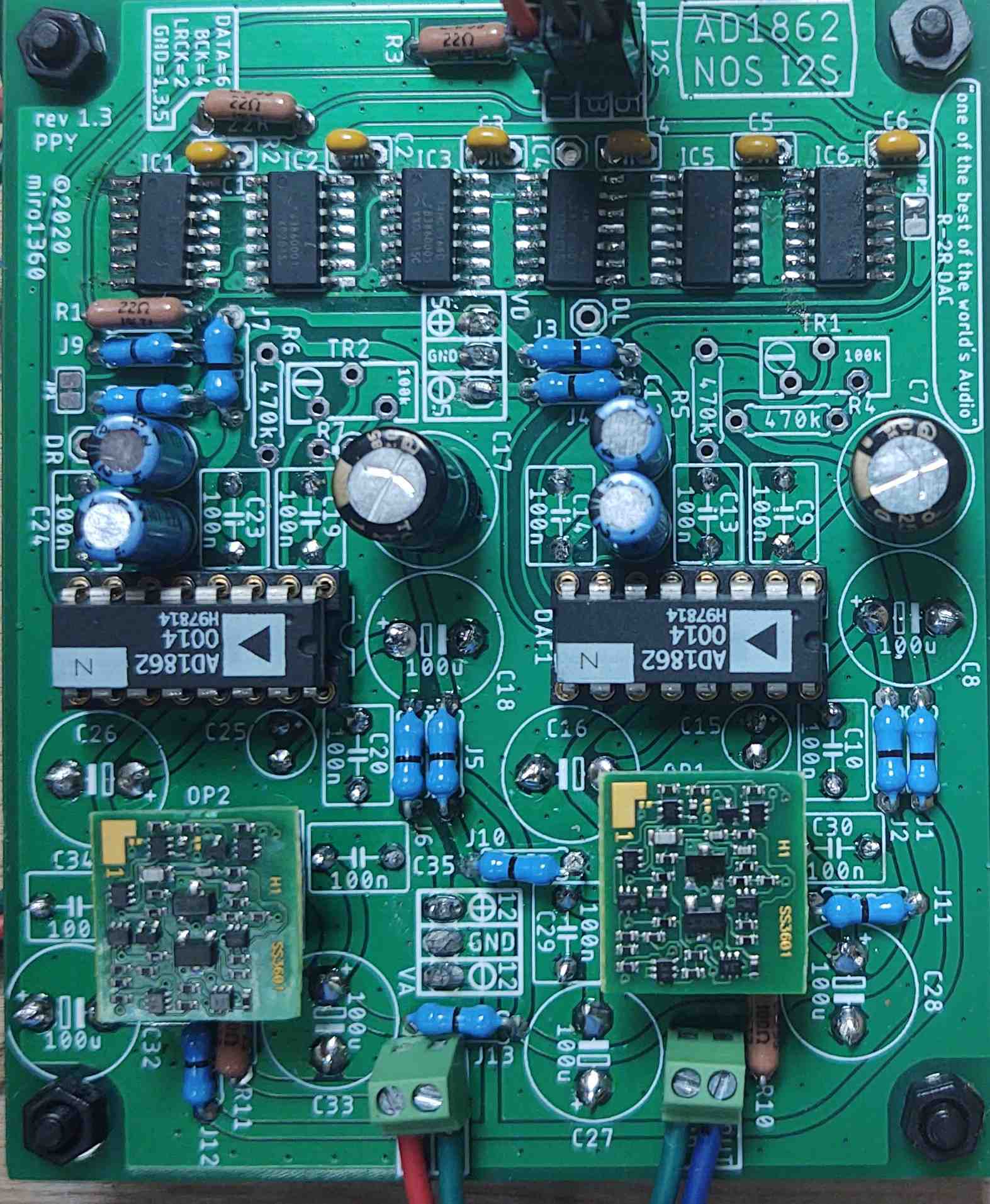

I just replaced the 797s with some Sparkos Labs discrete opamps and gave them a listen. Wow, a clear and easily perceptible improvement across the board, it really makes this DAC shine. The 797, and the other opamps I was planning to try are retired and not going back in. I am very impressed with this DAC, clearly bests all of my delta sigma DACs.

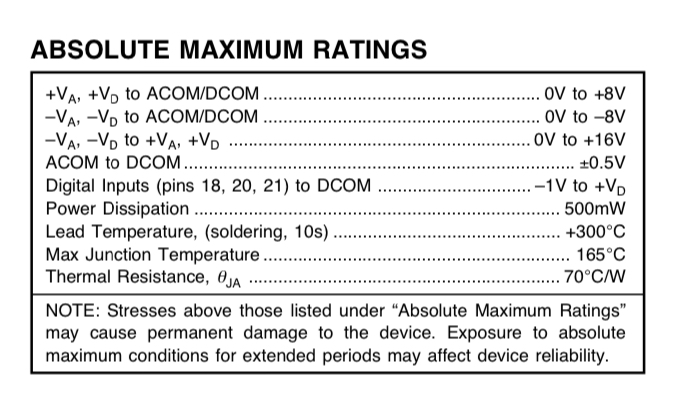

Is there an advantage to separating Vcc/Vdd in PCM63? Just to check.
There are guys on the board who have forgotten more about these parts than I’ll ever know, but given the architecture of the TI PCM DACs I would guess “no.”
Below are the data sheet max ratings, which you don’t want to violate on power-up, at a minimum.
The non-obvious mod to the 63 was IIRC a 2ma suck-out CCS on the BPO pin.
You can get D/S performance all day with op-amp or discrete circuits, pick your poison

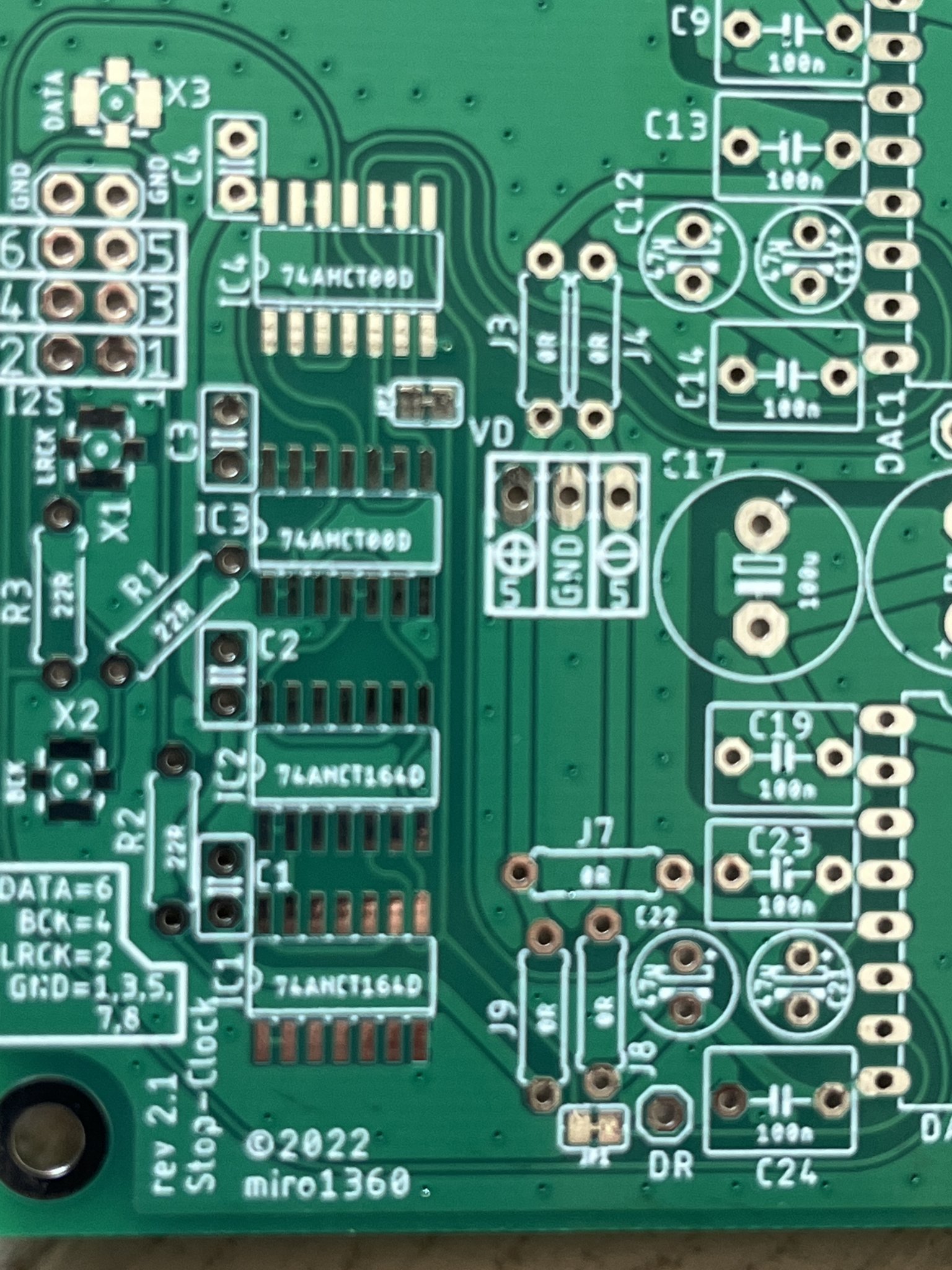

i just got some 1862/65 boards printed. However, I see that the Jp-1 and Jp-2 are already shorted.
Is this a QC issue from the factory; do I cut the traces before stuffing them? What options do they entail with/out the short
also, what are the x-1,2,3 socket mounted connectors called?
thanks in advanced
