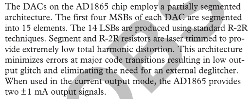

And what about AD1865 and PCM63, what is their internal structure?
AD1865 is mentioned everywhere as a pure R2R DAC. That's why it was first on my list, except that it's easy to get and not too expensive.
No AD1865 is also segmented dac structure. It is from datasheets. Someone alsi posted internal structure diagram...
PCM63 probably the same (but with 2 internal dacs in co-linear mode).
I had some internal structure modules i will try to find and post.

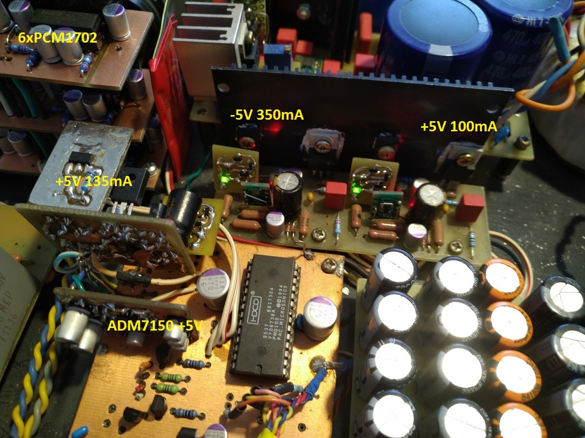

I've compared it to the ADM7150 and a lot of other regulators (serial and shunt) in my DAC and Walt's shunt beats them all in the HF area and noise ( visible on the scope) . I also use it as a regulator for the PMD100 filter.
Igor
What is happening when these regs are far from the load VS another more little IC reg less good in but ultimatly nearer or close from the load ? Impedance, inductive long traces... long current loops...
Which one is winning when it comes to the listening test ?
Honestly, I don't know. I always make sure that the distance from the regulator to the load is as small as possible, regardless of whether it is ADM7150 or Walt's shunt. For shunt I usually make small PCBs that are easy to place up to the load itself. For my new DAC with TDA1547 on the main PCB there will be six Walt shunts right next to the load.
All this is excellently explained in the book ANALOG-DIGITAL CONVERSION by Walt Kester and one of the contributors to the book was Walter Jung.

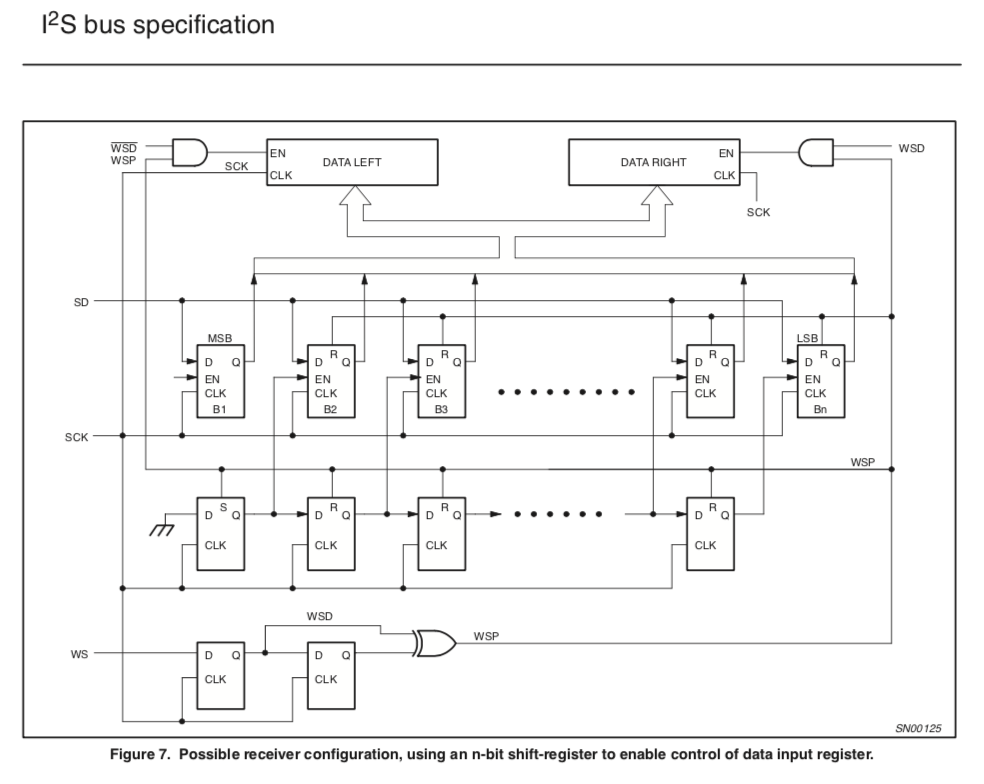

Hi Miro
please take a look in I2S Philips specification PDF.
Note WSP and WSD signals. They are essential for managing almost any digital bus.
In PDF given only WSP signal graphically. emulate WSD.
That can be of use to create WCKO (LE), and other events.
The circuits are not complicated to achieve.
