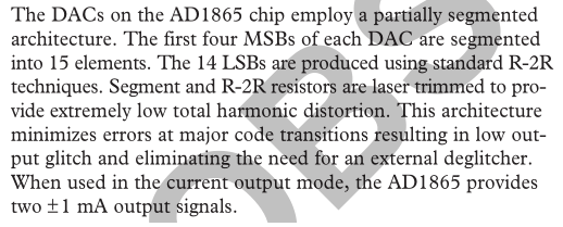

Yes again thermometer coding. But from the note it is first 4 MSB. N=4 (2**N)-1=15.
So AD1865 has first 15 MSB "DSD" and 18-4=14 LSB R2R. Almost half of the MSBs are from segmented part.
Since AD1862 from internal structure have 3 MSB N=3, (2**N)-1=7 encoded to Thermometer code.
AD1862 have frst 7 MSB "DSD", and 20-3=17 LSB are R2R.
For first 5 MSB binary - 31 MSB thermomether... To havy and complicated to implement
Imagine how long will be segment form all 16 bits encoded from binary to thermomether.
(2**16)-1=65535 bits word...

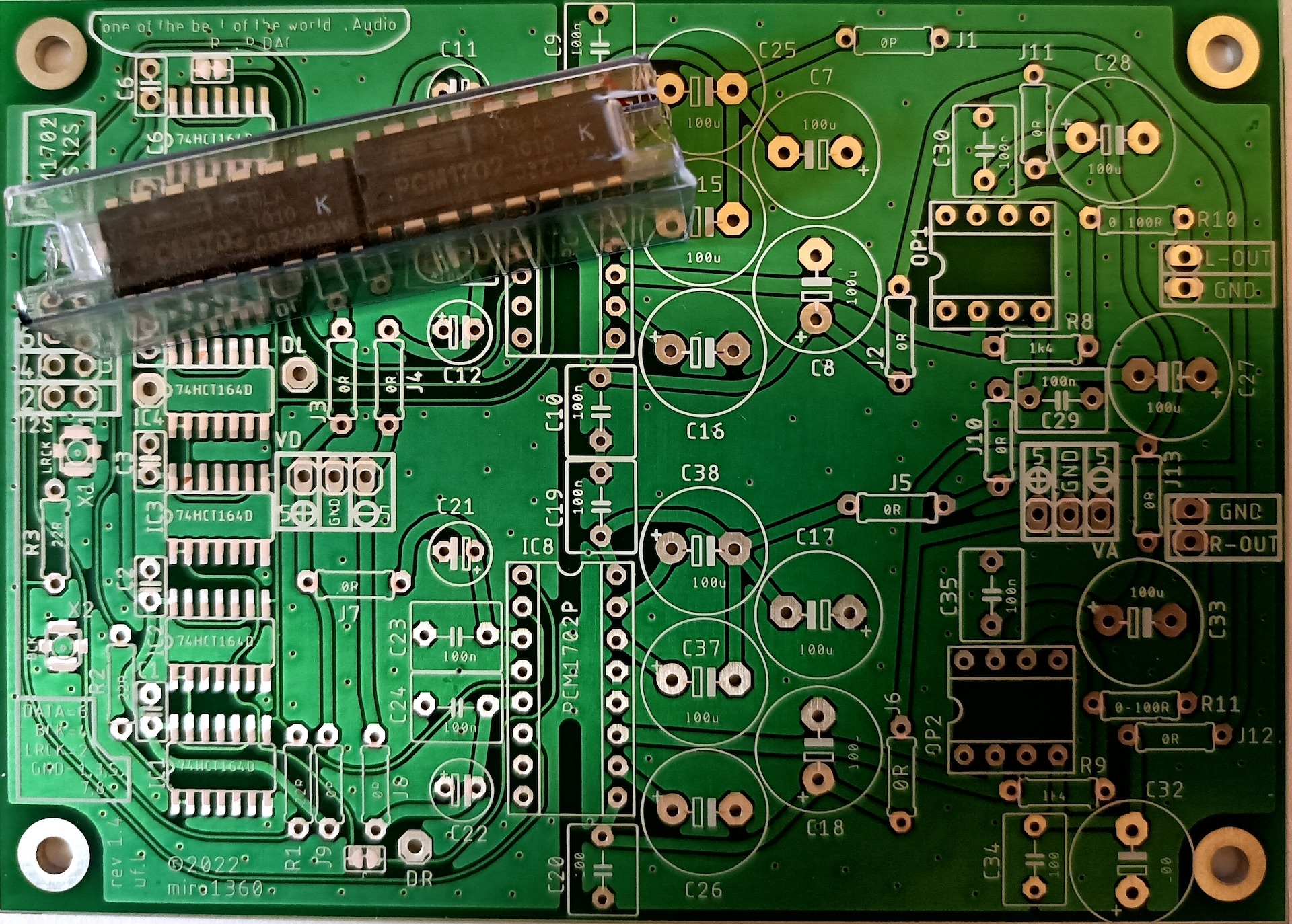

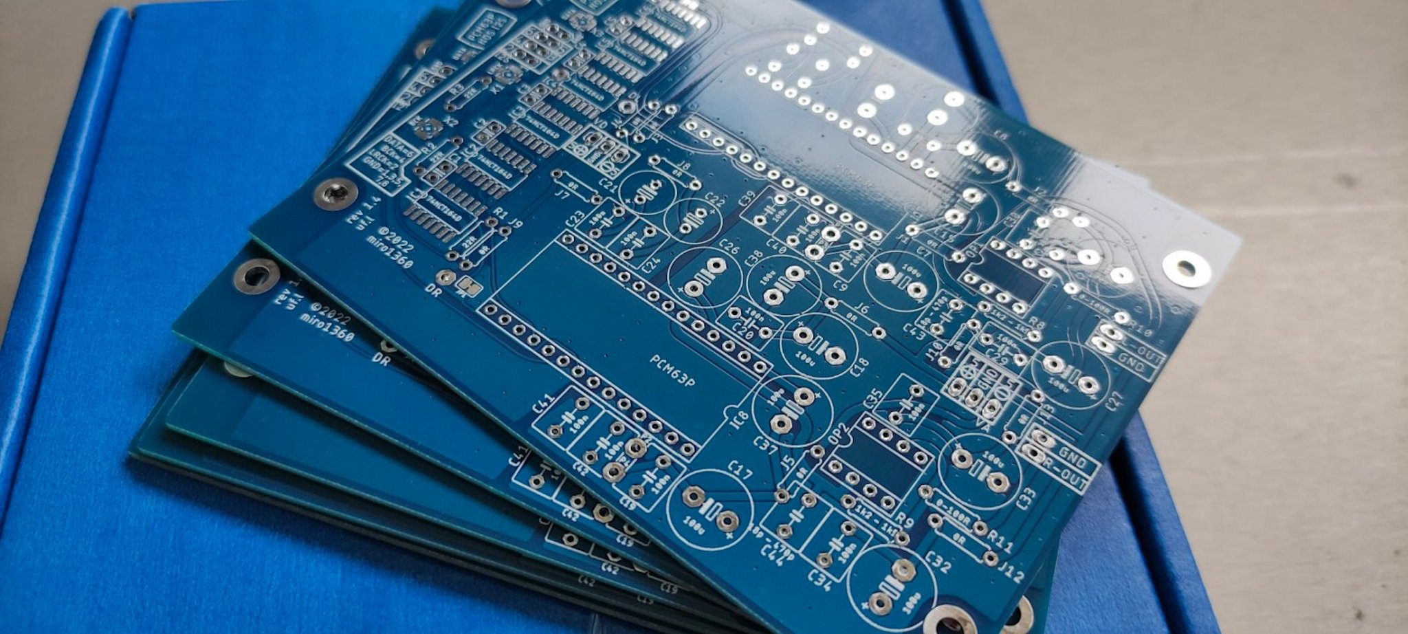

Today - is lucky day! I got new board and chips. Can't wait to assemble already! Also ordered PSU-1 for him.
Here comes the next warrior 🤩

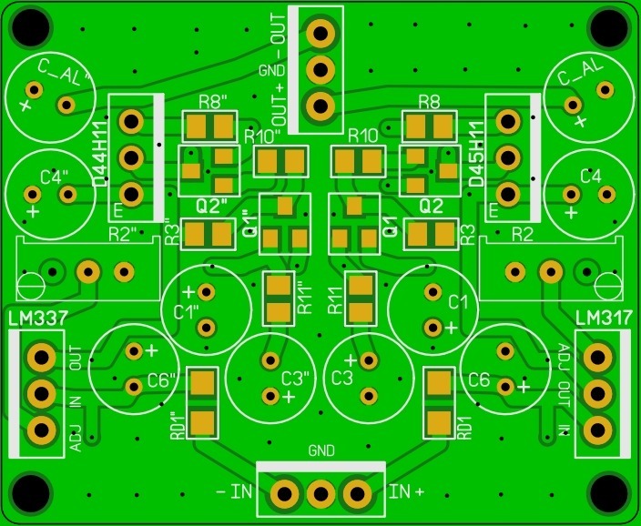

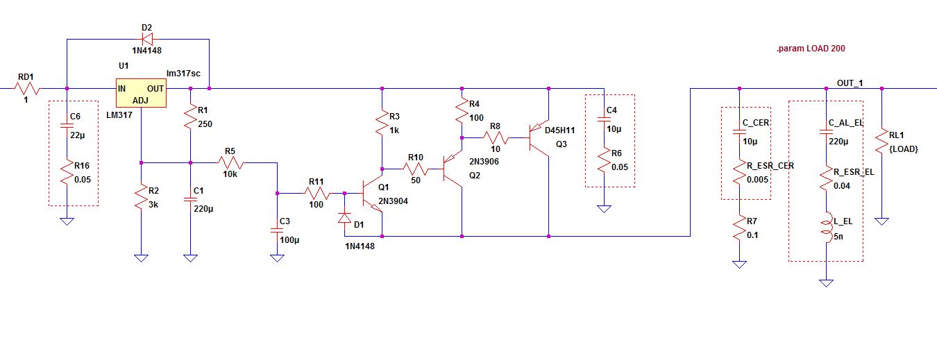

I have been (very) slowly populating the small PSUs that @Traktorist3d shared a while back. Small dual rail PCB that are about 50x35mm at a guess just now so quite small. I'm not sure of the topology even if it is a shunt or not ...I think it's more a nazar type. Haven't tested yet but should perform wellWith all the power supply discussions recently, seems like a perfect time to ask opinions about what types of psu would be favored to include onboard an AD1862 dac.

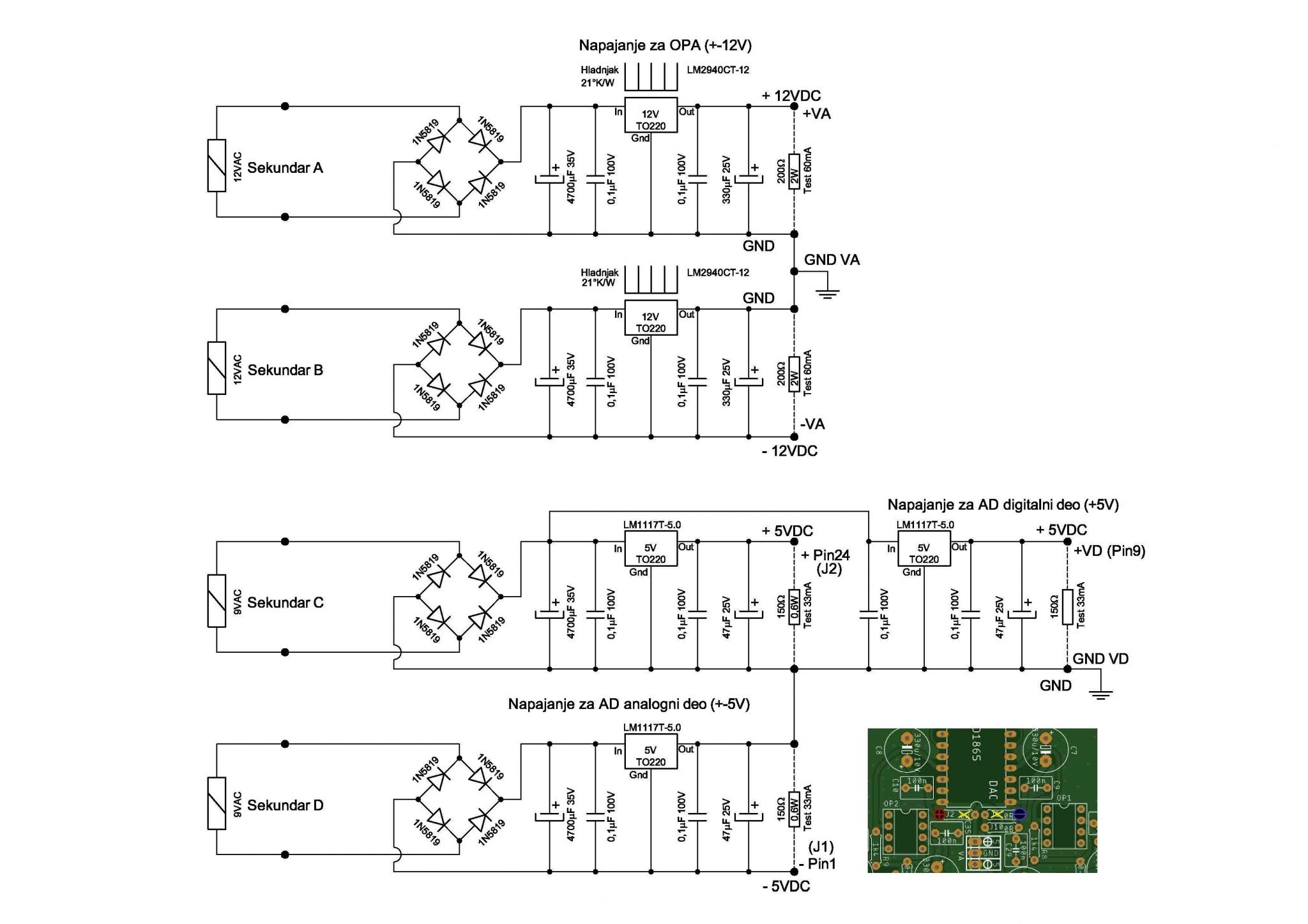

@miro1360 Can I use electrolyte for PSU on 16V? (I need 5V on this time). I could't find nichicon 4700 and 6800 but instead Panasonic FC or Epcos.
Also I planning to solder np0 smd (GRM31C5C1H104JA01L) instead Wima on Dac board (1702) and instead Kemet (6pcs). This is for sample (I can get it back always).

Yes but no one said that other last significant bits are corrupted? Just want to point out the facts based on the data.First 3 bits are "divided" into 7 parts of thermometer code - this does not touch the rest 17 bits ... anyway thermometer DACs are very good but almost impossible for more than 12-bits (very complicated) - that is where the R-2R technique can continue. AD1862 is 3 MSBs as thermometer + 17 LSBs as R-2R 🙂
So the point is that AD1865 have more precise first 3 MSBs than AD1862 that have only 3 MSBs.
And there are NO R2R components like resistors. Current sources or some other active modules emulating R inside. R, C component are complicated to implement in IC...
this is science fiction to accomplish 12Bit Binary to thermometer code
it deserves (2**12)-1=4095 taps to go to R network and analog out "resistors" and very complex circuit. 🙁
For instanse we dont have any "chip" with 4095 pins and more if we want to get out with some ladder?
That is why manufacturers chose smaller number for thermometer segment.
True R2R ladder net, with pasive resistors, we can find just in discrete dac modules 🙁

Raw DC voltage is important. For 16VDC filter capacitors, take 9VAC secondary transformers. For 5VDC at the output this is more than enough and the raw DC will not be over 14V at the first capacitor in the CRC. The AC voltage to the secondary is given for full load, if the transformer is less loaded that voltage rises above the rated. In any case, I recommend 25VAC filter capacitors for the first capacitor that is the most loaded. Check the spacing of the terminals on the capacitors to fit with the PCB.
The scheme published in post # 4,190 is wrong, the corrected scheme is attached. One transformer with two 12VAC secondary cannot be used with all positive regulators, but one transformer with 2x12VAC secondary and one with 2x9VAC secondary. With a combination of positive and negative regulators, only one transformer can be used. And LT1117T-5.0 TO220 were used instead of LP2950ACZ-05 TO92. I don't like those little ones in the TO92 case.I am interested in how much current the DAC consumes (with AD1865), primarily the digital part with shift registers (+ 5V). At the moment it is very difficult to get adjustable version of the LT1963/3015 so I have to make an alternative power supply. For + 5V. That’s until I get LT regulators. I plan LP2950ACZ-5.0, (TO92 100mA), for +5V digital part. The analog part with OPA will be + -12V with LM2940 CT-12 regulators. OPA is Sparkos SS3601. The analog part of the AD1865 will be + -5V with LP2950ACZ-5.0 regulators. The transformer has two 12VAC secondaries, 16VA.
PS
Capacitors 4700uF 25V can be used for + -5V power supply part. I do not recommend 16V capacitors.
This is a temporary solution, but it works.

Which capacitors exactly?@miro1360 Can I use electrolyte for PSU on 16V? (I need 5V on this time). I could't find nichicon 4700 and 6800 but instead Panasonic FC or Epcos.

What do you mean by "bits are corrupted"?Yes but no one said that other last significant bits are corrupted? Just want to point out the facts based on the data.
For instance TDA1540 and TDA1541 are in BJT technologies, most other are witn MOSFET or mixed thech. Contemporary models are almost all with MOSFET tech. That is also can determine the sound?
Does not matter at the end everyone can choose by the listening what to use in reproduction 🙁
Thermometer from MSBs in AD1862/AD1865 is not for a higher precision, but rather for eliminating glitch. R-2R ladder is inside the AD1862/5 for the LSBs, is not?
Hard to say if the full R2R ladder is incorporated in any advanced R2R chips, even DAC8811 has the 3 MSBs segmented and the rest is R2R 🤔
